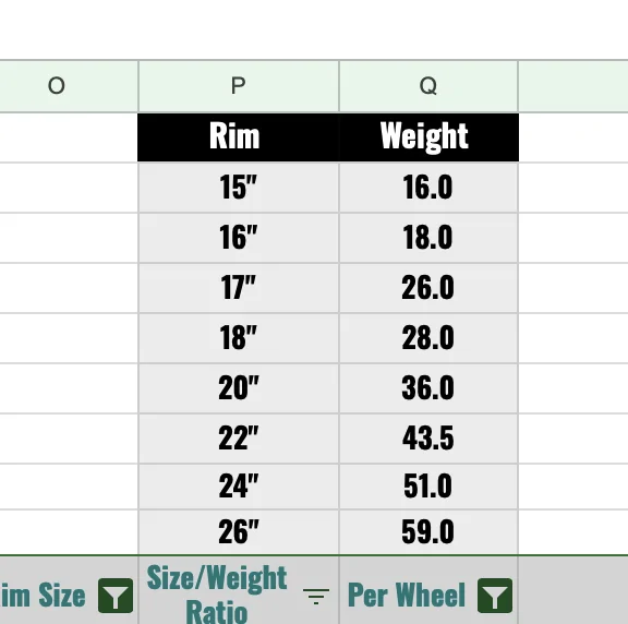

I have now added A Rim weight calculator which will automatically select the appropriate rim for the corresponding tire, then update the weight of the Entire wheel package in the final column
To use....just go ahead and enter the appropriate rim weights for your dream wheels in the top input area

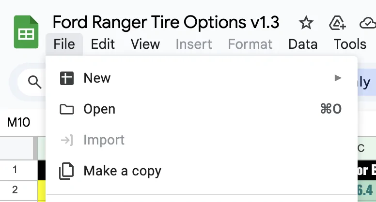

Some people were complaining about not being able to edit and sort
So I completely changed the setup and added instructions to clarify
You must now go to
File > Make a copy
before you can edit anything

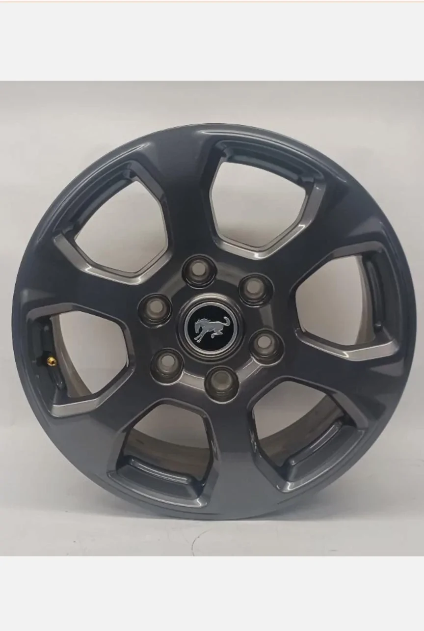

Here's another data point, I weighed 5 2024 Bronco Big Bend 6 spoke grey wheels and they are 22lbs each with valves and wheel weights installed. Perhaps this is the lightest OEM rim option?

Good to know. What is the offset on these?
If people want to gather the data on thier favourite rims...I will add it to the calculator.
For now you can just put 22lbs in the 17" Rim weight field and it will do the math for you

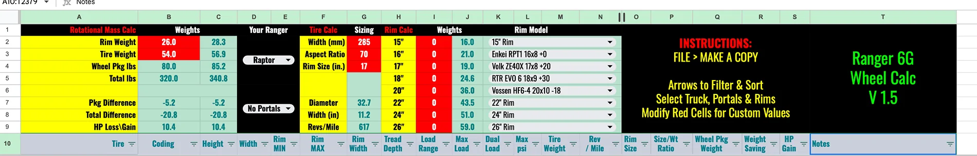

Now updated to V1.5 with portal support and a truck selector!!!
You can now compare all data to the OEM setup for each ranger trim, without or without portals. This allows you to estimate the drive train losses or gains depending on your specific setup.
There are also 3 predefined views which you can select by going to
Data -> Change view
  • All tires
  • Light 33's and up
  • Light 35's and up
  • Light 37 and up
This displays tire combos which are lighter than or the same weight as the factory ranger raptor wheel package. Currently there are only two 37" tire combos which make the cut and then only if you use 1K a pop ultralight Rays wheels!
Enjoy.
