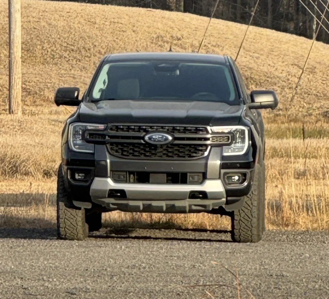

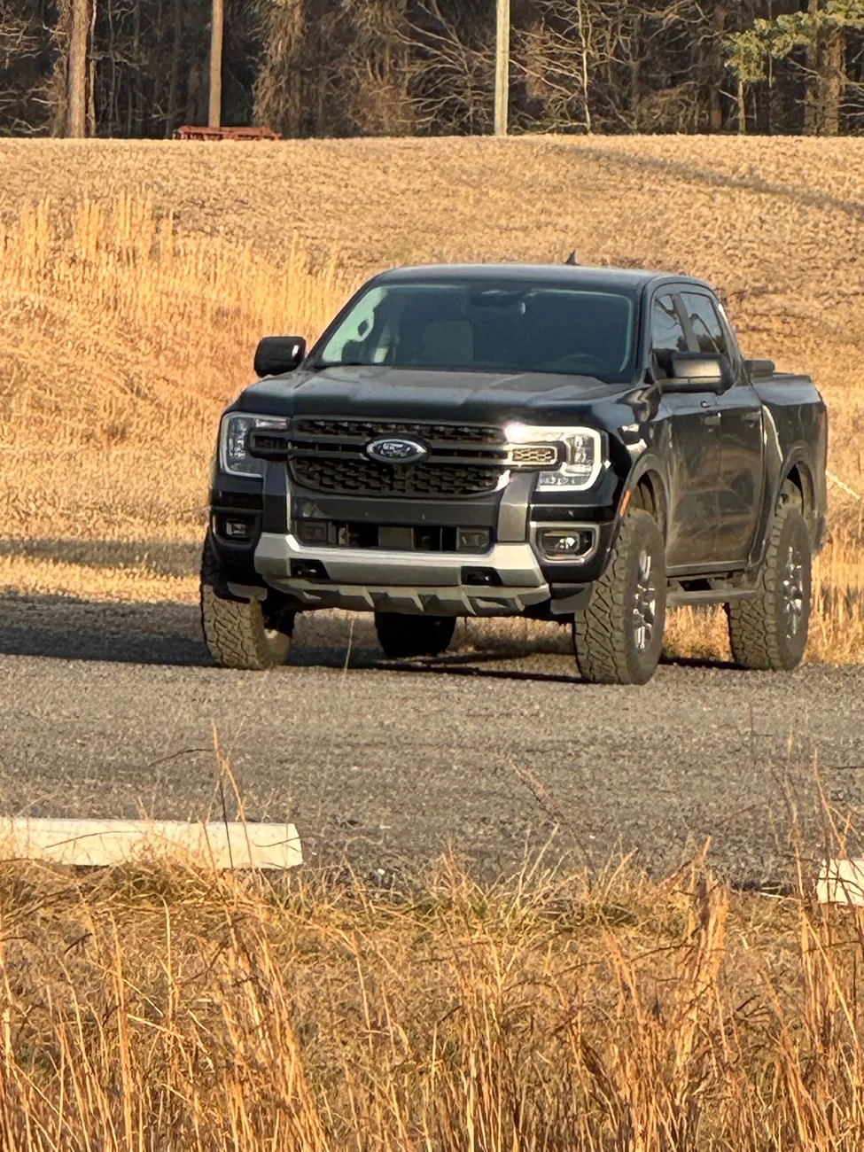

1” hub centric. Has the studs. I don’t remember the brand right off hand, I’ll have to look.
Ford Ranger Wheel spacers for 2024 Ranger XLT 4WD? IMG_4305
Ford Ranger Wheel spacers for 2024 Ranger XLT 4WD? IMG_4133
