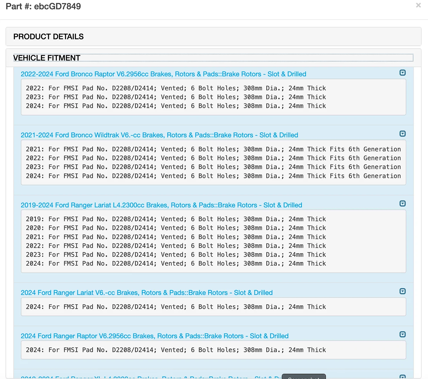

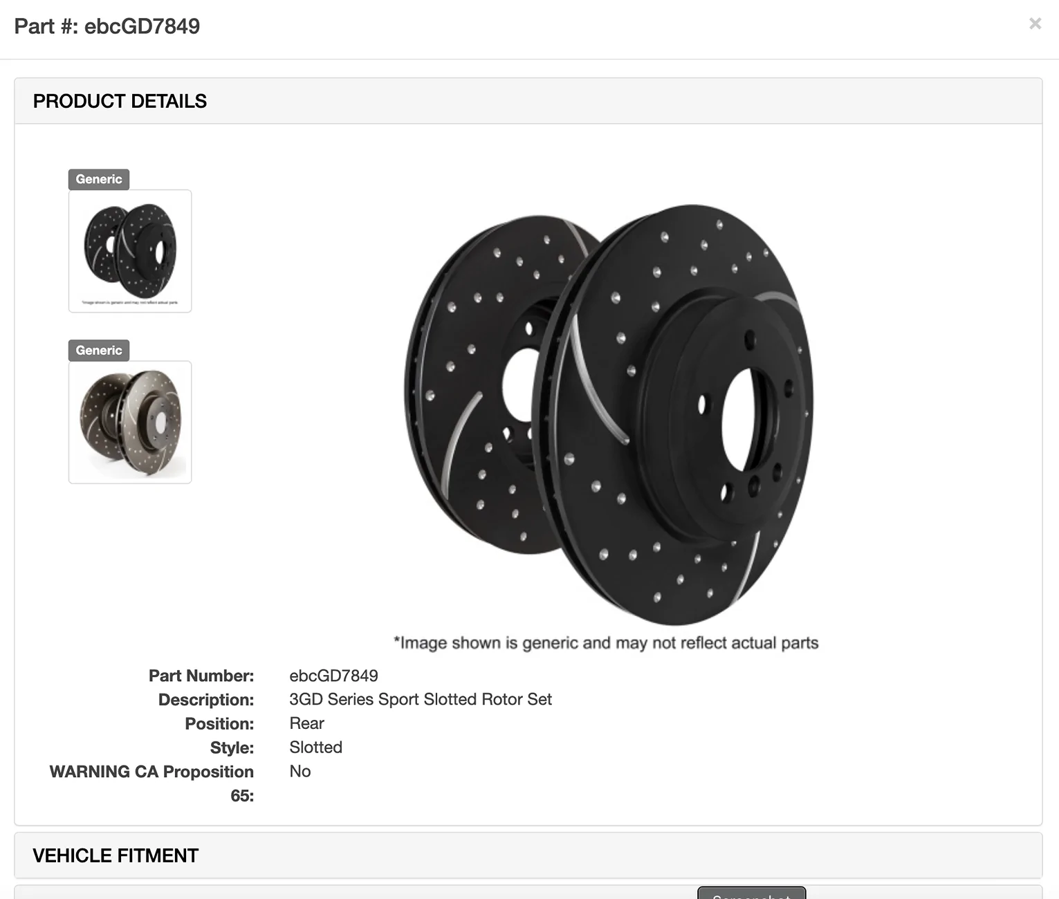

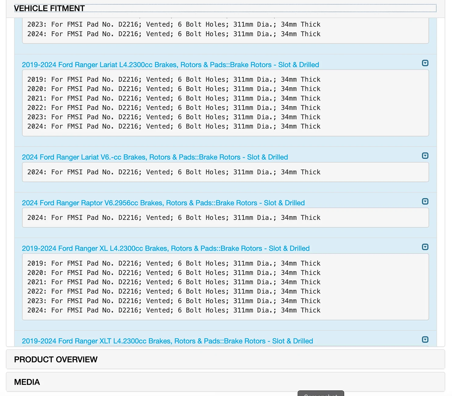

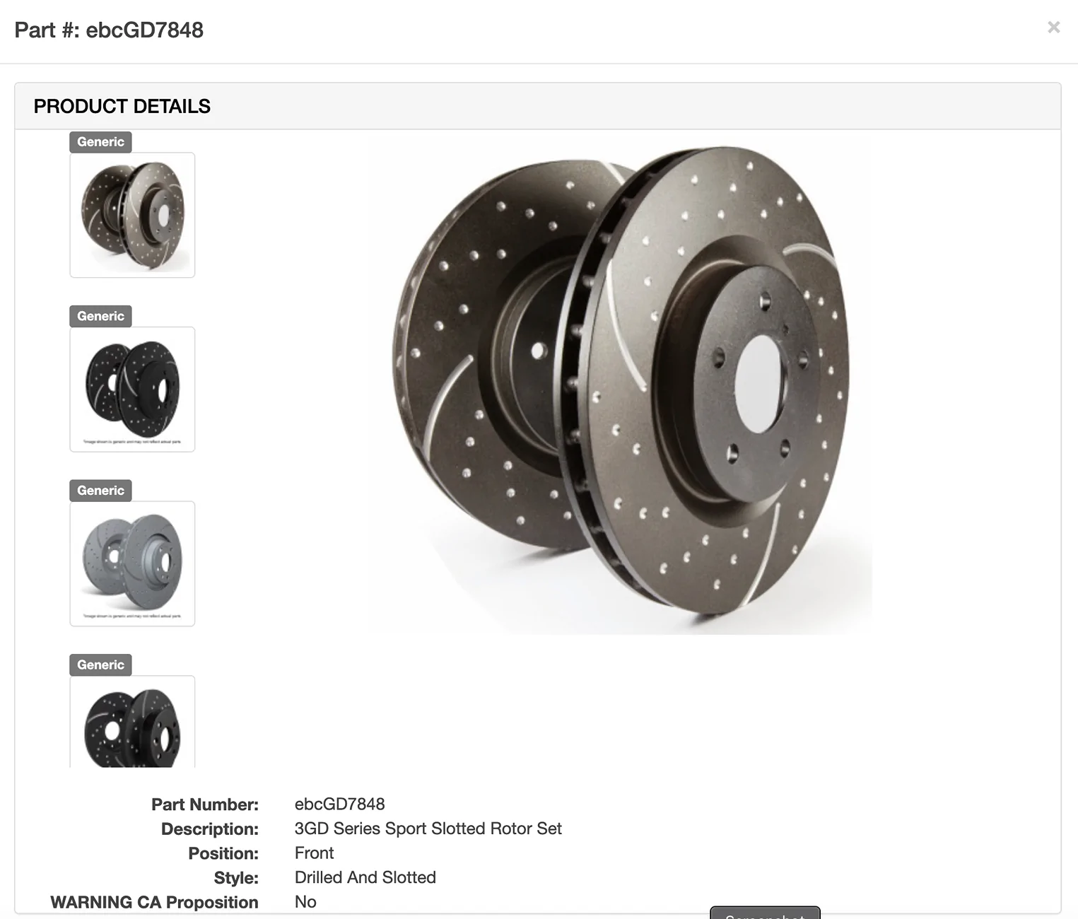

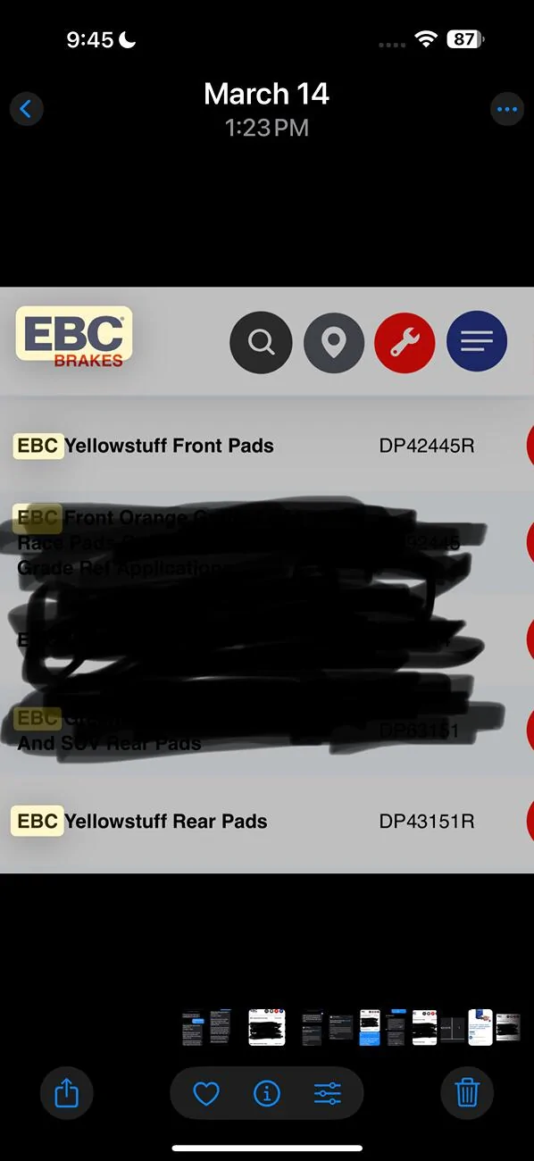

Has anyone installed EBC "EBC Extra Duty Light Truck, Jeep & SUV Brake Pads" to next gen Ranger Raptor?
Another question: is the front brake system same for petrol and diesel engines?
Just need to get little more stopping power / better pedal feel...

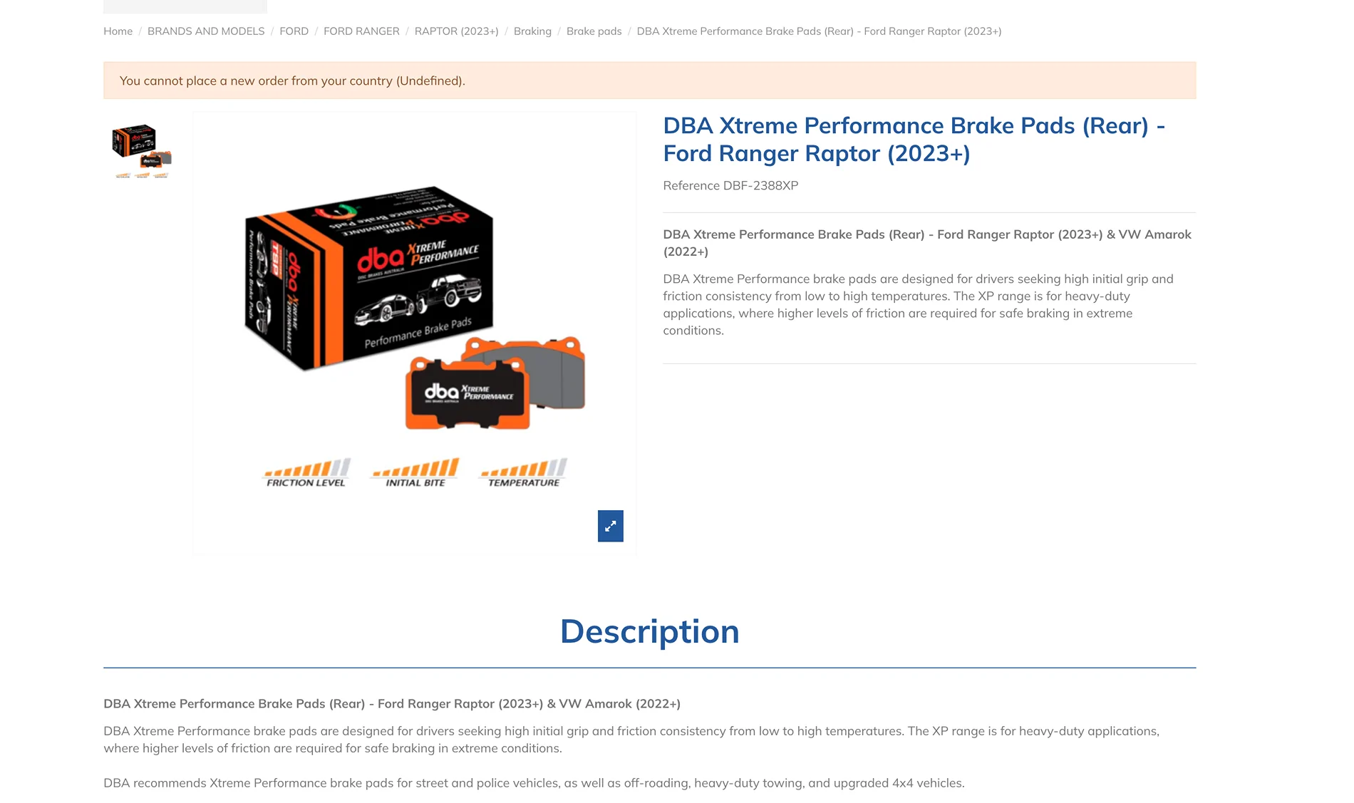

I got tired of RR brakes and ordered DBA Xtreme front brake pads.
Is it just business as usual brake pad replacement, or is there something special I should know?

Replying to myself: very simple and quick job, you just need 13mm and 10mm sockets after you remove the wheel.
Brake performance is noticeably improved with DBA Xtreme front pads. It is still not near a sports car brake system, but almost allright for me now.
