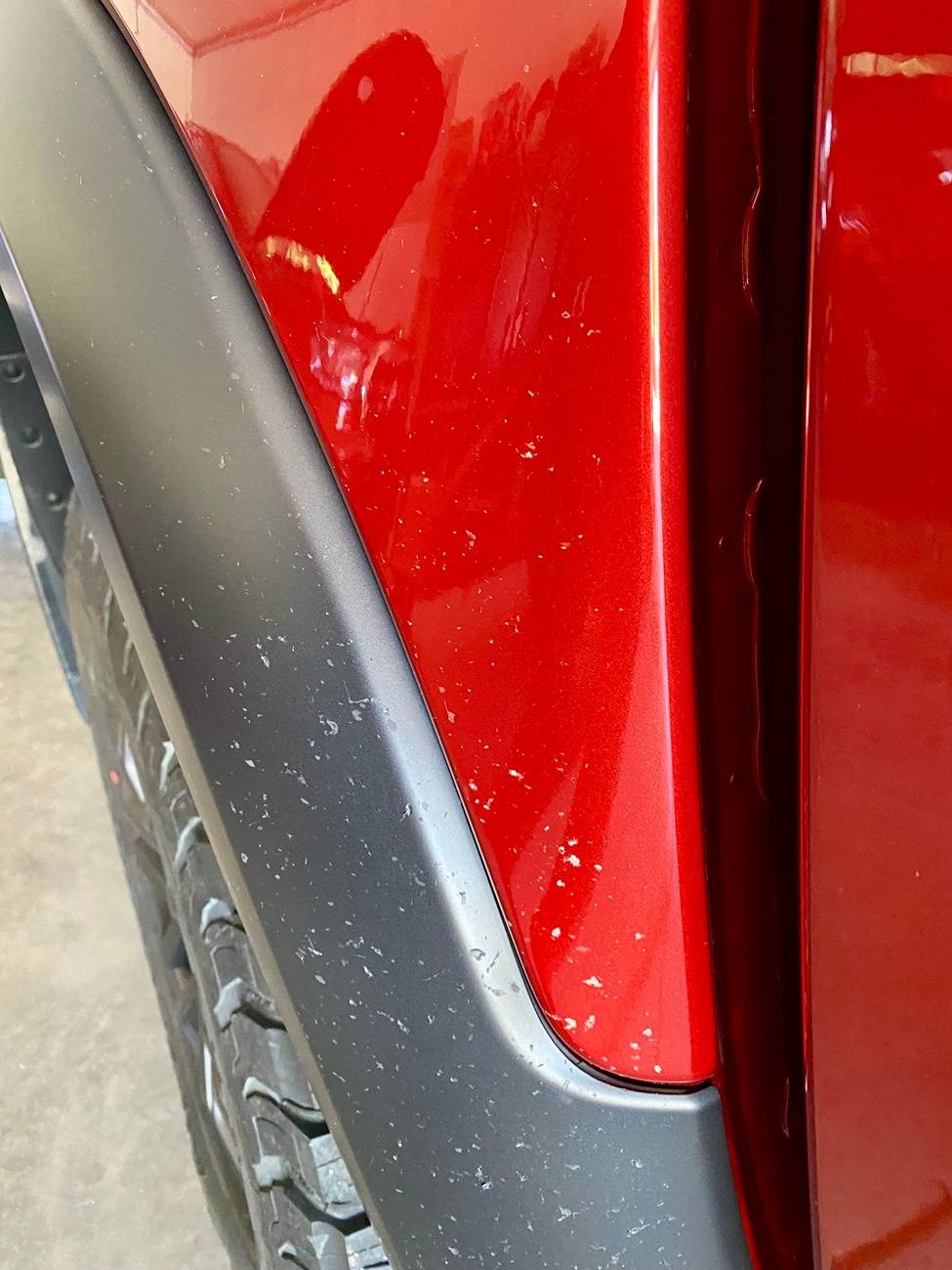

I live off a highway, 6 miles of gravel.
In the month and a half since getting my Raptor home, I've driven that 6 miles out and back not more than 5 or 6 times. Those KO2s are real rock hounds. Getting up to speed on the highway it sounds like rifle shots as the rocks spin out from the KO3s and hit the fenderwells. For those of you that plan to take your Raptor off road to imitate the Ford Ad for the Raptor - flat out across the desert/gravel/etc., I STRONGLY SUGGEST you get a clear wrap on your rear fenders, covering the area as shown in the pictures (blow those PIX up for a better perspective of the actual damage).
I didn't notice until washing the truck the amount of damage the rocks kicked up caused. I've got less than 2,000 miles on the truck and most certainly if I do nothing, in a year there will be no paint left in those areas. You'll need to go up from the bottom about a foot for full protection. It's actually worst looking than the pictures indicate. I've got factory mud flaps, but took off the side steps and replaced them with electric retractables, which of course are retracted when on the road.

I'm one of those guys who removed the useless running boards. They seem to serve a purpose that Ford didn't bother to mention to us. I agree. They are running boards. Not stone deflectors. That being said I probably would have left them on knowing the about the paint chips. Needs better mud flaps.

Oh man that sucks about the chips in the paint. I'm usually not into running boards or mud flaps on a pickup truck. However I have both on my Ranger Raptor and think they look great! And oblivious from this post do serve a purpose!!!

Removing your side steps is most of your problem. I also have a gravel driveway and can hear the rocks coming out of the treads, but so far o damage to fenders or doors.

Thanks to this post though i was in the middle of getting partial pof and ceramic and had them add ppf to this rear fender area just incase after reading this ?

I was afraid of that, I had the same guys that did my clear wrap on the back fenders and hood etc., also remove my side steps. I left my steps on just for protection till I could get those back fenders covered with PPF.

I left my running boards on my ranger for this very reason
