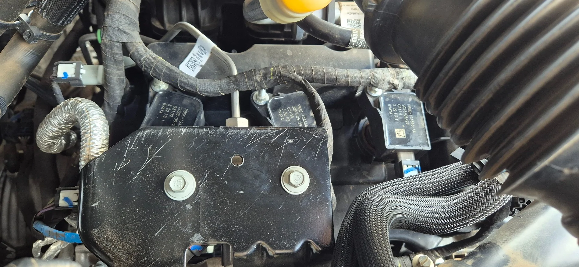

I just went out to the garage and made a little progress. I removed this foam cover
Ford Ranger Ranger Raptor Spark Plug Change Help 1760213414989-g0

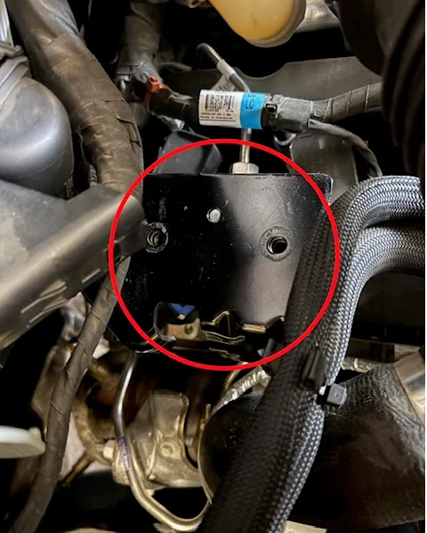

Now I can see the plugs on the passenger side however this plate is in the way. I removed the top 2 bolts thinking I could remove the plate but there's still something holding it.
Ford Ranger Ranger Raptor Spark Plug Change Help 1760213476497-i9
At a standstill again..

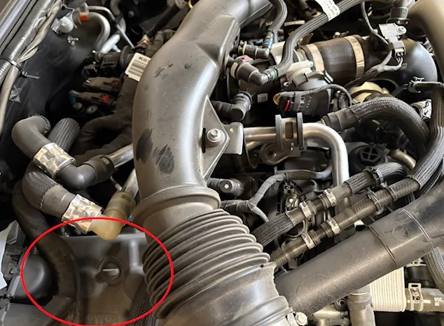

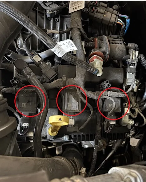

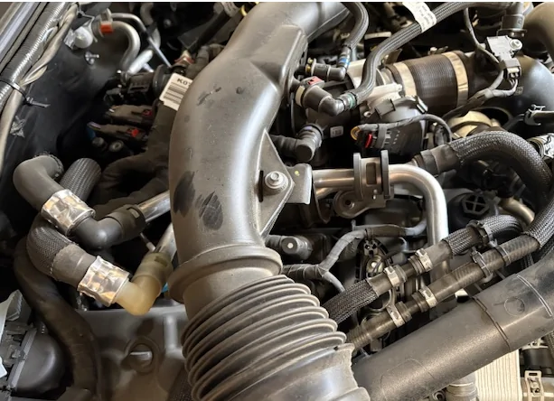

I just changed all 6 of my spark plugs after the usual P0306 at about 15k miles. Quite accessible without too much disassembly (mine is a right hand drive though), I never had to remove the thick plate covering the HP fuel pump, nor the upper air piping as the manual suggests, a long extension and good swivel adapter helped get the coil-on-plug unit bolts out.
Ford Ranger Ranger Raptor Spark Plug Change Help 1 2 3 coil on plug assemblies
