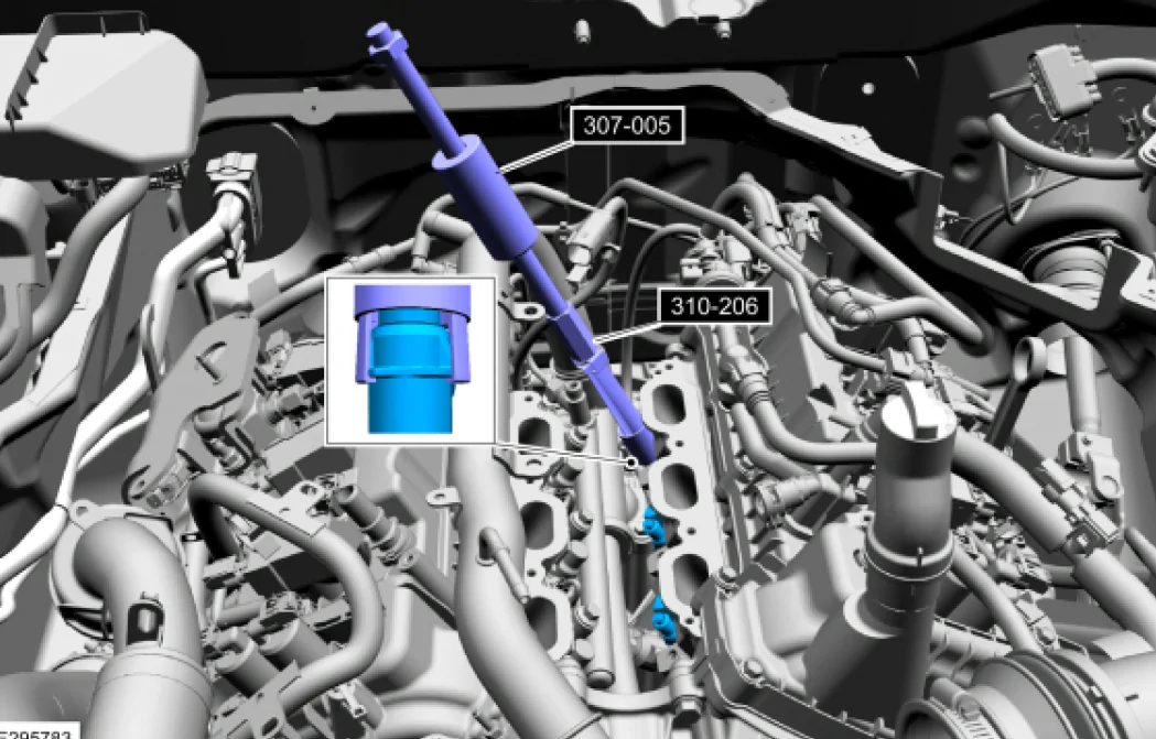

My 2025 Ford workshop manual only mentions port injection and direct injection for the 2.3L and 2.7L.
The 3.0L only mentions direct injection. Note the image below. This section is part of 303-04C which references the direct injection fuel rail. There is no port injection fuel rail.
Well shit!
