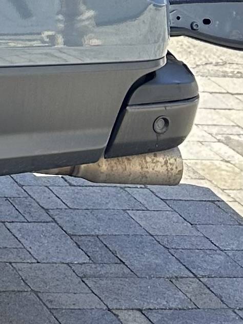

I’m sure many are aware but I figured it would be worth a post for those who havent cleaned exhaust pipes before like myself prior to doing this.
I used chemical guys heavy metal polish, ultra fine scotch bright pad, and microfiber cloth.
Really is about a 10min job total. Super easy if your exhaust tips were starting to look like mine aka rusty pitted dirty carbon caked.
Before:

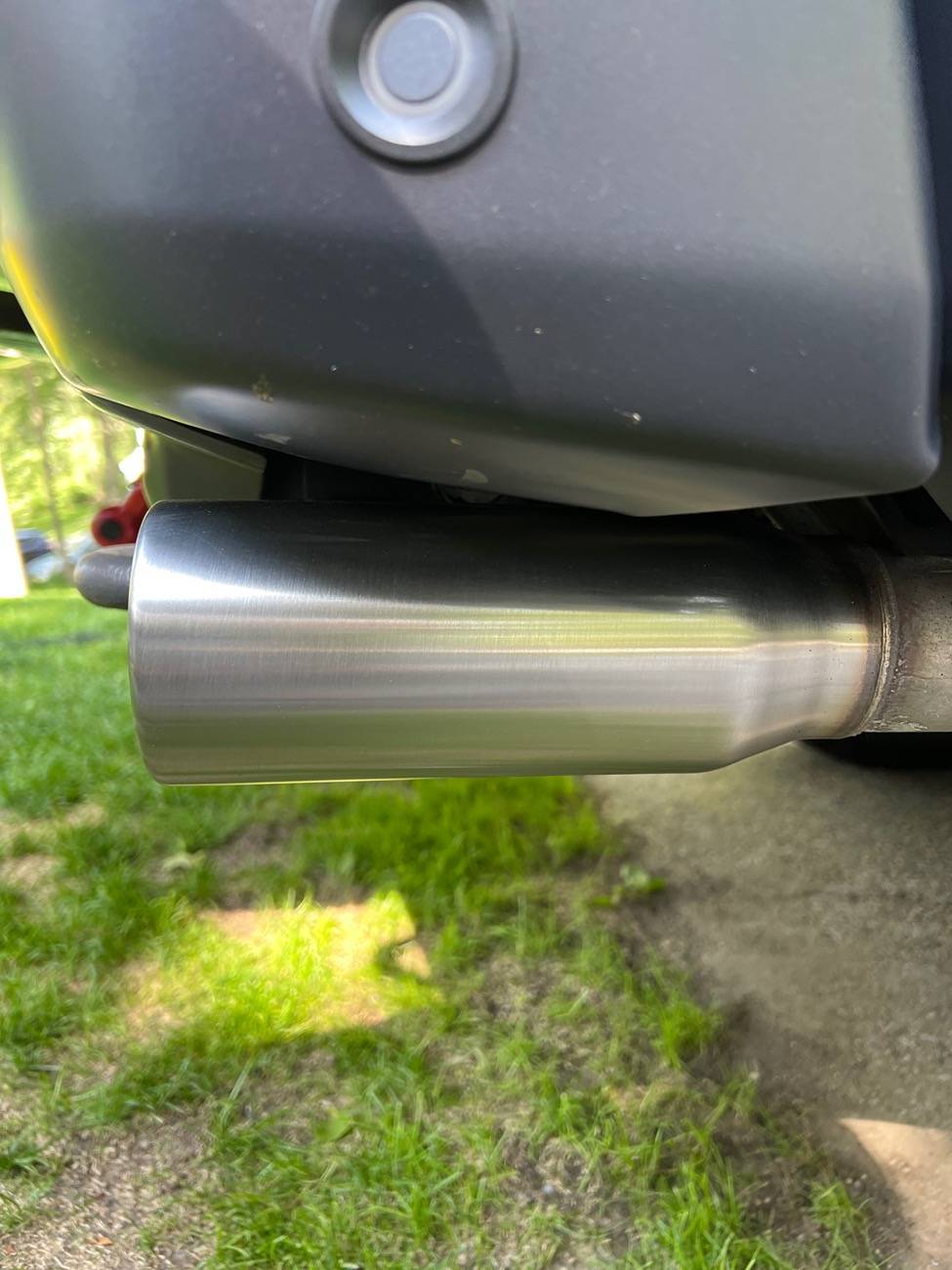

after:
Ford Ranger RR Exhaust Cleaning Tip IMG_4526

I was pretty blown away at how quickly it worked. Mine were looking terrible before.

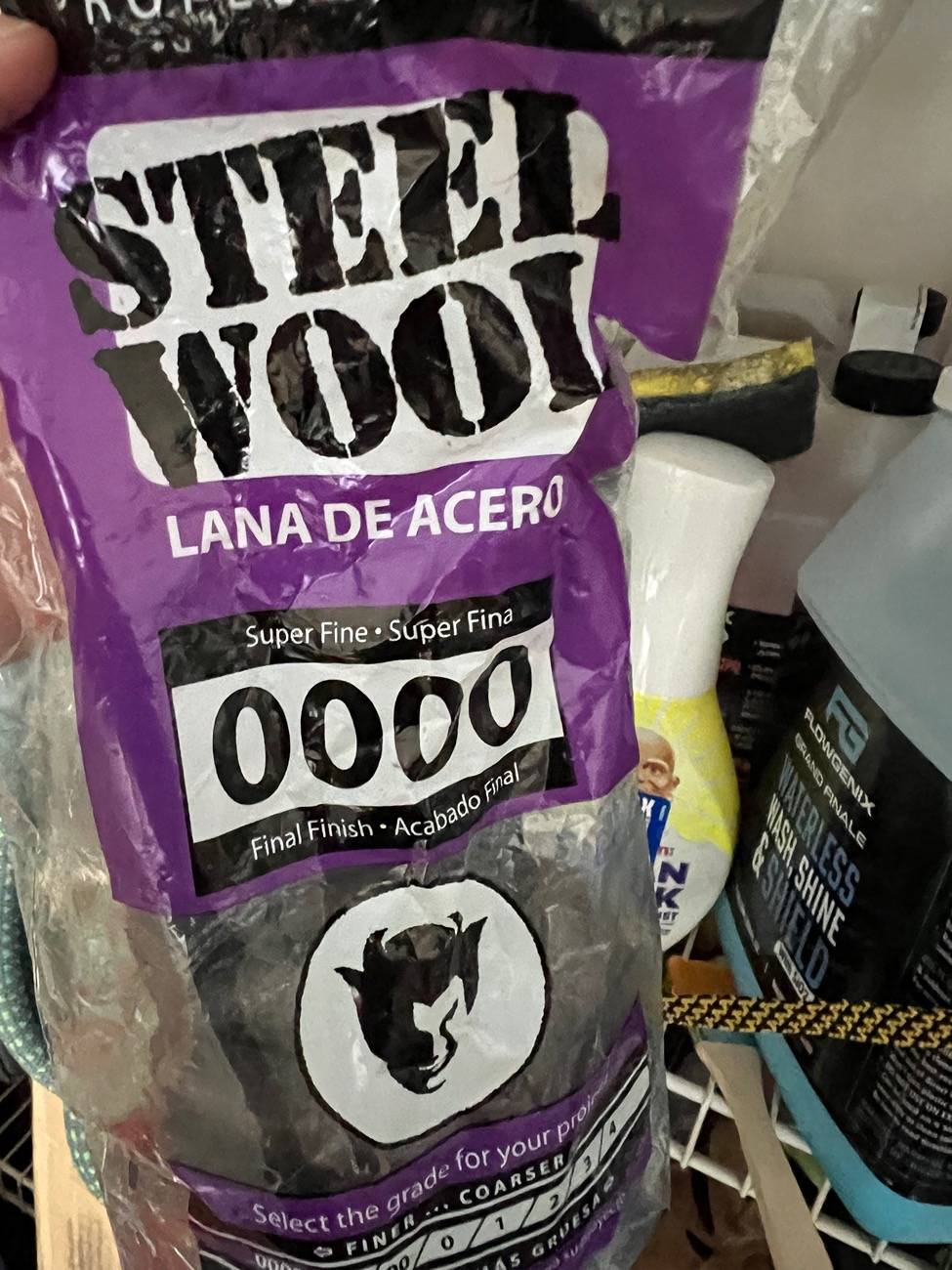

glass cleaner and ultra fine steel wool works great for that stuff

ive done some NASTY exhaust tips with the steel wool and it works so well.

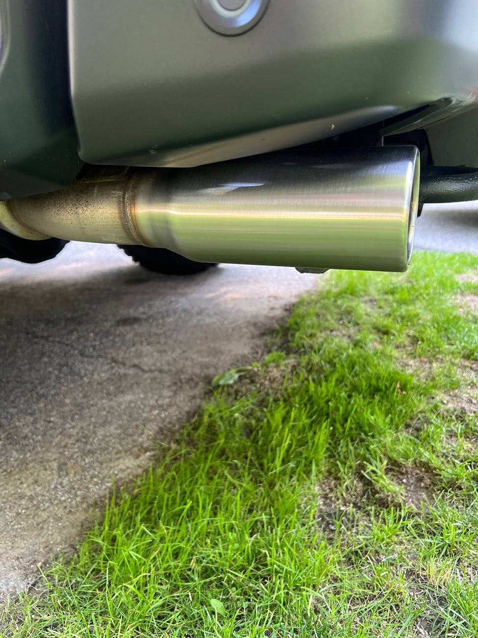

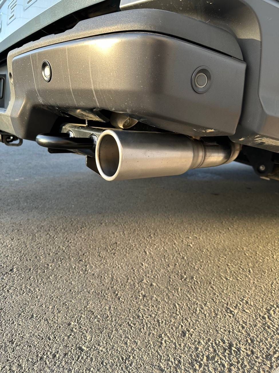

I use steel wool & Scotch-bright pads and finish with microfiber cloth to give it a polish. I have attached the metal polish I got off Amazon for $19.99 enough to last a lifetime. See photos below - sorry I didn’t do the before but I had to remover the over spray of the undercoating. So it was more than just dirt and mud. Took 10 minutes for both sides.
