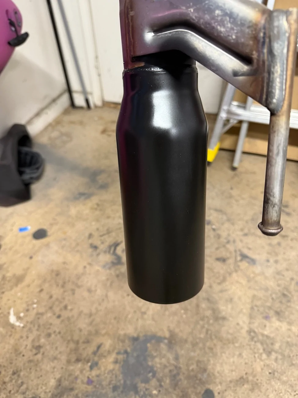

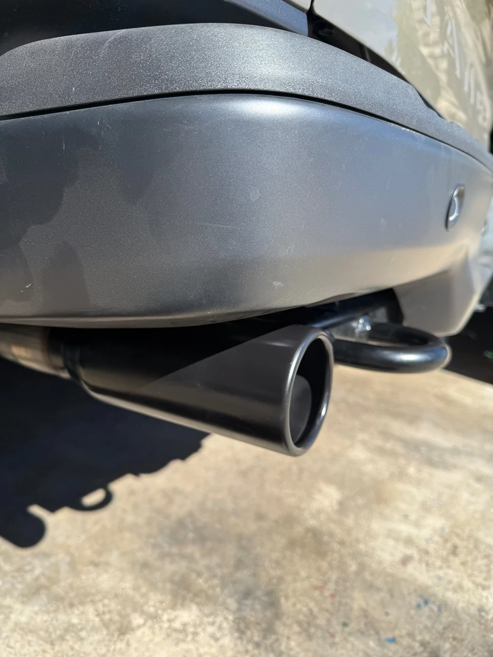

I used 3 coats of VHT engine flat black and 3 coats of VHT satin clear, previously recommended with great results. Your option, tape everything off or loosen the 1st clamp and remove from the truck. Just follow the instructions on the can.
Same here!
Ford Ranger Best aerosol paint for RR exhaust tips only? IMG_0216
Ford Ranger Best aerosol paint for RR exhaust tips only? IMG_0217
