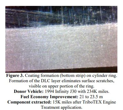

4. I personally use DLC coatings at 30k intervals on my turbo engines and 40k intervals on the 3 since it's NA. It enhances compression and oil control through the rings - cylinder wall interface once formed, especially on older higher mileage engines it reduces oil consumption, thus it WILL aid in minimizing carbon buildup on the intake valves as I believe that Oil is the main source of the carbon deposits, not the gasoline. We all know what oil coking does to bearings and oil galleys....you want as good of a ring seal as possible and that is one advance of DLC coatings: Informational - Science / History Behind In Situ Hydrogenated DLC Coatings for ICE and Trans Applications | Ranger6G - 2024+ Ranger & Raptor Forum, News, Owners, Community (6th Gen)

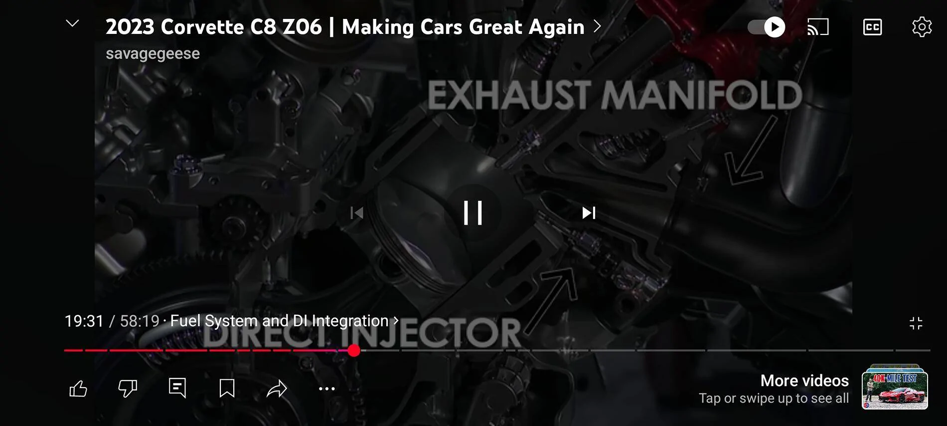

I was watching a video about the ZO6 Corvette and came across this quote that I thought was pertinent to our discussion here, "Another consideration is carbon buildup from DI systems and according to the engineers, this is less of a problem assuming you are driving this car at its limits and not just cold starting the car every once in a while in the garage."
(SavageGeese on YouTube - 2023 Corvette C8 ZO6 / Making Cars Great Again)
Granted, most of us are probably not driving our Ranger Raptors like a ZO6 on a track day, staying up at the top of the rev range for prolonged periods, but I think the point transfers: get on it regularly, enjoy the power that it has to offer and you'll be doing the engine a favor. That's the way I'm going to explain it to my girlfriend anyway. "Spirited driving" if not downright Hooniganism for us Ken Block fans.
Below is a screen shot of the time in the video where the quote above is plucked.
