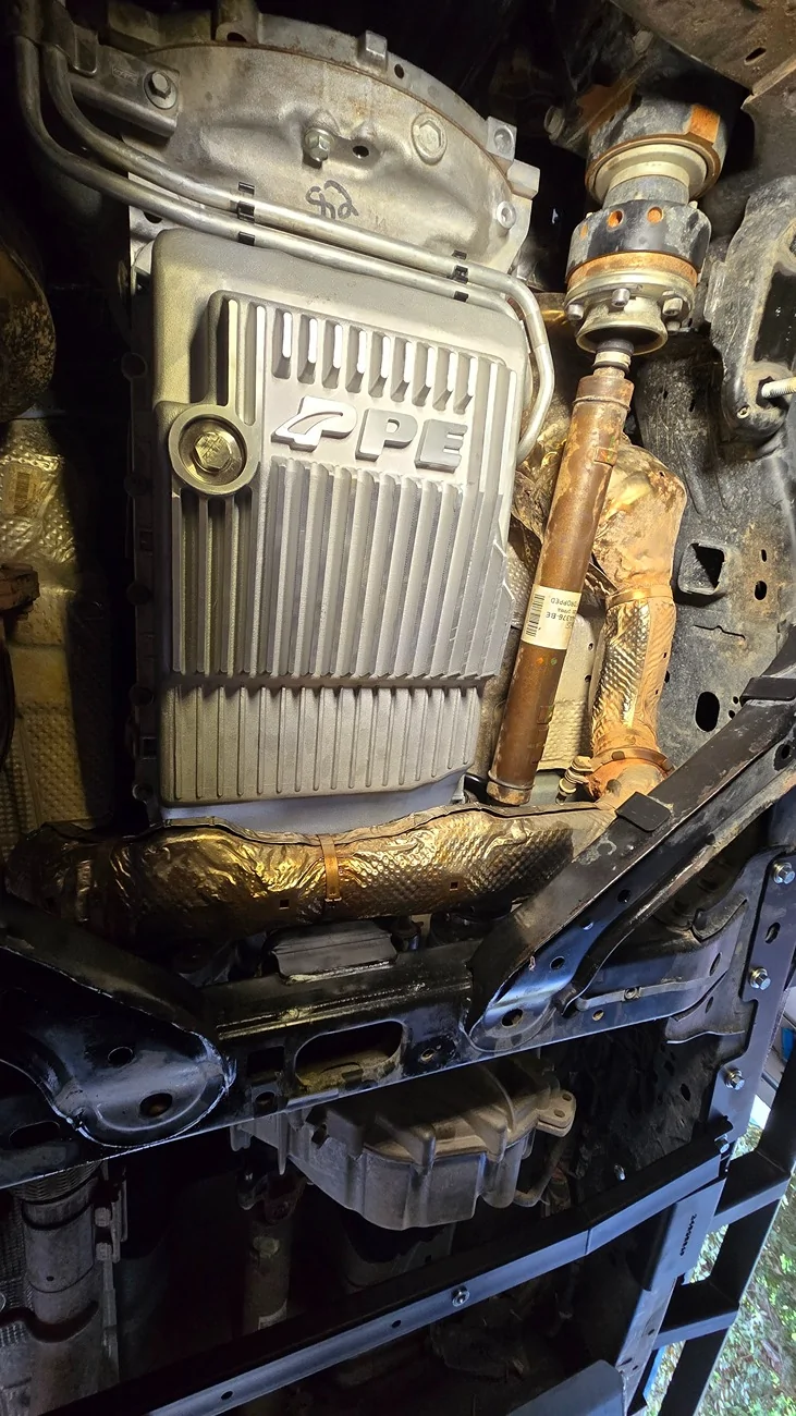

Just wanted to follow up. I did the transmission service today. Did a short drive to get o the hoist so things would not be so hot. You have good access to all but a couple pan bolts. With a 19mm box wrench you can easily reach over the exhaust and drive shaft with room to move the fill plug (dip stick). When things are really hot, a spinner wrench would be better to get most of the way off, but when cold you should be able to just use your fingers to remove it. You are only working around the driveshaft when reaching up so not as bad as the F150 looks.
Here are some pictures of the pan. Front looking back

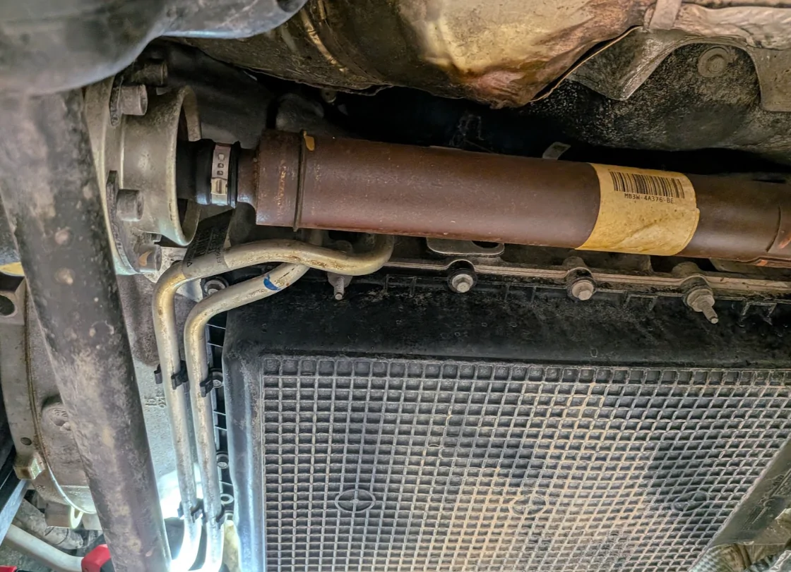

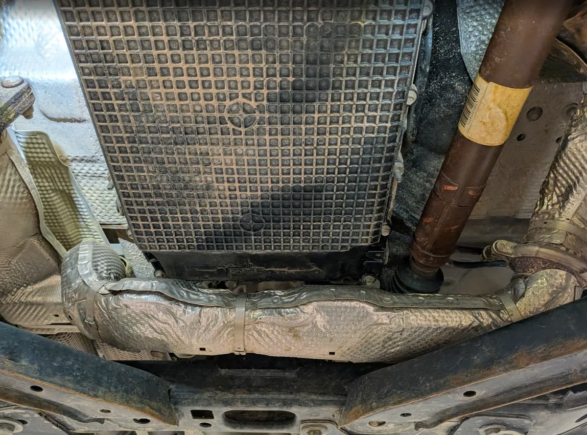

Drivers side looking towards passenger. Note that blue mark on the fluid cooler line. That is the outgoing (Hot) line and a great place to get an accurate trans temp. When up to operating temp, it will read 10 to 15 above what you see on the dash gauge, so the trans is running at 205 when it shows 190 on the dash gauge. Also, the driver’s front corner bolt was the only one I could not get a socket on. I had to use a wrench. When it is free, it will not fall out without moving the trans line a bit. I did remove the trans cooler hanger bracket bolt (10mm). With a small screwdriver you can wedge the lines across the front enough forward to get a socket on them. I used 1/4 drive to have the smallest sockets. Small bolts (most) are 8mm, the larger are 13mm. There are 6 of these larger but they are the same dia stud as the smaller 8mm.

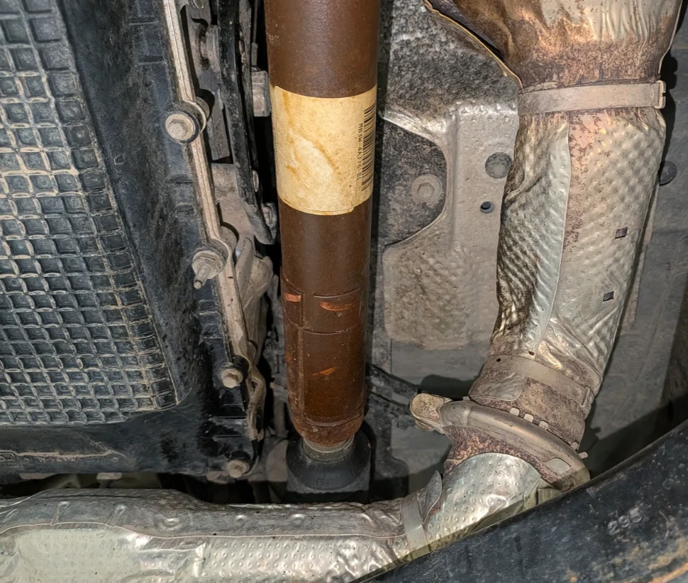

This is the drivers side looking back. There is enough room to get a socket straight up to the back 2 center boilts (big ones) but the outside corners require a offset joint

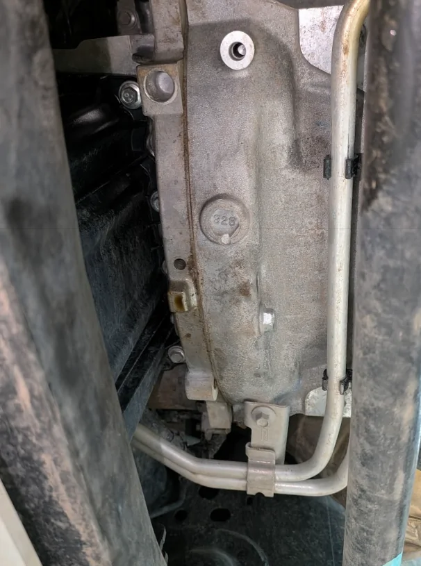

Here is the passenger side. Wide open on this side. Unlike the F150 which as heat shield on the pan bolts, there is none on this trans. You do have 2 push pins holding the upper heat shield on the passenger side and 2 on the driver’s side.
Here is that hanger bracket (10mm) that I took the bolt out to let the lines move a little more. I think it helps.

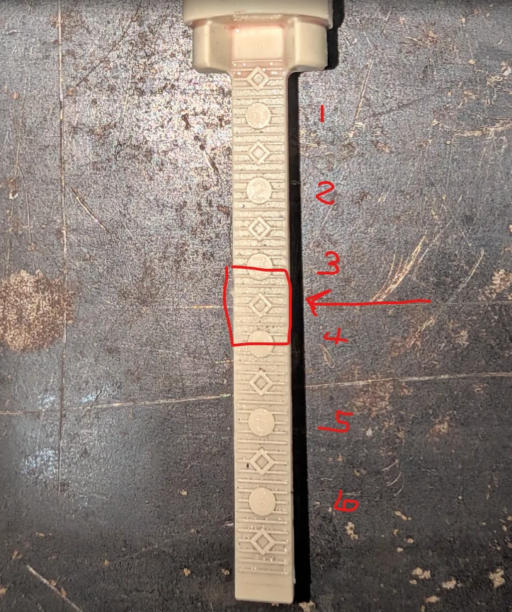

Here is a close up of the dipstick (its under the fillplug). For ouf trans, we want the fluid when at operating temp (205 degrees) to be between 4 and 3. The cooler the fuild the closer to 4. The numbers are on the circles.
