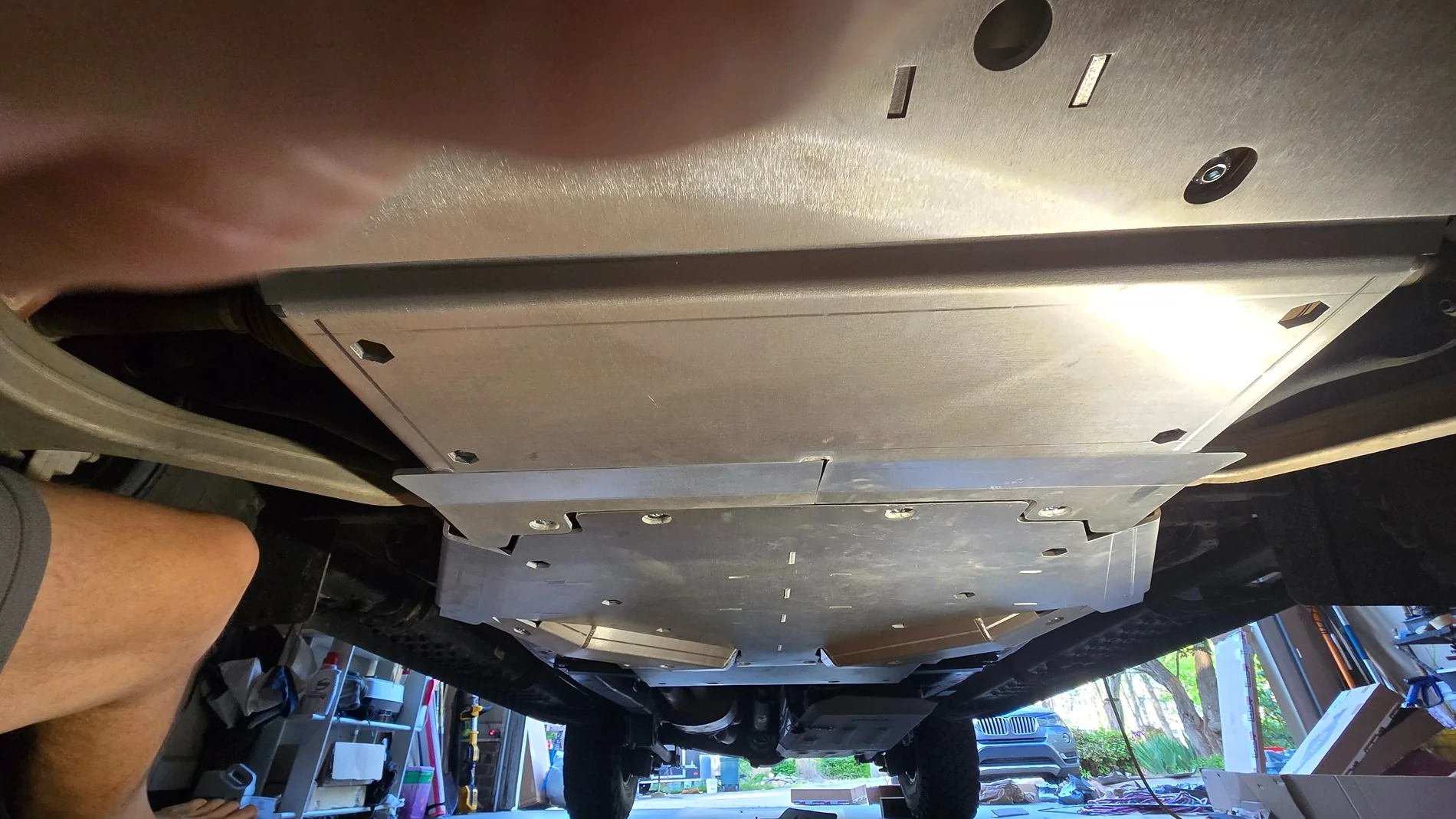

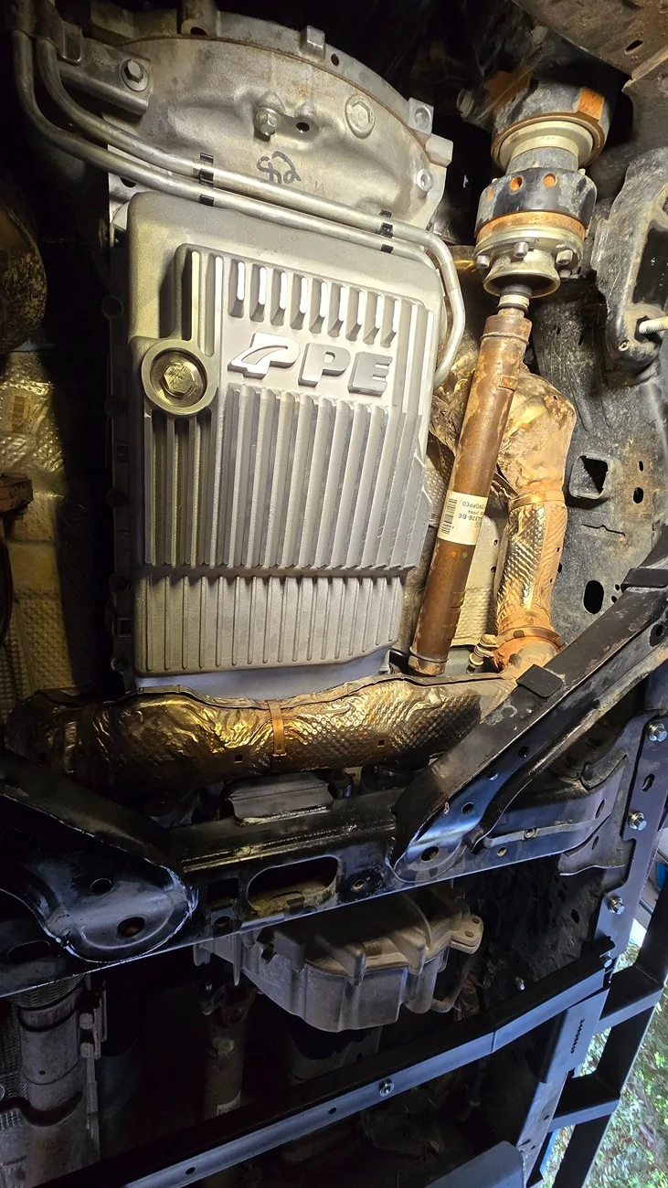

Anyone know if an aluminum high capacity transmission pan fits under aftermarket skid plate?
Looking to add something with a drain plug, additional capacity for trans fluid always a good thing.

Outstanding. Thanks for the confirmation and photos!
Yes, I have full skids and deep trans pan. Plenty of room.
