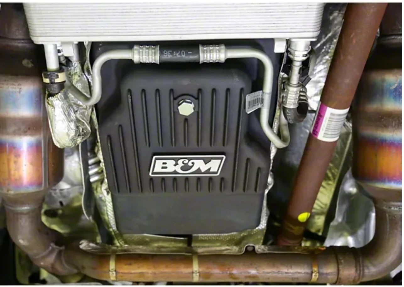

I purchased a B&M 10R80/10R60 Hi-TEK Deep Heavy Duty Transmission Pan from American Truck. It's a deep pan that adds 2 quarts of capacity. Compared to other pans this pan was less expensive at $279.
How much of a pain was it to swap that?
I have a 2025 Ranger Lariat with 2.7l EB. For me it was an easy swap (~2 hours). There is literally nothing in the way. I've done a few of this in the past. Two 5G 4Runners, Chevy Suburban and a Ford Expedition. I refilled with Amsoil ULV trans fluid. A few folks on the forum said that they purchased an aftermarket trans pan and took it to the dealer to be installed - I think they said the dealer charged ~$200.

Nice! I think the raptor might have an exhaust pipe in the way which generally boils down to a mess with the fluid unless you pump it out through the fill port. I'd probably take it to the dealer just to prevent the mess in my garage!
