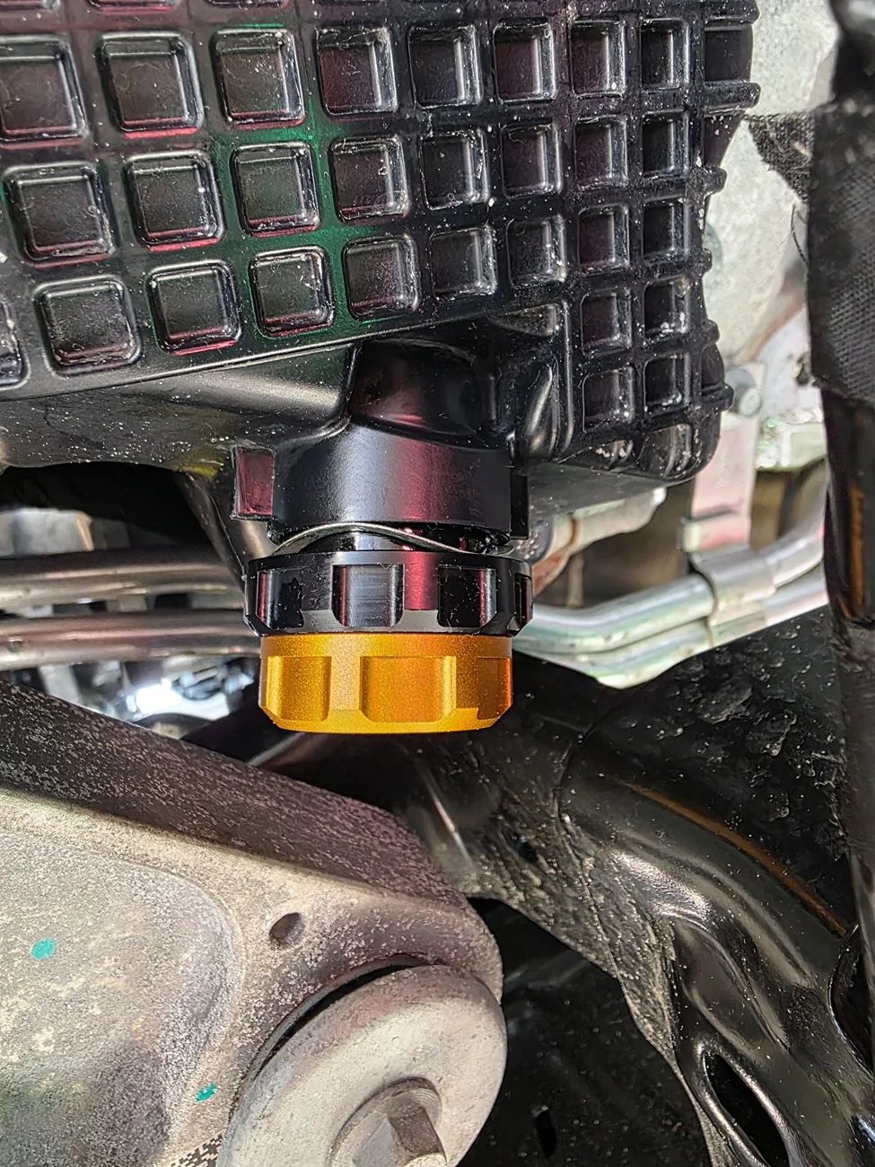

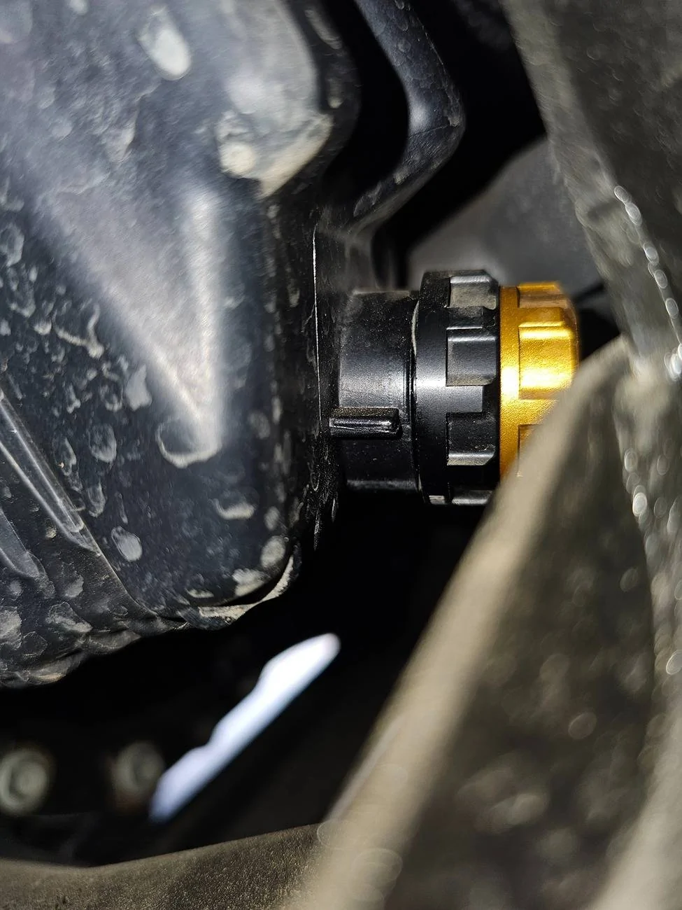

Not to revive an old thread but I just installed mine and this feels weird. Has anyone had any problems up to now?
32k miles here and no issues. Love how clean my oil changes are.
It looks that way because the OEM plug is a push and turn to lock in place. The aftermarket has to use the same method to lock in place, So the gap is there to allow you to push in and turn to install/remove. The wavy washer pushes the plug out so it doesn't work its way loose. It's just as secure as OEM if not better.
3,539
3,285
yeah, it adds tension to the threads so it doesn't come loose on its own. you are good
