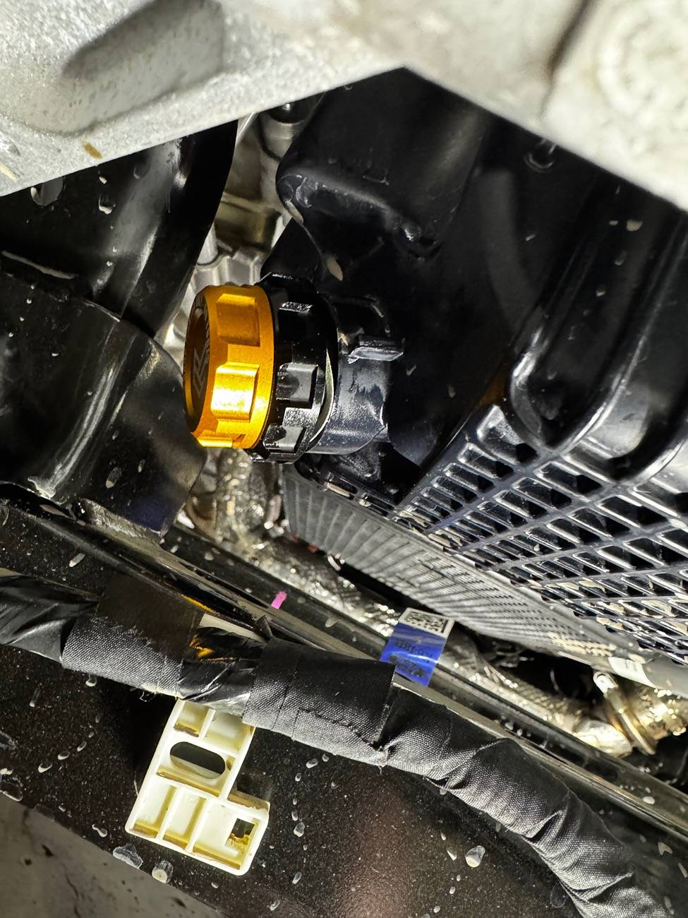

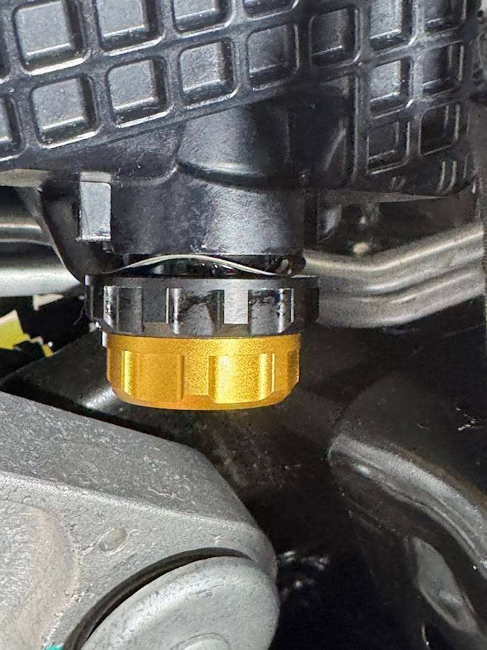

I just did my first oil change today at 1250 miles and installed the Ronin drain plug which is also their updated version. I installed it per the instructions with the notch at about 7 o'clock, pushed in and turned until it clicked and popped back out a small amount. The concern I have is that the wave washer doesn't compress fully and the Ronin doesn't sit flush to the oil pain hole like seen in the installation videos which I think were done on an F150. I'm curious if anyone else has installed this on their RR and see a similar fitment. It doesn't leak and I can't turn it any further to tighten it and it won't loosen without pushing in and turning to the left. Also the gold cap when installed shows the logo as expected. I tested the drain function with the residual oil in the pan to make sure it all worked before I closed everything up and added the new oil (Pennzoil Ultra Platinum 5W-30). The videos I have found for RRs doesn't show the angle I'm putting in the photo below to see the small gap. I'm going to look for some Bronco Raptor videos as well but just seems a bit odd that it doesn't sit flush. Any inputs are appreciated and hopefully someone can post a picture of their Ronin installed and compare the fitment/gap.

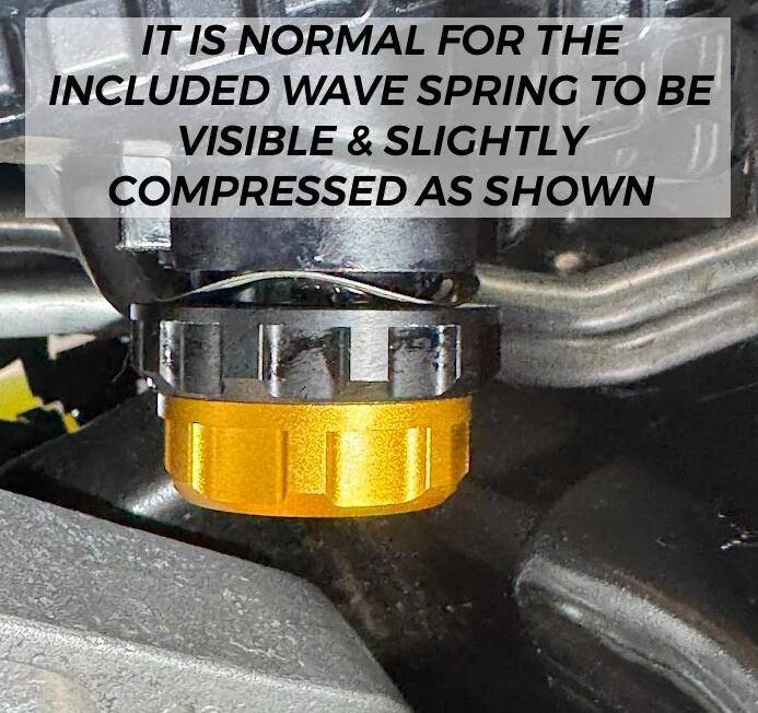

I wouldn't be worried about the gap, Ronin's webpage shows the same amount.
Ford Ranger Ronin Oil Drain Plug installed on '25 Ranger Raptor (Fitment Concerns) Ronin normal

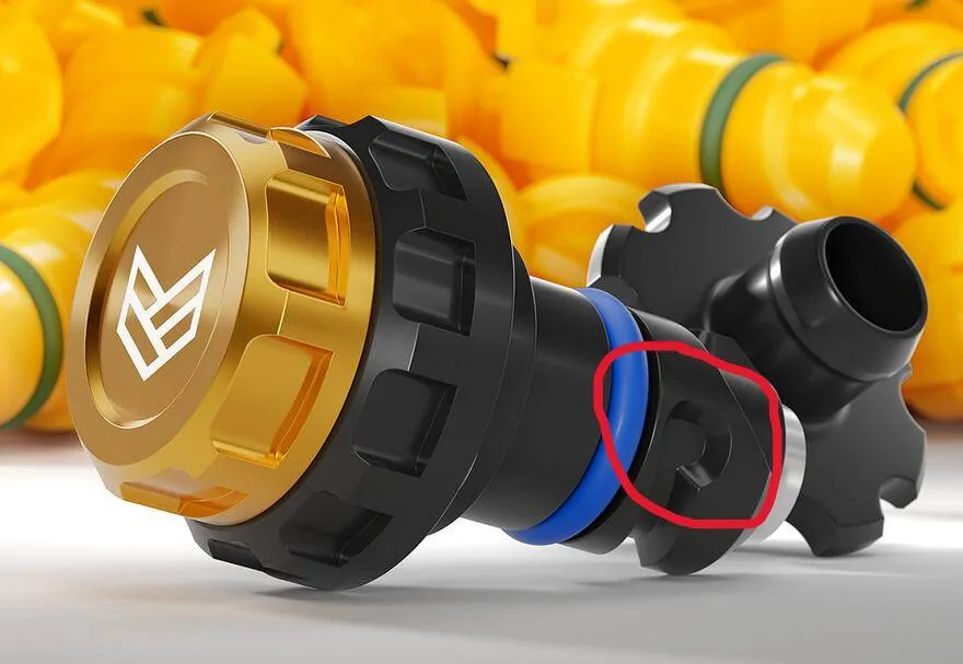

The purpose of the wavy washer is to keep tension on the insert to keep it from rotating off the 2 nubs in the pan. The Ronin insert, just like the factory plug, has to be pressed in and turned to be removed.
Ford Ranger Ronin Oil Drain Plug installed on '25 Ranger Raptor (Fitment Concerns) Ronin plug marku
As long as there is tension it won't back out. If anything, I'd prefer a larger gap as it shows the insert is being pushed back out and locked in place.

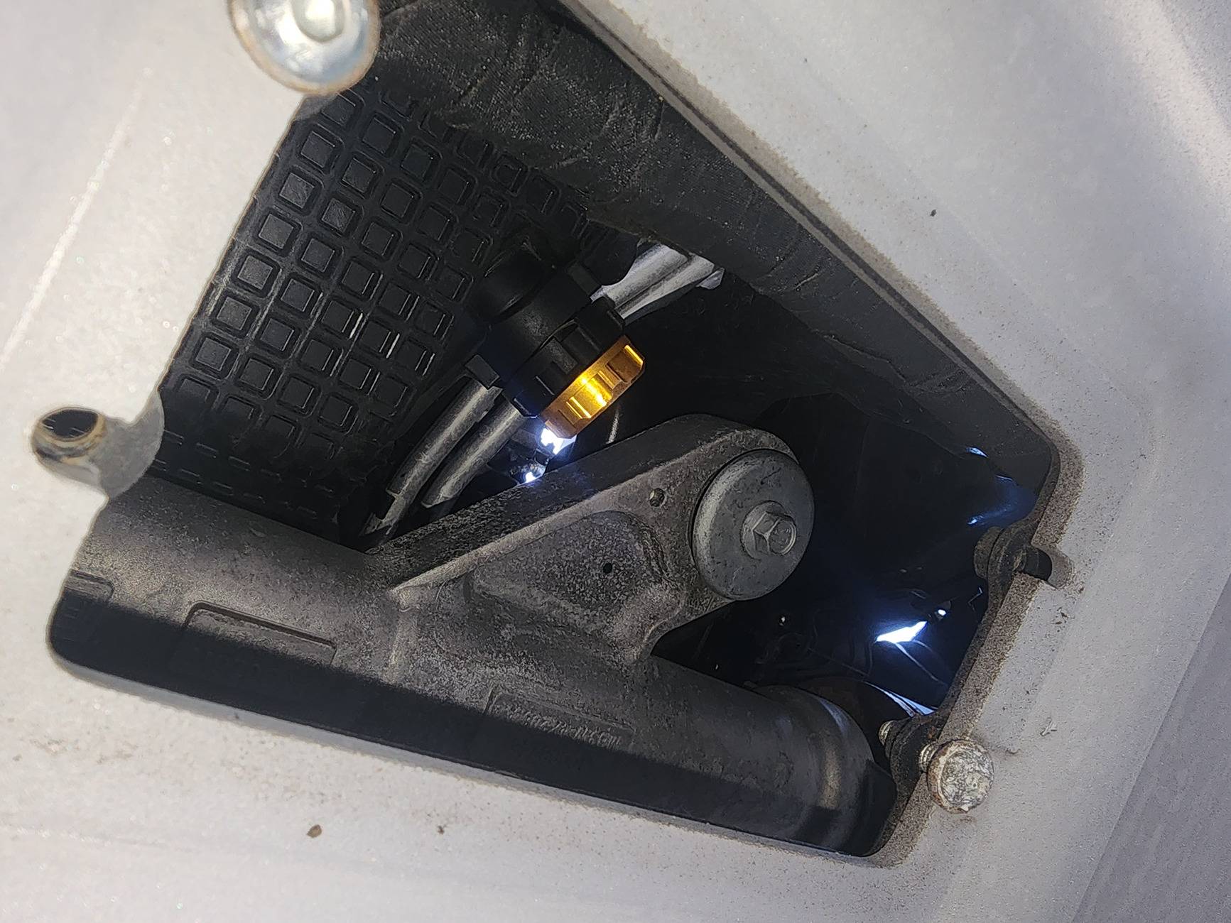

Here's mine for comparison:
Ford Ranger Ronin Oil Drain Plug installed on '25 Ranger Raptor (Fitment Concerns) 20241122_115540

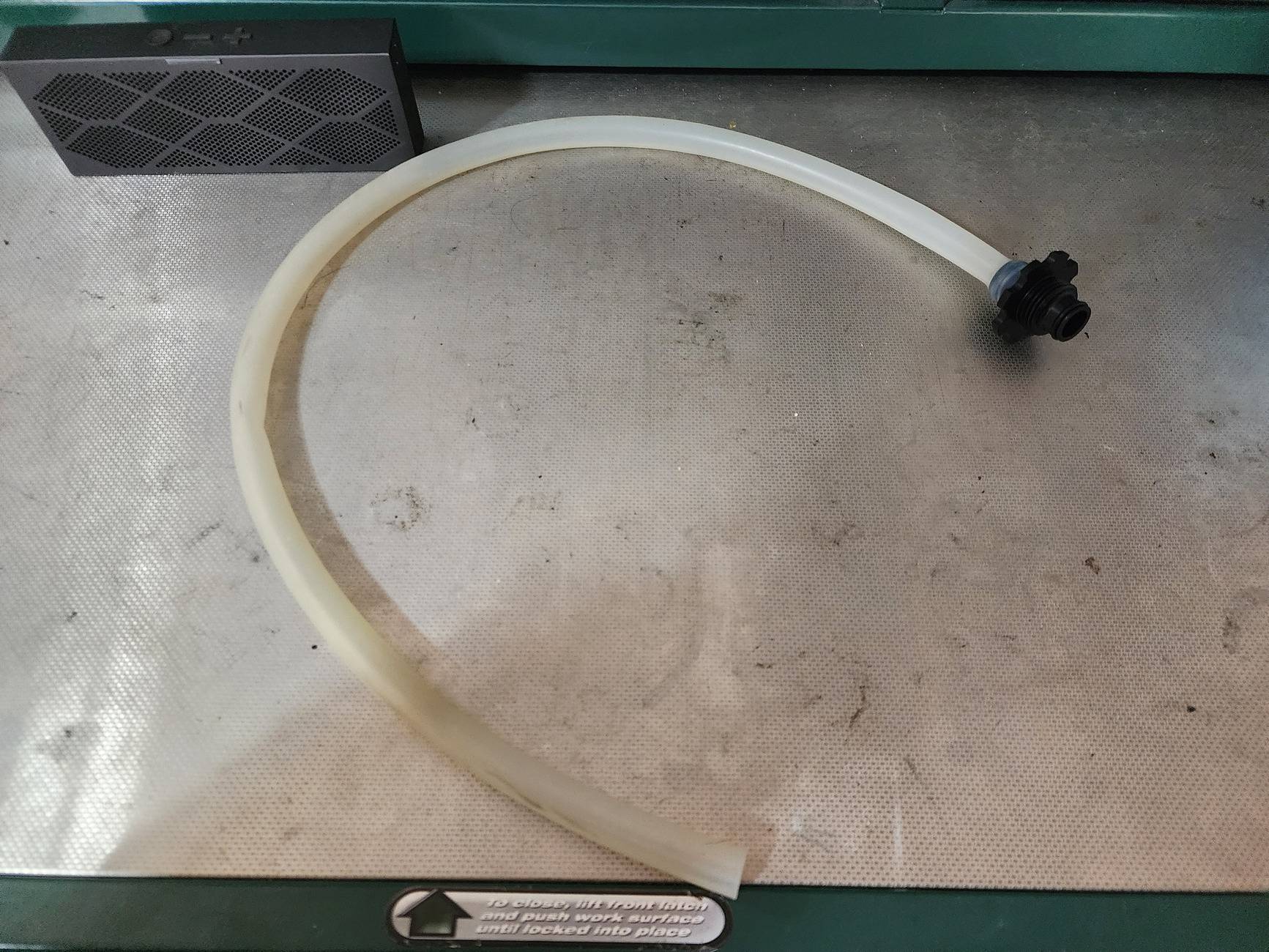

As for why we would want this plug, coupled with a section of 3/8" tubing, oil changes are easy and as clean as possible. I drain the oil straight into a container that I can take to hazardous waste disposal, vs draining into a pan, then emptying the pan into another container, and trying to clean everything up without making a mess.
Ford Ranger Ronin Oil Drain Plug installed on '25 Ranger Raptor (Fitment Concerns) 20241122_115852
Prior to the Ronin plug, I used a pliable sheet funnel that helped direct the oil, great product by the way. But the Ronin is so much better. No mess at all and I'm just a mess in general when I work.

Great write-up. I totally missed the picture on their site with that gap before I started this thread as it looks pretty much like the picture I took after install. I loved the Ronin on my F150 and was just concerned with the fitment and that gap. However, I will say their support replied multiple times on Sat and Sun and explained the redesigned plug and I was impressed by that. I am no longer worried and will enjoy the cleaner oil changes. Is this on a Bronco Raptor? I like that skid plate access hole for oil changes.

Glad you're at ease!
It's a Ranger Raptor, but I swapped the factory skid plate for the Rival skid plate with the access panel. I like it but realistically it's just 2 less bolts and removing a smaller panel vs the whole plate.

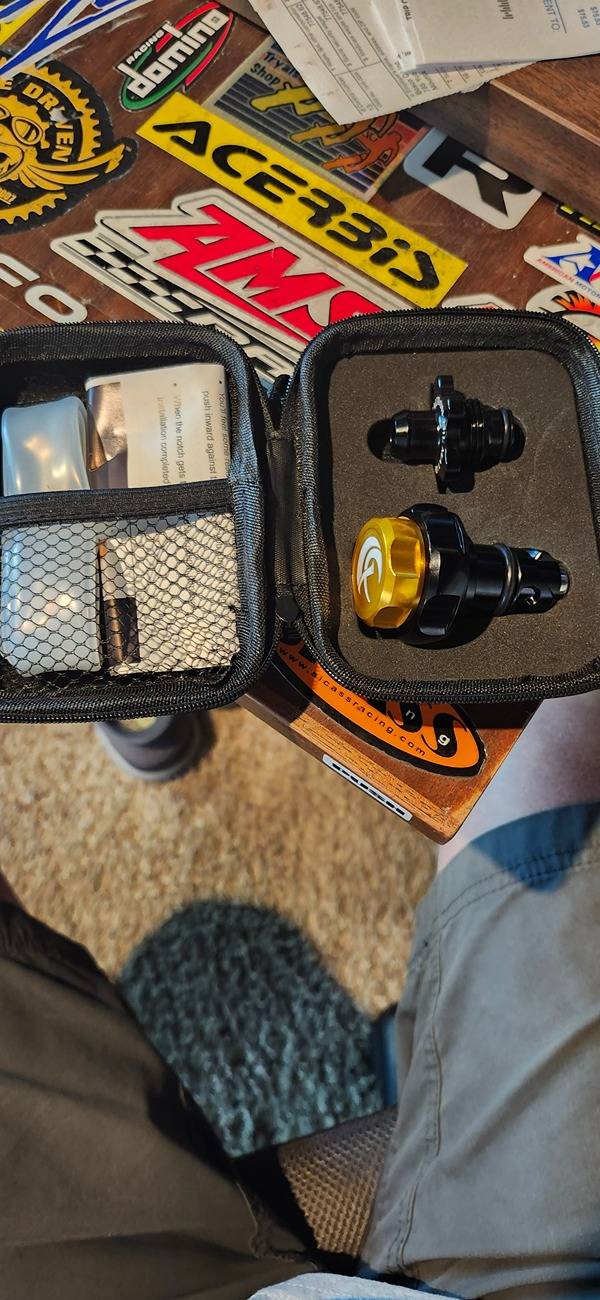

I got a Holdly drain plug on Amazon $29.00 it came in a fancy case
