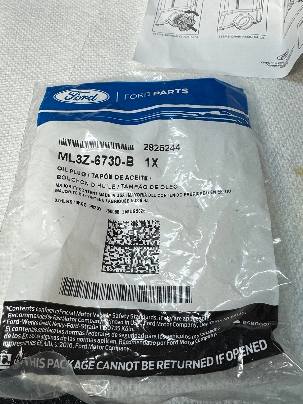

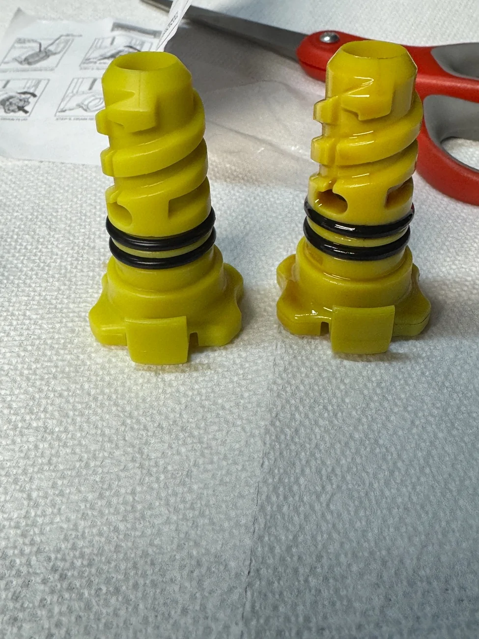

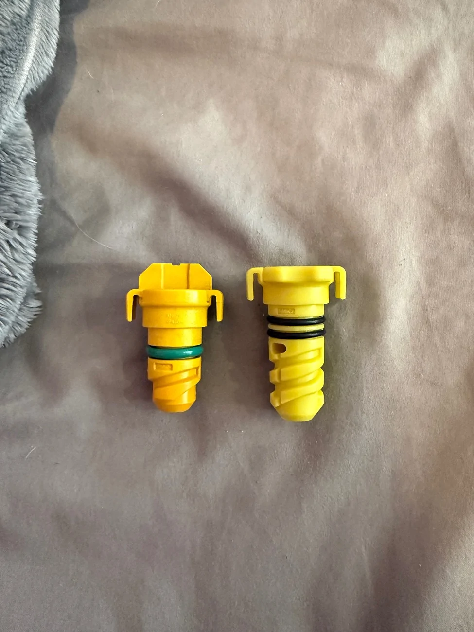

I ordered a drain plug from ford parts for the ranger raptor. The new one (o the right) looks different, it’s got two o rings instead of just one and it’s just longer in general. I haven’t had the chance to install it yet because I didn’t change the oil yet. But it is supposed to replace the old one.
On the website, it lists it as compatible with the 3.0 V6 among other engines. The image on the product page is literally the old one.
So I’m guessing this is a revision and supposed to be an improvement over the old one.
What are your thoughts on this? The part number is ML3Z-6730-B.
It's been updated because of Ford receiving reports on previous plastic type oil pans and drain plugs leaking. Years ago they also update other type of connection issues with dual o-ring instead of a single, Ex. on some transmission cooler lines, AC lines etc.... Strange they would try single o-rings in the first place from previous experience! Yet the 2.3l is still the good old fashion metal one! Note the slot and the hole, suppose to aid in controlling the out flow!?!?

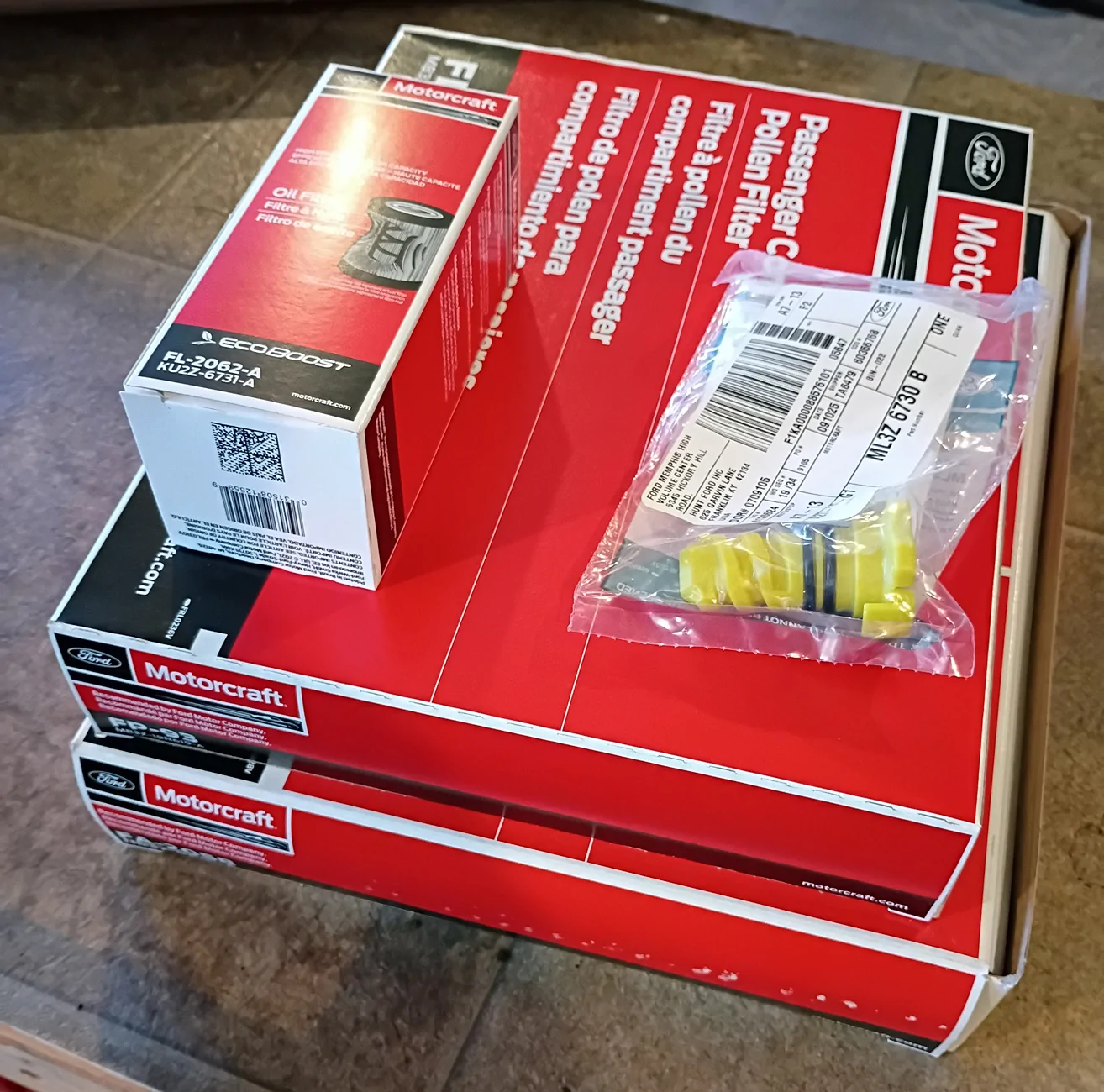

Picked up a spare drain plug as the first oil change is happening this week. Since I was at the local Ford dealer, I used some points for a engine air and oil filters and a cabin filter.

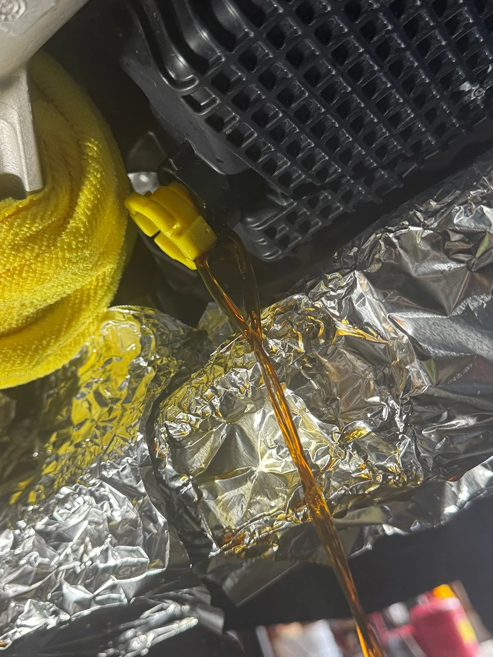

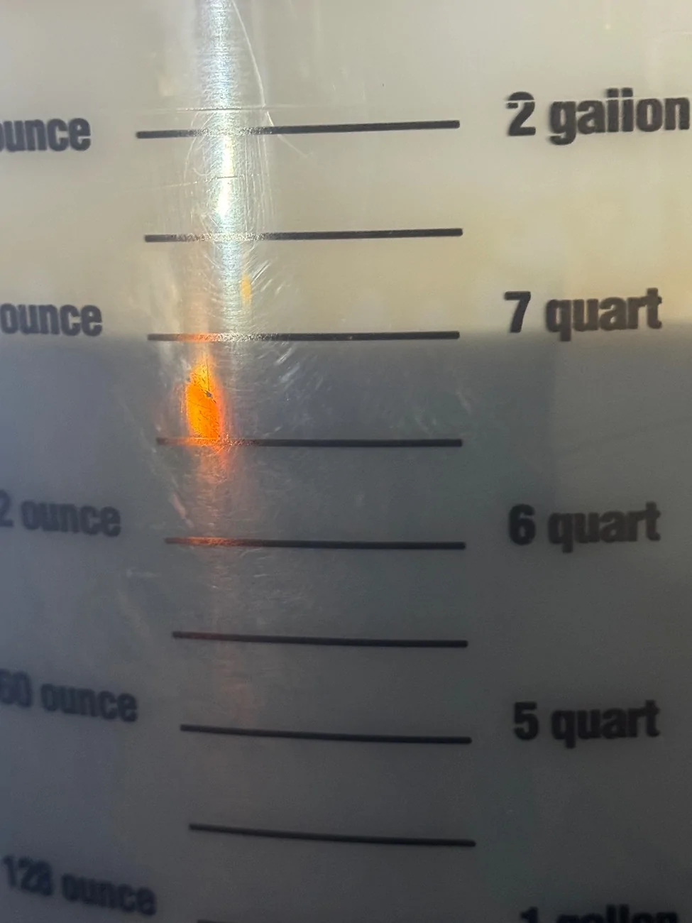

drain plug was the same this was my break in oil change at 1000 miles wasn’t as bad as I expected wrapped the harness with aluminum foil and just loosen the plug and just let it drain 7 quarts came out
