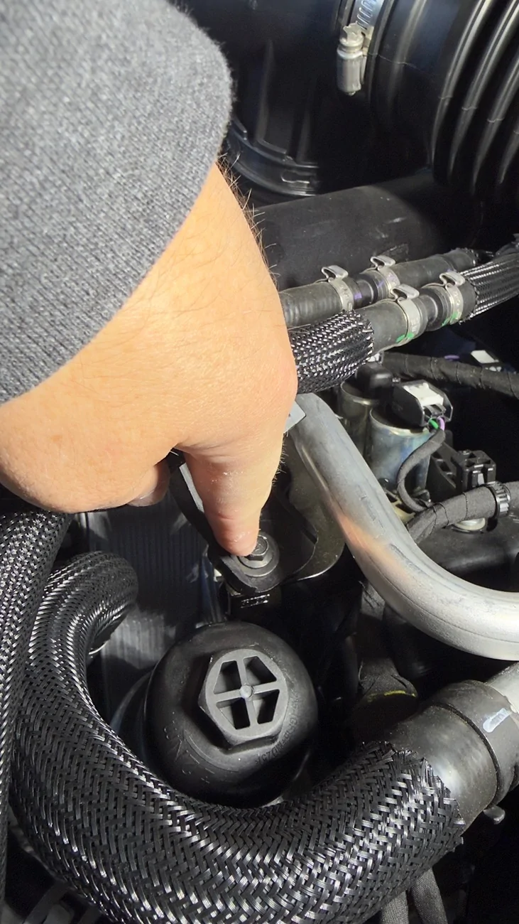

Tried installing mine tonight but ran into a clearance issue with a bracket holding some hoses just to the left of the filter on the valve cover.
How’d you address that issues on yours?
Specifically asking about this bracket.
