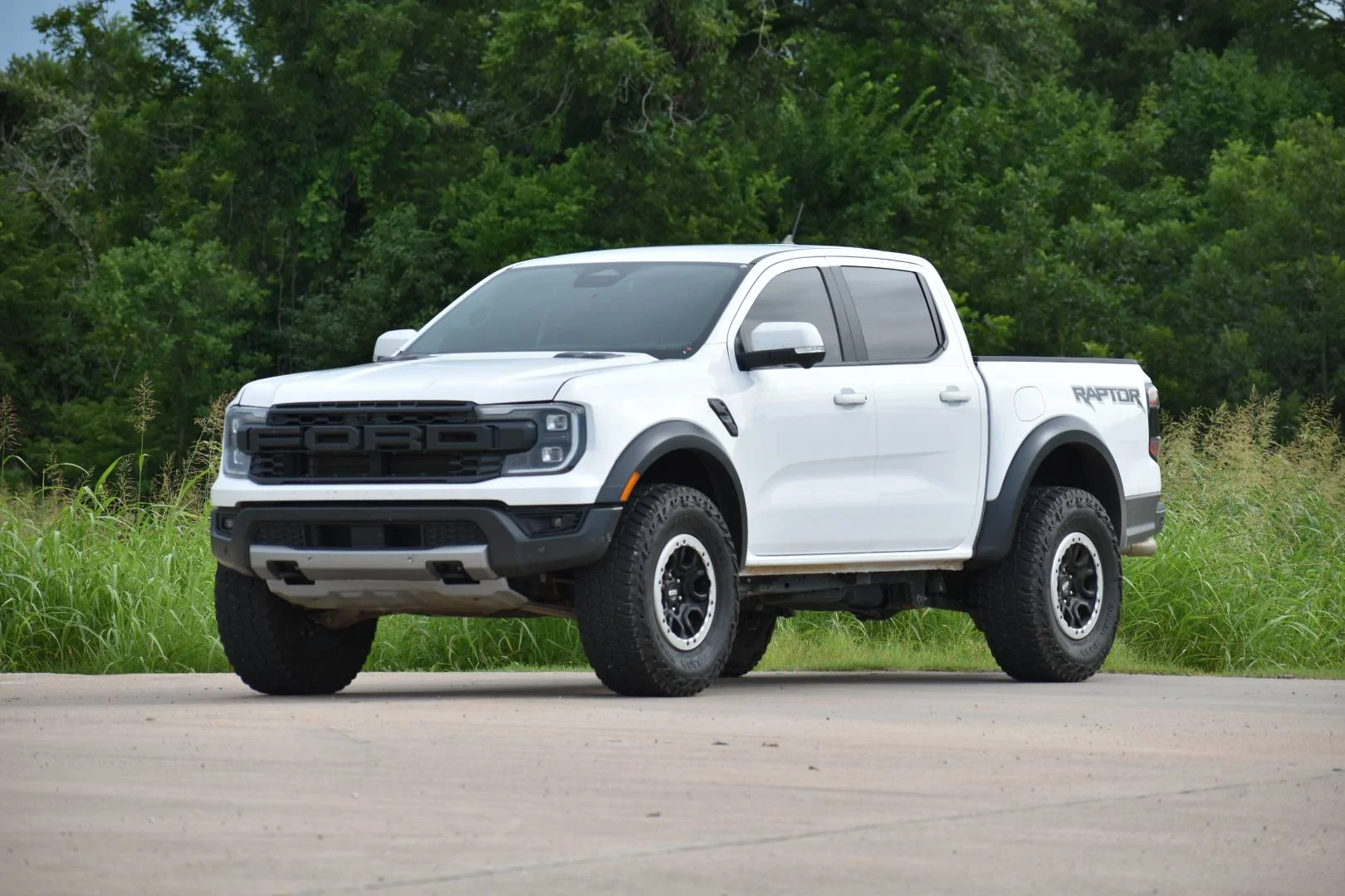

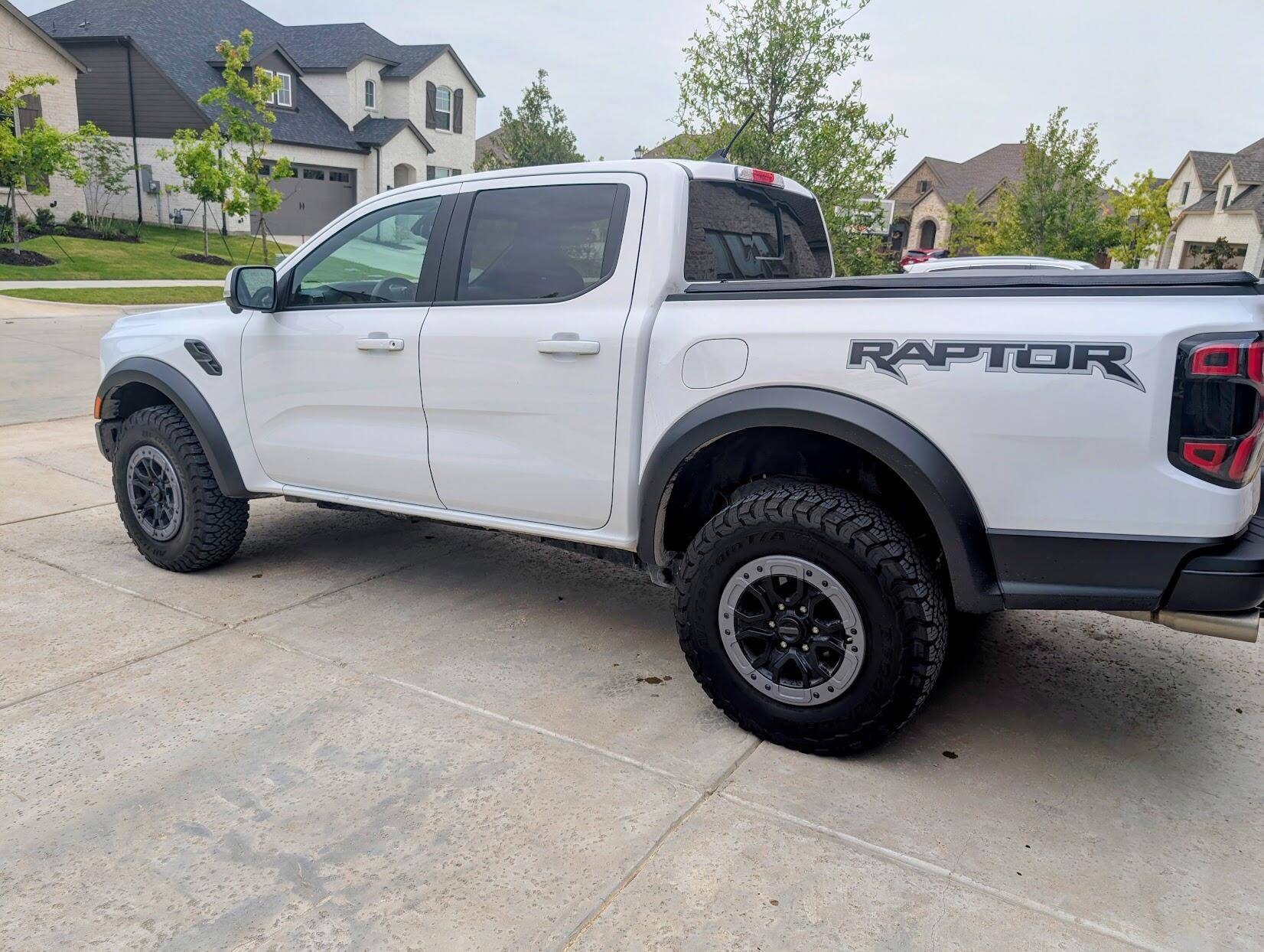

I picked up a very well used Ranger Raptor this past Saturday and looking to add some Raptor steps to it. Looks like the previous owner removed a bunch of stuff beforehand (which is ok) and it is missing the OEM steps. I found a set and on the way to get them, just curious what the bolts are and quantity? Anyone have an idea?

6 bolts per side (groups of 2, forward, middle, aft)
I forget the size off the top of my head

I found the P/N from Ford but no description. May have to run to the dealer and order them.
W706557-S307

Nice white Raptor.

Ok, I figured it out for anyone else’s knowledge.
M10x1.5x20 or 25mm
I went with stainless steel flange nuts.
