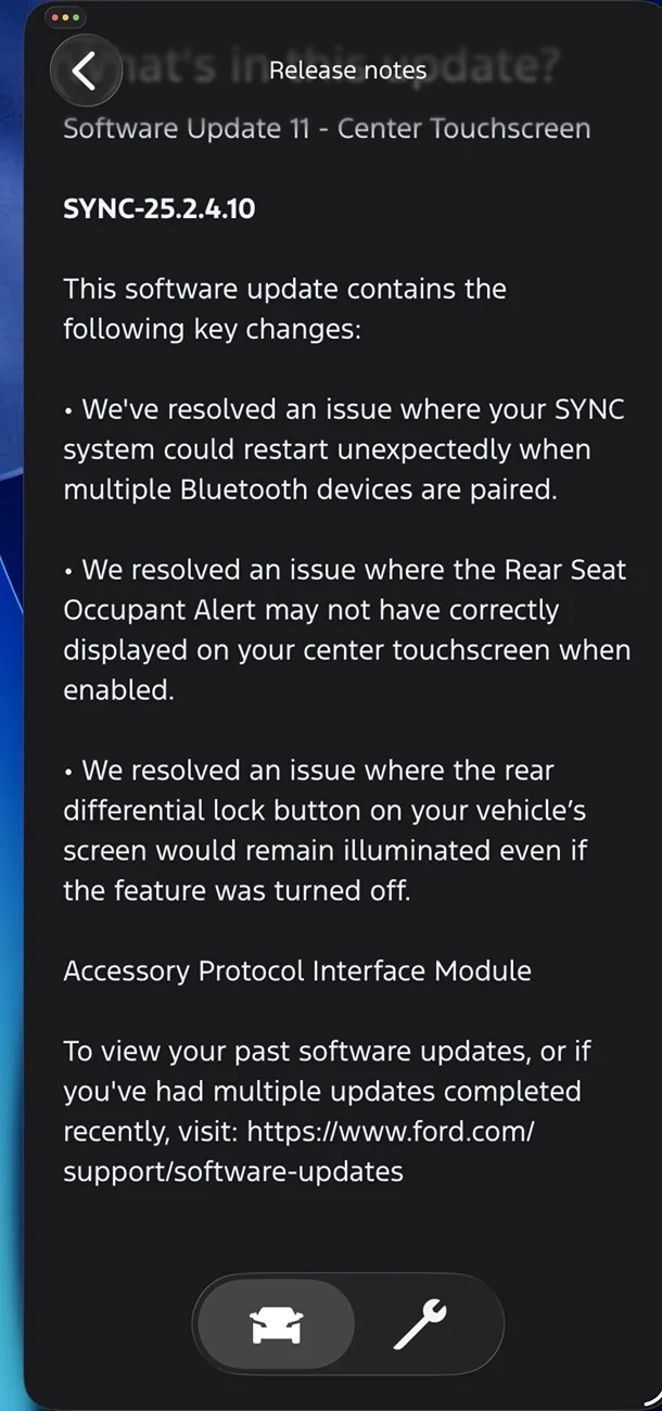

I noticed in one of the updates it mentioned the locked differential light would sometimes be on when it wasn’t.
