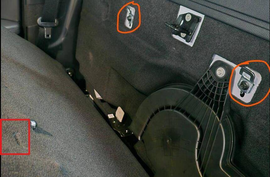

Not sure where I put the repair order. No new parts, they said they adjusted the latch and also a bracket was interfering. Based on the picture I shared in this thread previously; it might have been one of the brackets circled.

Sure looks like the child seat anchor point left an impression on the back of your seat. It sounds like a widespread issue.

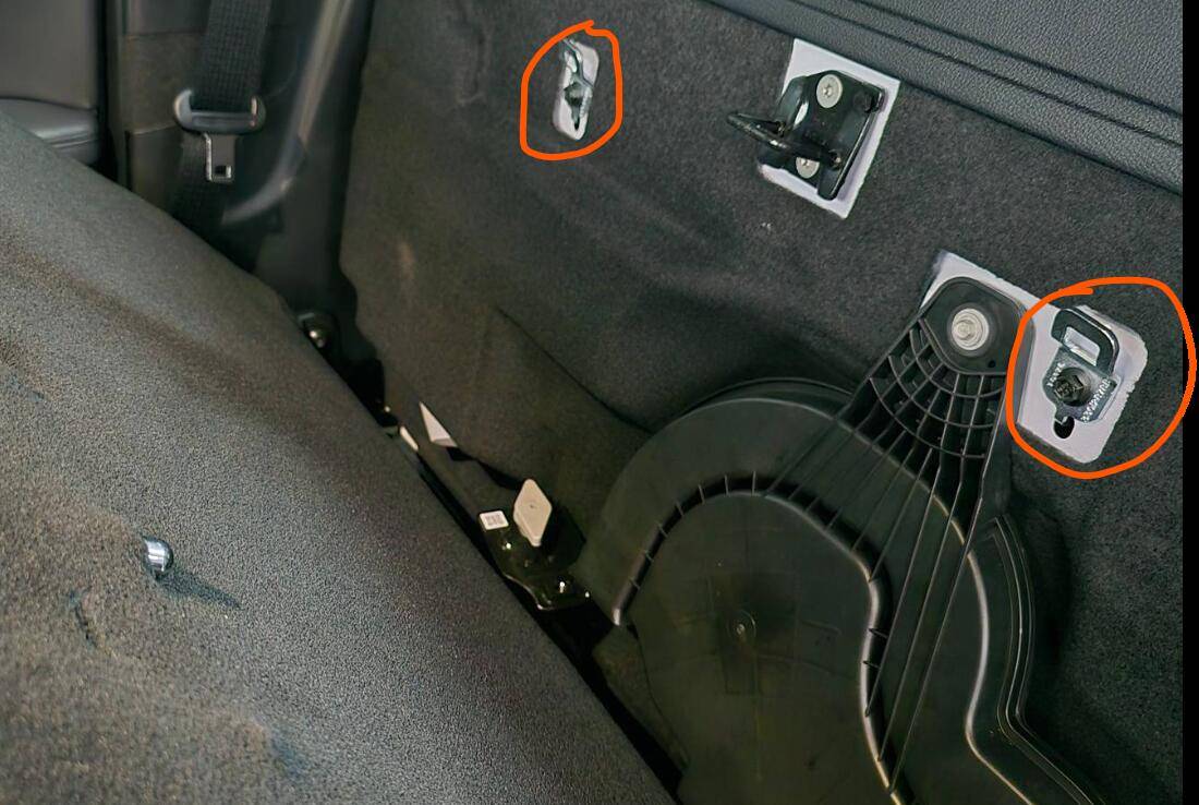

I removed both of those seatbelt tether brackets to see if they were getting in the way but it didn't make any difference. Now that I see here the fix for the issue the dealer will perform I'll bring it to them and have them replace the latch.
