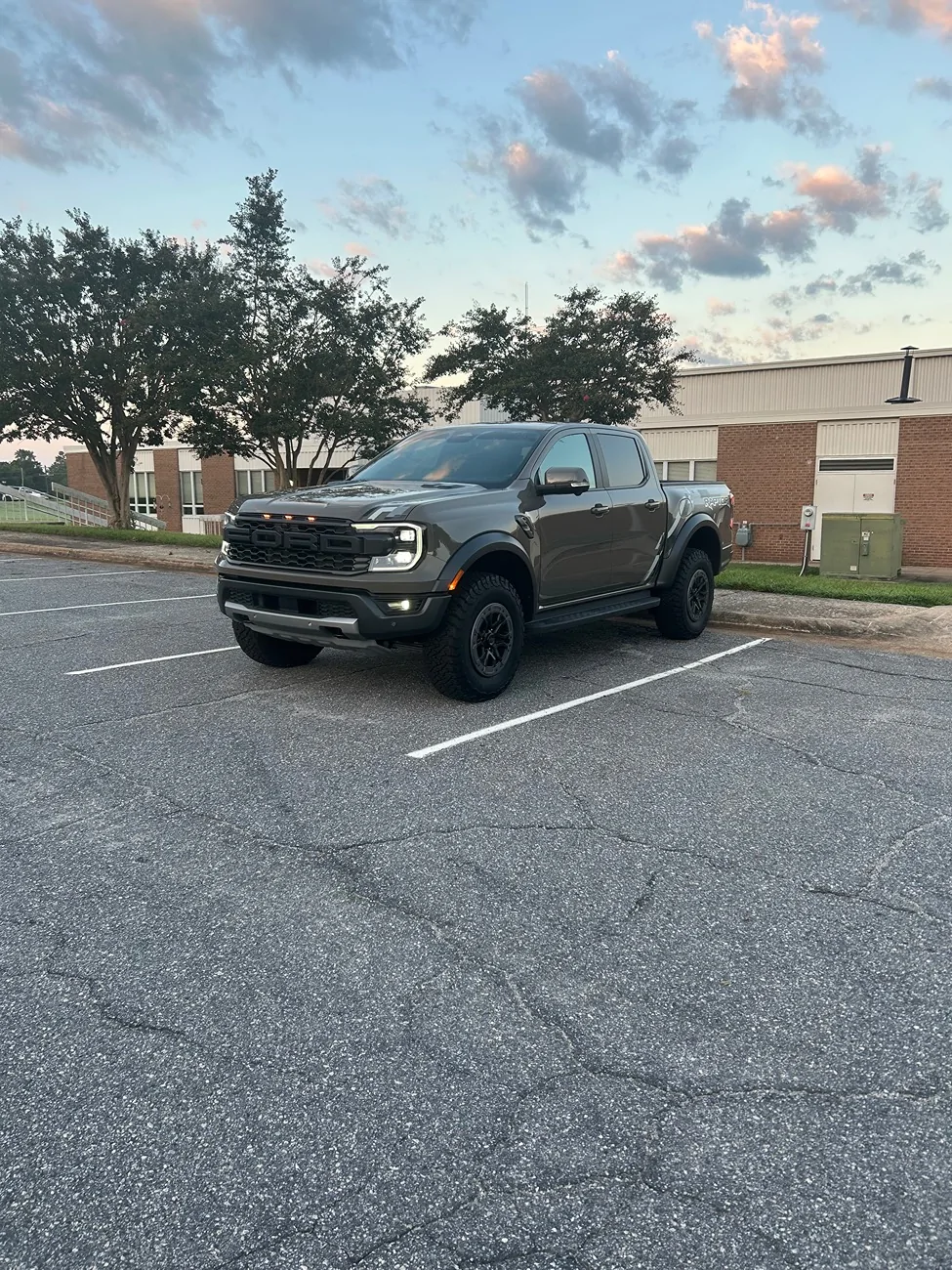

Bought brand new Ranger Raptor and when i got it home noticed the back window doesn’t slide open. Took it back to the dealership and they trouble shot it and said it was either something behind the fuse box or the back window had to be replaced. Have anyone else had any issues with the back window not working?

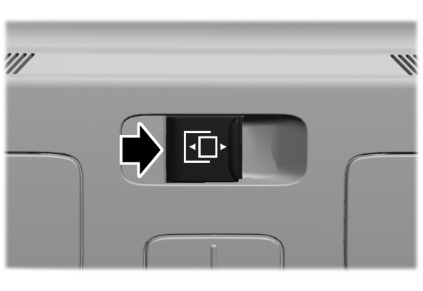

Where is the button for the rear window?

On the overhead console, next to the cabin lights.
Ford Ranger Back Glass Window imagen2
The window control switch is on the overhead console.
Press and hold the window control switch to open the window. Pull and hold the window control switch to close the window.

Thanks!

Yes the motor is integral to the glass. I took it to the dealership and they trouble shot the easy stuff like, is it stuck, is the motor getting power, the switch getting power etc. neither are getting power so, they are planning to take the fuse box out and start from there.
