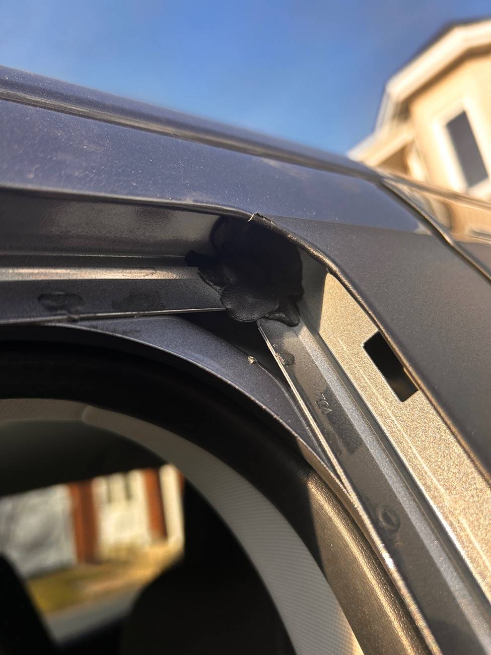

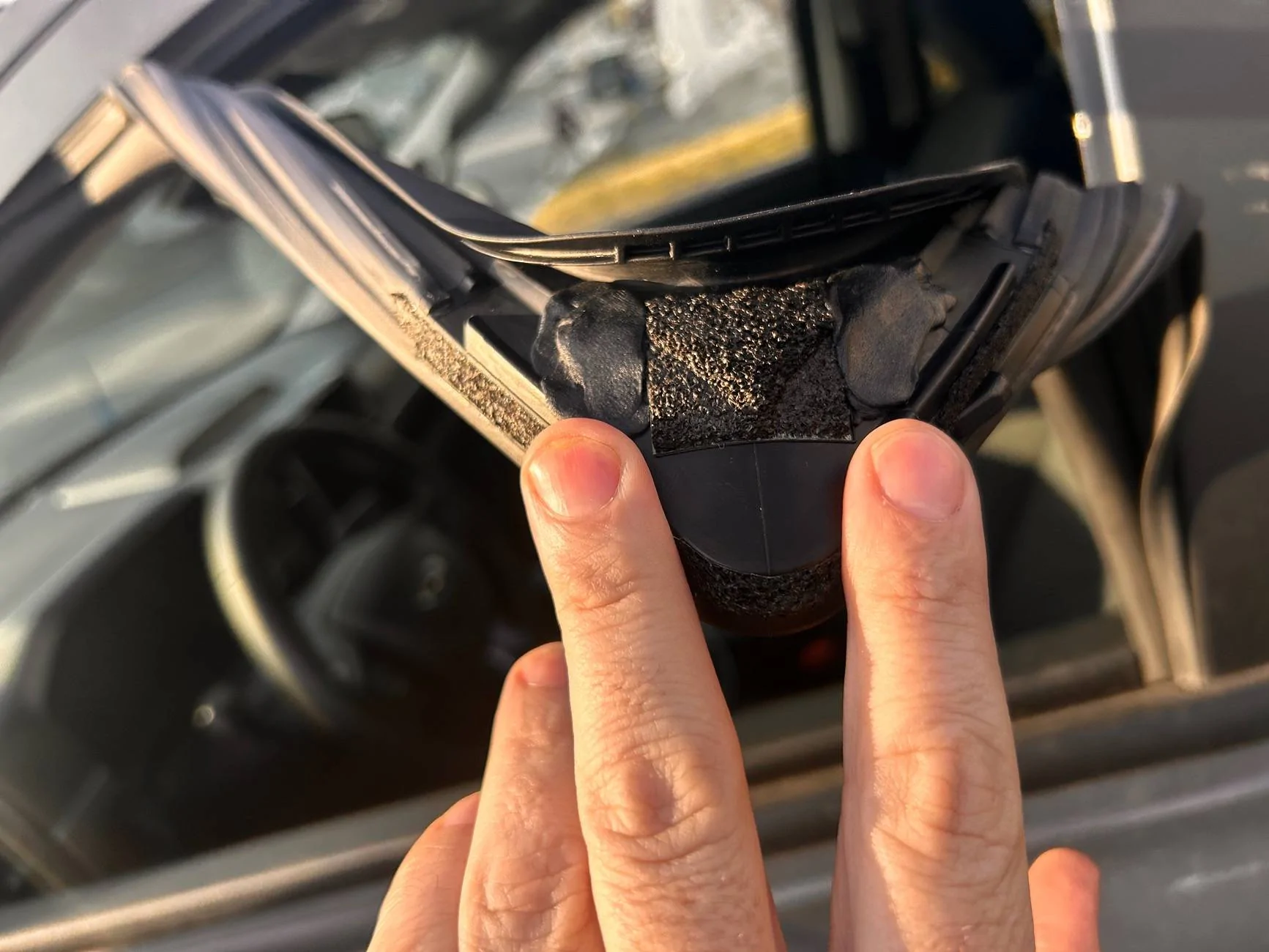

Here’s how I fixed my noise issue on my truck
The whistling noise was coming from the opening inside the window door frame upper corner in my case. This was on both doors. 5mins to fix per doors, but months of annoying noise.
I use 3m Calk strip. Can be bought on amazon.
If you don’t know this stuff, super useful for automotive or travel trailer and can be easily removed. Please do your research before using it if you don’t know it.
Ford Ranger Driver Side Window Wind Noise IMG_5551
With the window down, I pulled out the window seal gently and add on each side of the inside foam square. If it don't stick, wipe it to remove any greasy residue on the rubber seal.
Ford Ranger Driver Side Window Wind Noise IMG_5547
Add some in the corner where the square foam is not reaching the frame opening. You can see the triangular frame opening. The goal is to close the air from this zone not covered by the foam.
Ford Ranger Driver Side Window Wind Noise IMG_5546
Carefully set back in place without pressing the seal and once in place apply pressure to stick the 3m calk.
After that I had only normal door wind noise like my ranger2020, but no whistling.

I think the seal or door frame is just badly designed based on the fact that I had this noise on both driver and passager side.
It’s been two weeks that i did my fix and I had strong face and side winds running over 100km/h without noticeable noise coming from the upper window B pillar.
Without service bulletin, the dealer will just replace by the same seal.
I hope this will work for you or at least lowered down to a level that is acceptable while waiting for an official upgraded seal.

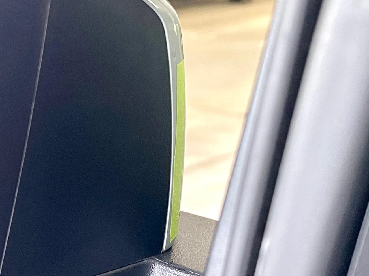

My dealer replaced the driver side mirror. New mirror housing, but reused the painted mirror cap, puddle lamp, and camera. Unfortunately, it did not fix the wind noise. The dealer scheduled me to bring it back in a few weeks for further diagnosing.
I did my own diagnosing today. I used auto body masking tape and covered different parts of the mirror until the wind noise went away. Then fine tuned where I applied tape to pinpoint the location.
My truck had full front paint protection film installed right after purchase. PPF on the front bumper, hood, fenders, and mirror caps.
I found the source of the wind noise to be the inside of the mirror cap, at the edge of the PPF. Applying a thin strip of masking tape right up against the PPF edge fixes the wind noise. I’ll either have a shop redo the PPF on this mirror, or just add a tiny strip of PPF where I have the masking tape.
I’ve never had an issue with PPF causing wind noise on any past vehicles, but am happy to have found the source of the issue.
