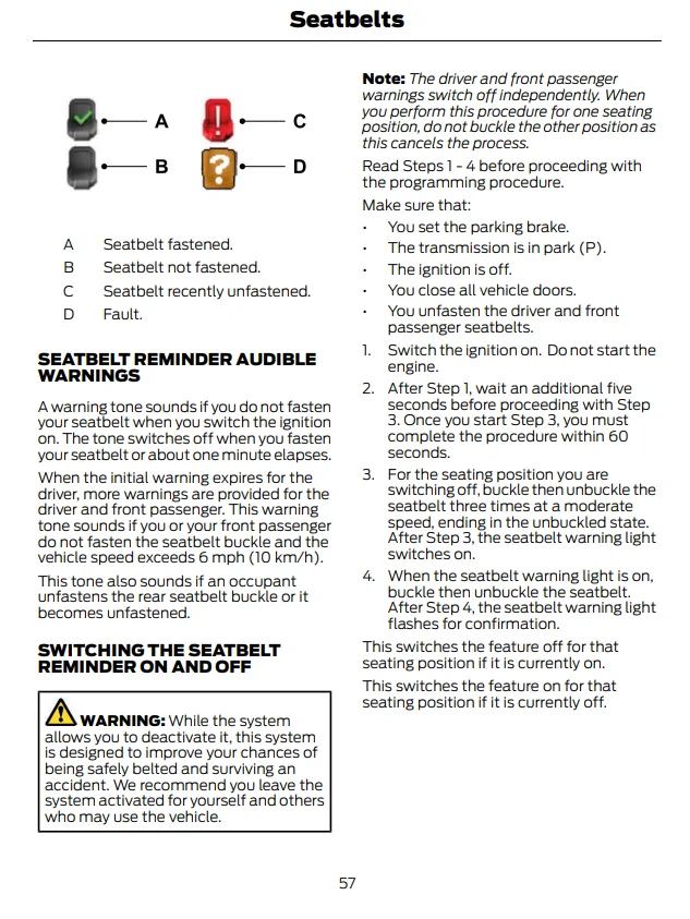

Looks like I found a solution from page 57 of the owner's manual:
Ford Ranger Rear Seat Seatbelt Alert Confusion 1758040911646-fs
I tried this and no joy. Found steps in RR owners manual and it said buckle/unbuckle 4 times. Again, no joy… maybe it’s me.
