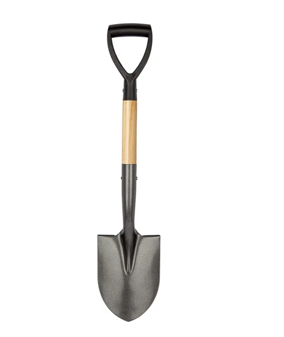

As others have said, basics, shovel is lightweight and very helpful to just use stuff you find around you like stacking rocks under a stuck tire, could lift the truck up a bit with a scissors jack, then put some rocks under the tire(s) for traction.

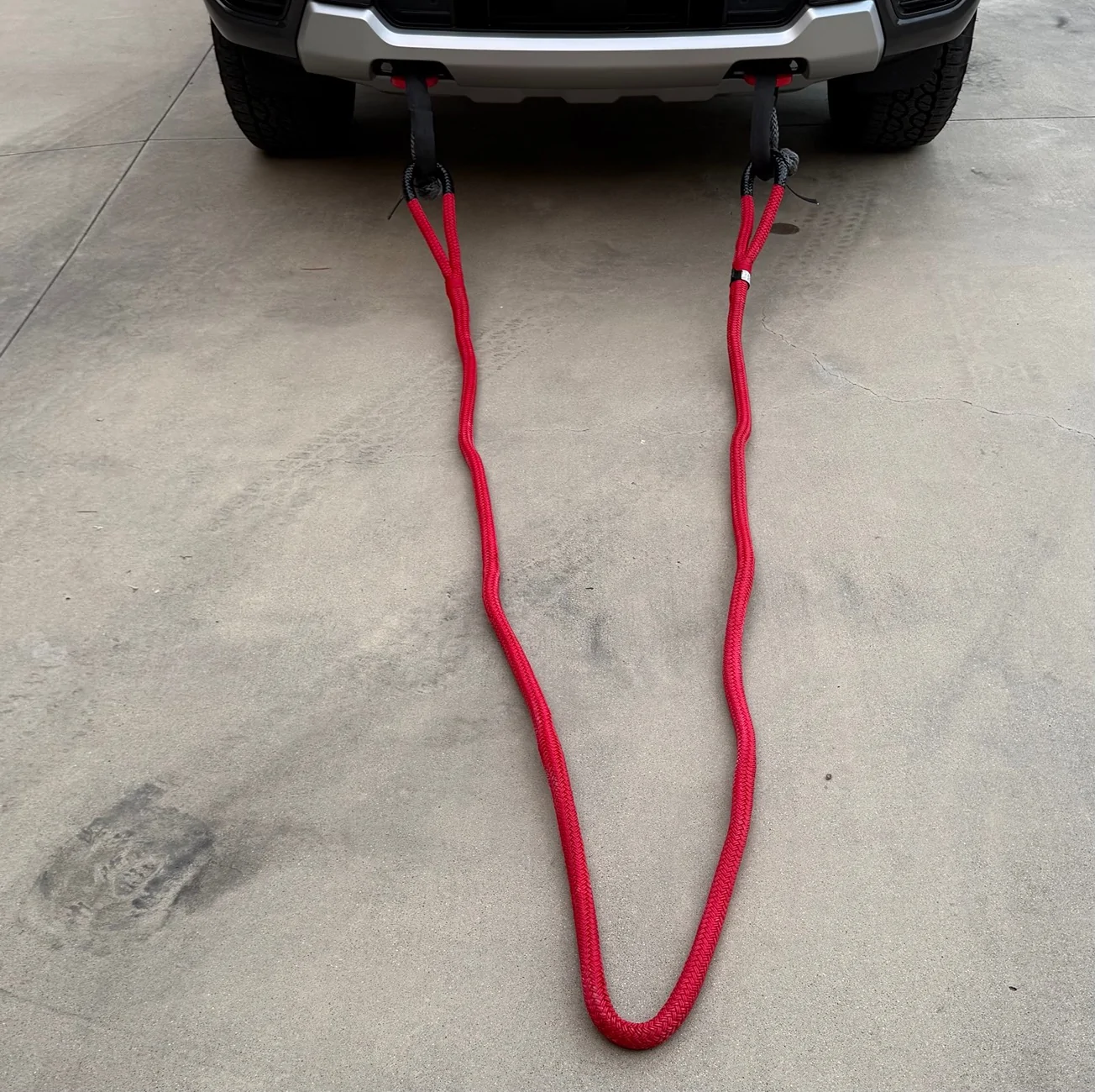

Cool. I have a kinetic rope and 2 soft shackles righ now. I'll probably get a tow strap as well. Have tire repair kits and a compressor. Looking into tire deflators. The ones I want are out of AUS and the shipping is more than the retail. So maybe the Stauns. Have wood, packing blanket and am assembling some key tools to carry. I don't want to carry shit I don't need. Light weight is important to me.

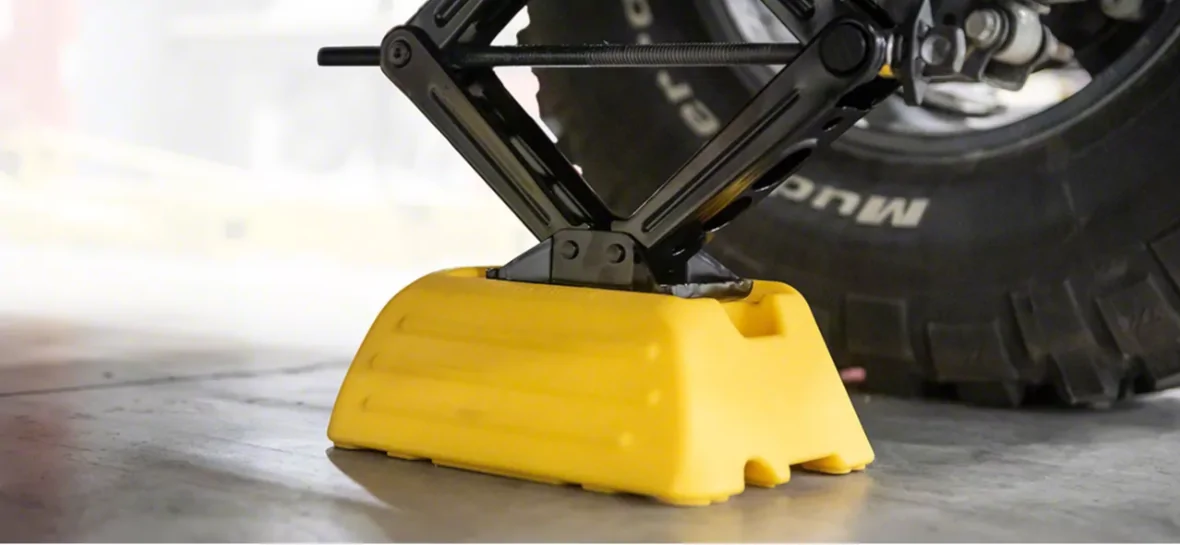

*The scissors jack and extra wide/tall pad works well. I bought an extra one off ebay, I think it was from a Suburban, came in a plastic case, sometimes having 2 helped.
