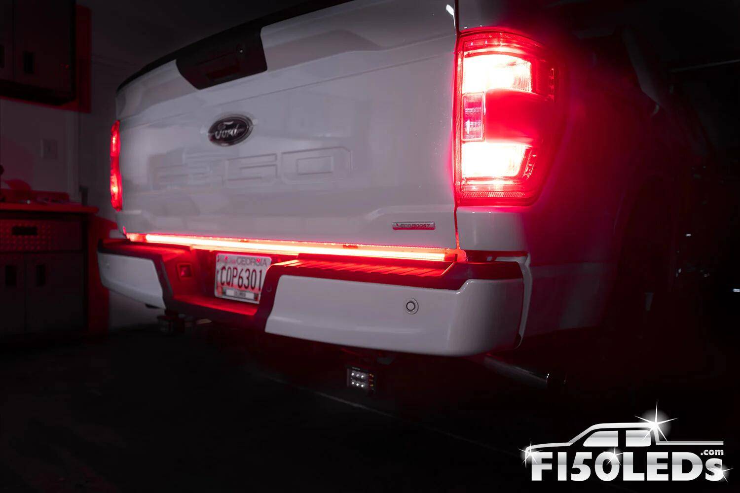

@F150LEDsMatt I see you guys are offering redundant rear taillight strips for F150s now.
Will these be offered for Rangers at some point?
If so, how are you handling these Ford trucks which have auto trailer detection now days whenever adding redundant lighting like this. I have yet to find a kit that will allow me redundant lighting without trigging the truck to think it has a trailer and by thinking it has a trailer on it is shutting off some of my safety features. I am still looking for solution to this issue.
2024 F150 Sentinel CREE LED Tailgate Bar

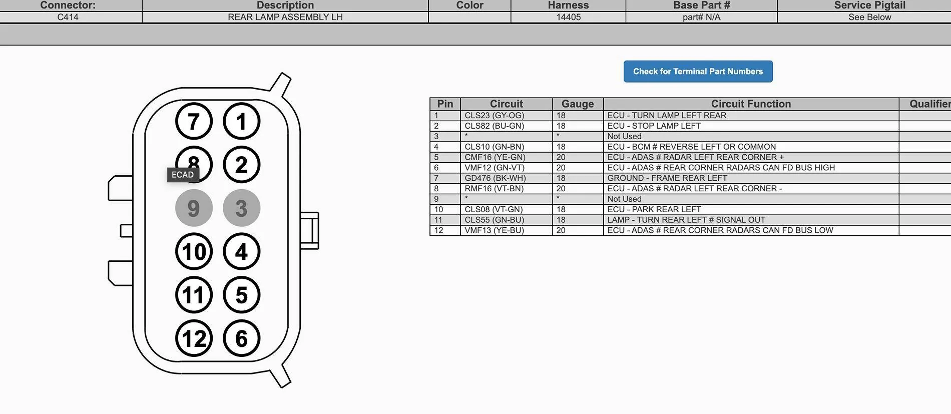

I found this old post for last gen Ranger and finding a pin layout for the rear tailight harness connector.
https://forum.gofastcampers.com/t/2021-ford-ranger-third-brake-light/16542/5
I am searching and searching but can't seem to find anything on this information for 24 Trucks. I dont have a problem tapping into the wires. Just gotta figure out what wires are what back there

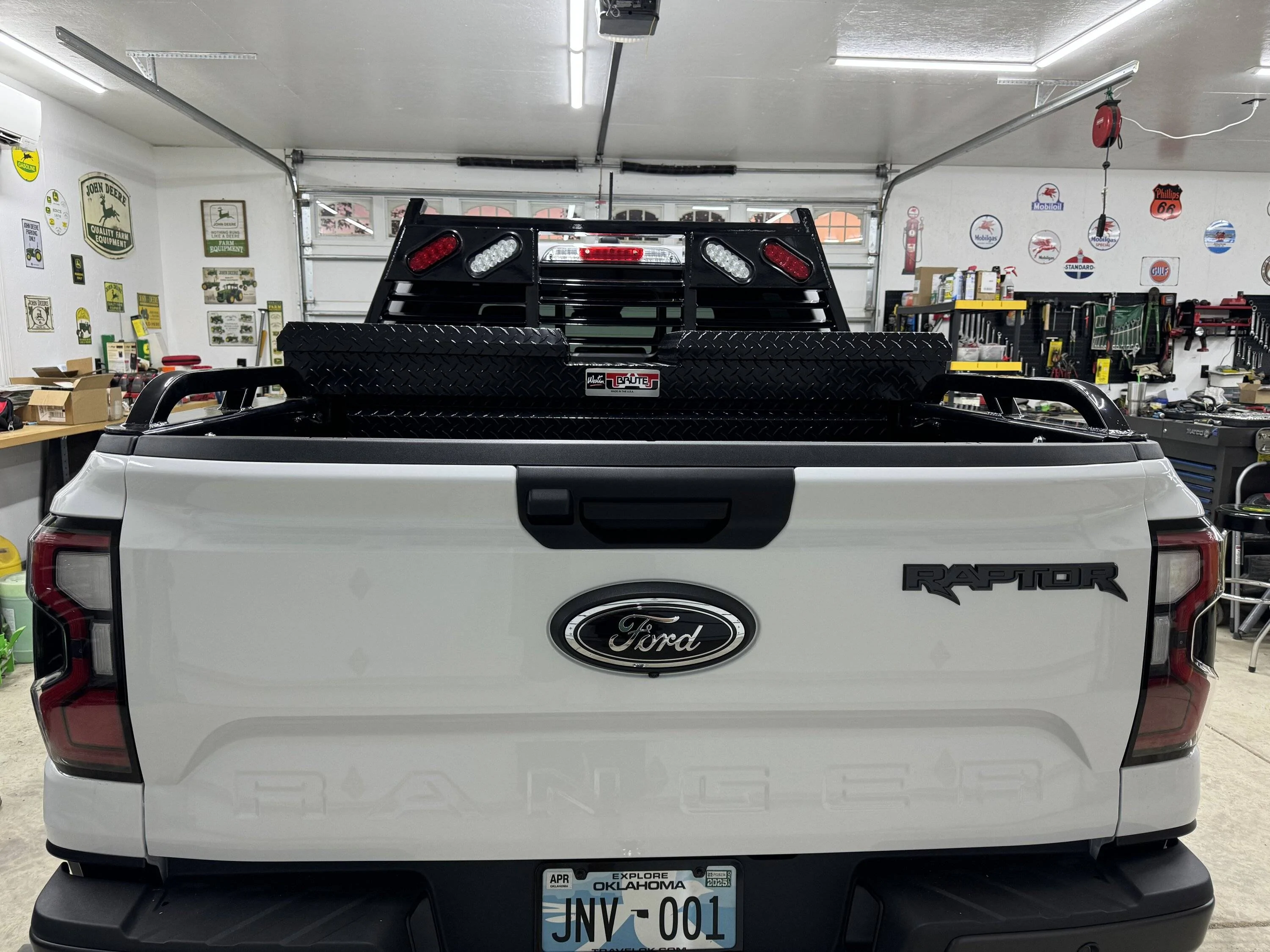

I hooked up the lights on my headache rack last night, truck now thinks it has trailer behind it?
Is there any sort of way to fix it so it does not auto detect a trailer, or in my case a lighted headache rack ?
The really big downside to the truck thinking it has a trailer behind it is that it keeps shutting down numerous safety features, like blind side monitors are now off, cross traffic detection is now off, backup park sensors are also now shut off.

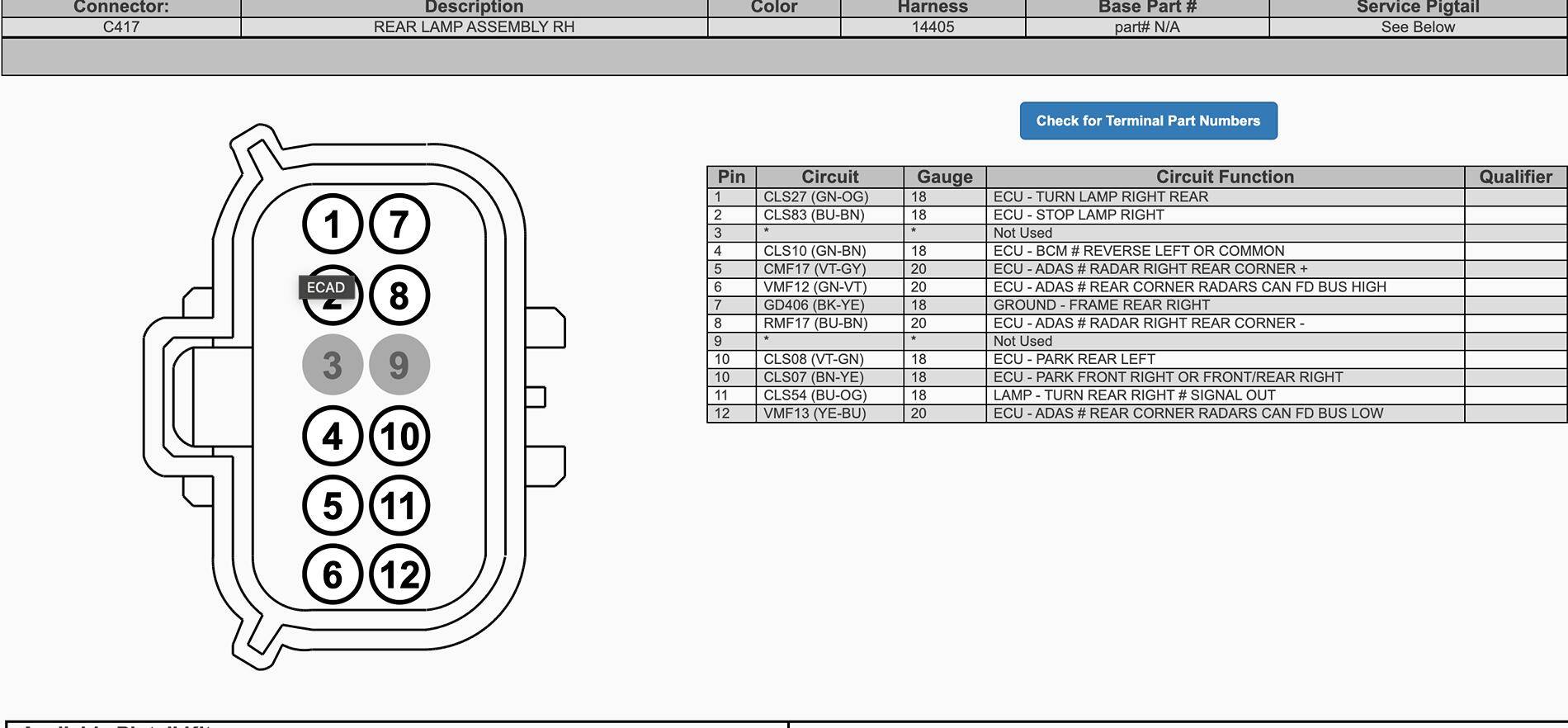

@cc1999 Took some screen shots of the connector on LH and RH Taillight connectors. I need both brake and signal. I would be unsure on using pin 1 & 2 or Pin 1 and Pin 11. Maybe someone else can way in on that Circuit function
Ford Ranger Redundant lighting wiring solution so that the Rangers do not think it has trailer behind it? Screenshot 2025-01-14 at 3.28.14 PM
Ford Ranger Redundant lighting wiring solution so that the Rangers do not think it has trailer behind it? Screenshot 2025-01-14 at 3.27.01 PM
