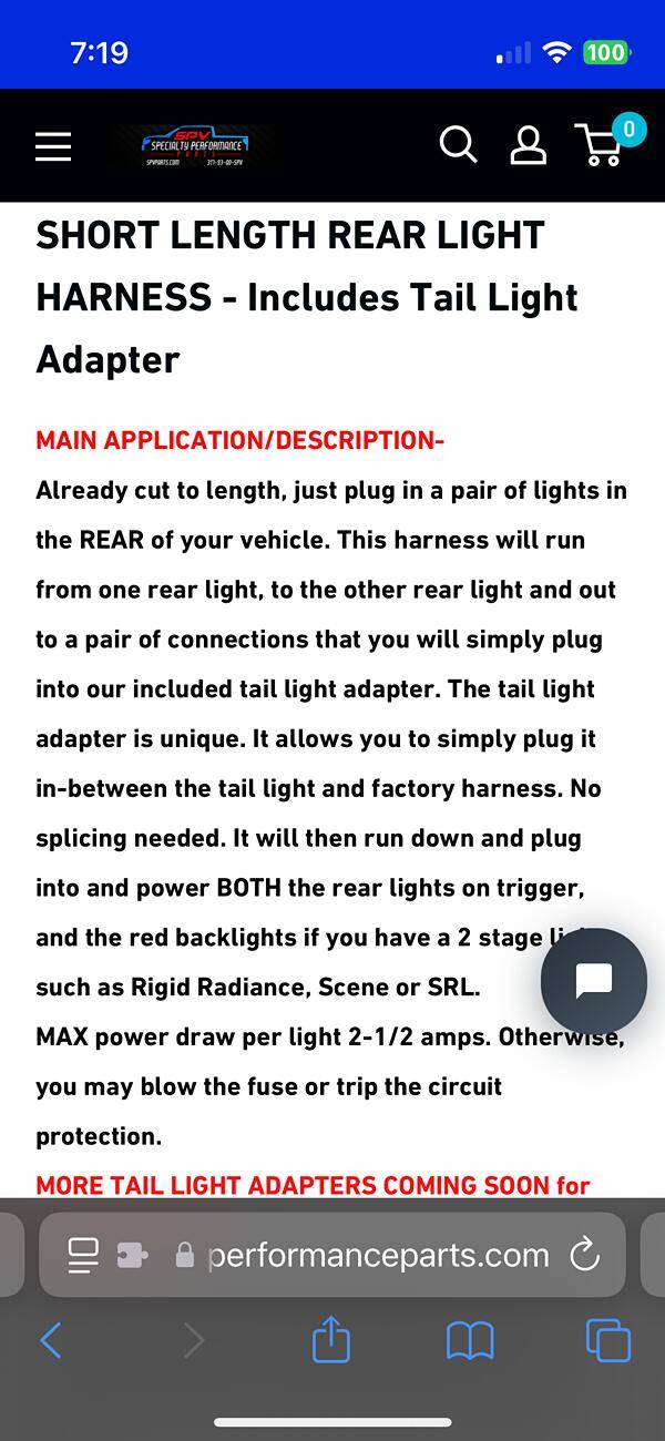

I ordered one of the kits, I will let you know how it works out. It does have the Ranger Raptor listed.

I dont know. I ordered a wiring harness from spv and it is supposed to be here tomorrow. My topper should be in and installed this week, so I'm planning on working on the third brake light this weekend and will post afterwards.

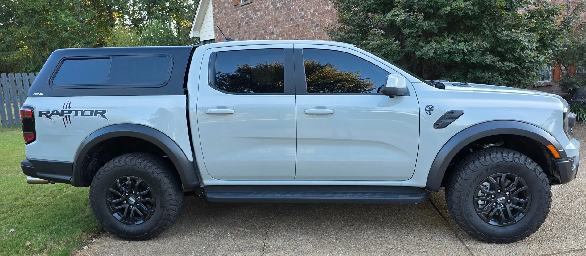

So I installed my wiring harness from Specialty Parts on the right-side brake/taillight. Remove the two 10mm bolts that hold the brake/taillight on, and you might have to kind of bump it outward with the palm of your hand but then it just pulls out. Unplug the taillight wiring and plug their harness in and plug the other end into the harness. It has a long cord attached that has a red and white wire. The white wire attaches to the positive on your third brake light and connect the third brake light ground to a ground. Works great, no false trailer alerts. I am not sure about the red wire maybe it's for a running light.
