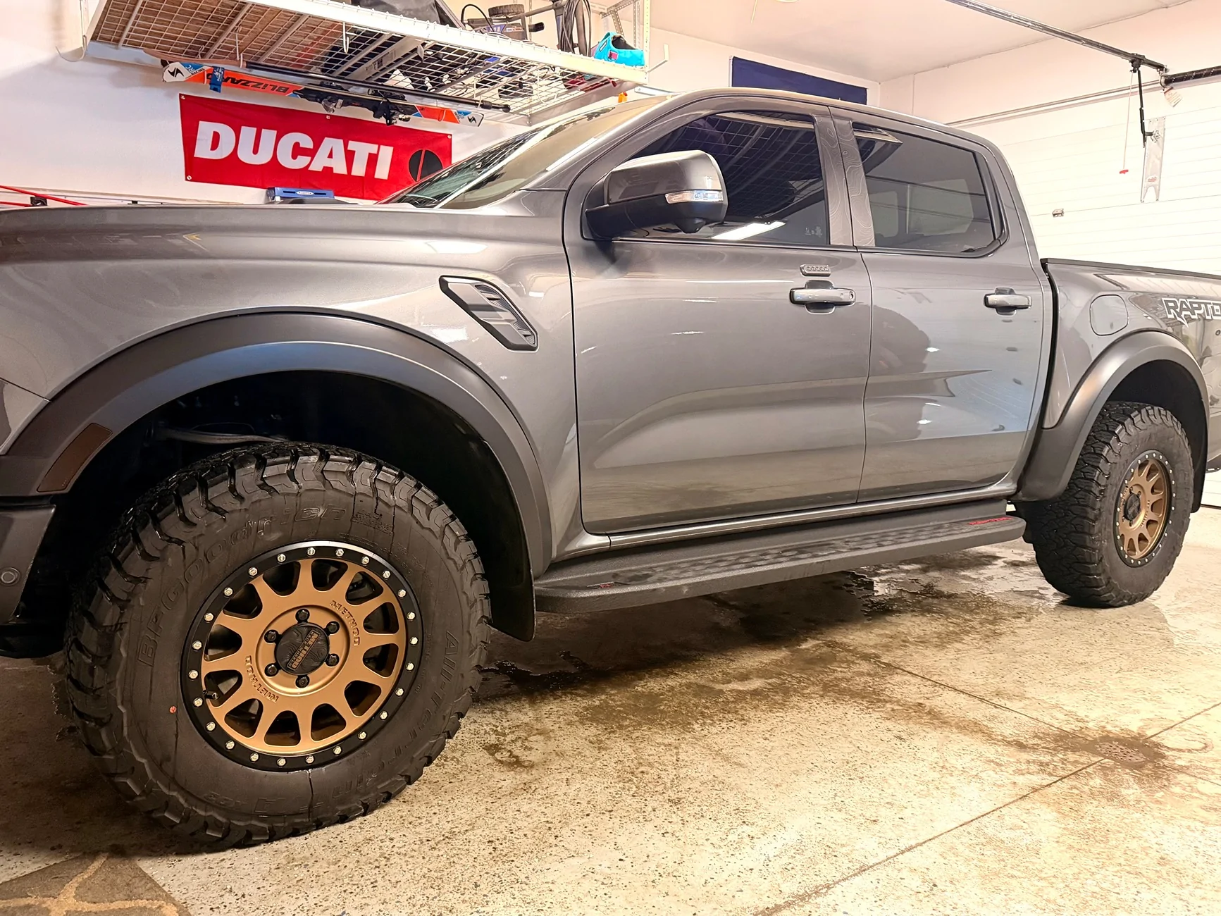

I switched to these Method wheels with a +25mm offset and noticed my transmission hunting a lot more (relearned with Forscan) and it is more nervous on the highway requiring a lot more steering input than before.
Ford Ranger Ride expectations with +25 offset IMG_9504
