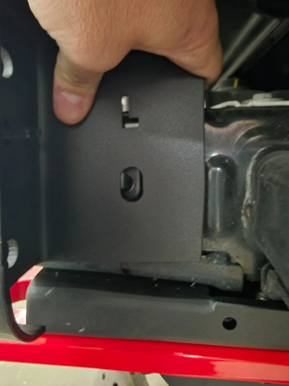

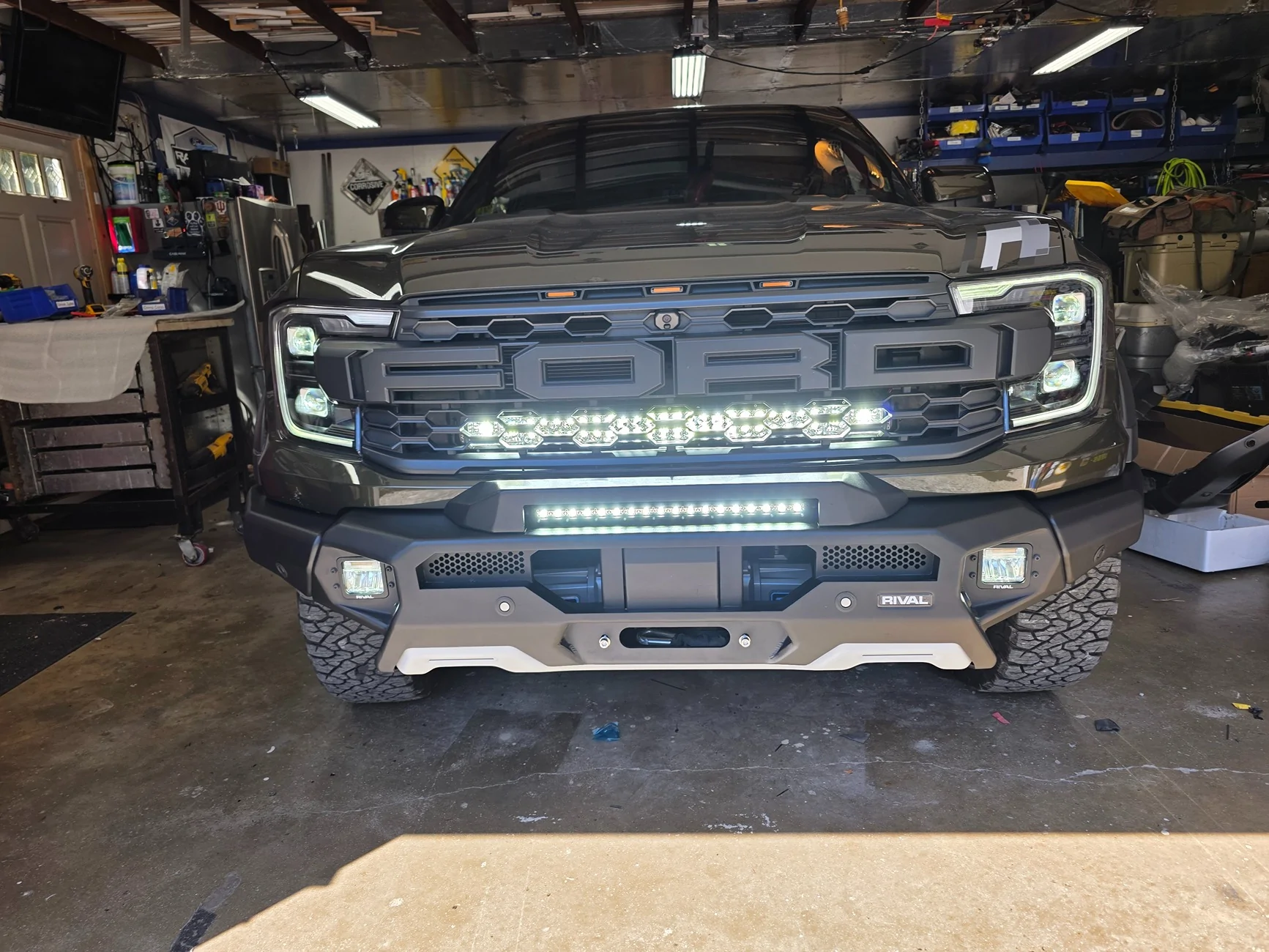

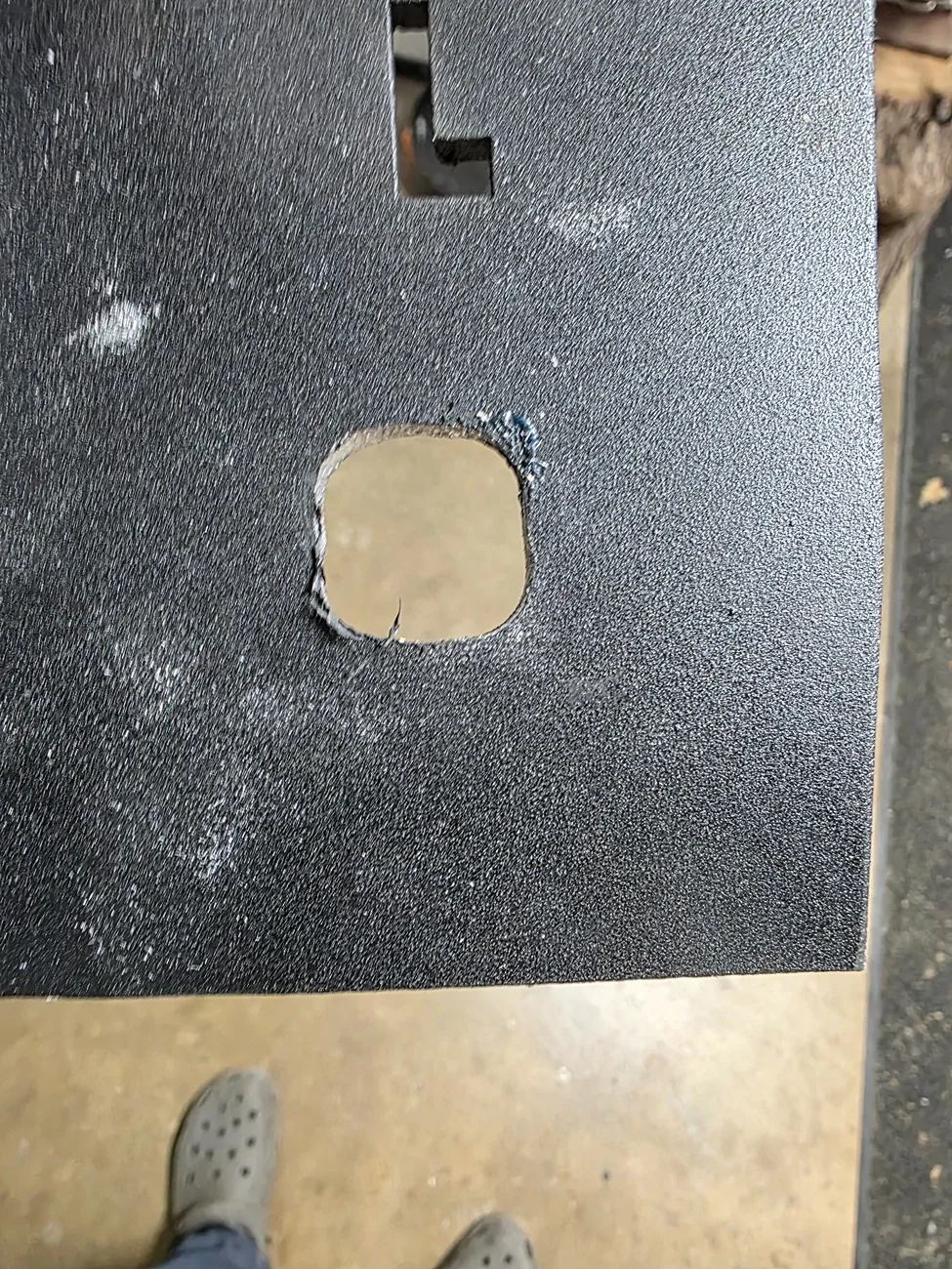

Installed the bumper and winch over the weekend, here's my thoughts for anyone interested. I've been working on cars for 20+ years, swapped motors, etc. Not a pro, but not an amateur.
  1. Overall impressions / fit and finish are great. It's obvious that a ton of engineering went into this.
  2. I spent probably 10 hours over the course of a day and a half getting this all removed, installed, and wired with lights and grill lights.
  3. You'll probably want 3 tables or workbenches to make this easier. 1 for the old bumper, 1 for new, and one for fasteners
  4. Instructions are non-existent, the install video is OK; but with a bit of effort it could have made this much easier.
  5. A list of tools or fastener sizes for removal / install would have saved a good few trips to the toolbox
  6. If the video would pause a bit at assembly points and be bookmarked it would be so much easier. There's a lot of things that need to only be installed 1 way, but it's hard to tell because they don't pause the video or show it for more than a second
  7. Items are labelled L or R, but they don't tell you which is which, just another thing you have to figure out, which eats time.
  8. At a certain point before you install the winch basket, they tell you to align it, but don't tell ya how. If you've installed a bunch of these it's probably apparent what to level off of, etc, but there is not hints. I made some guesses and did the best I could to get everything level and plumb. You can't see how well you have it aligned to the very end when you install the bumper cover. I ended up being about a big 1/8 off from side to side, so not too bad.
  9. I wasn't smart enough to figure out that the plastic radar mounts had a D shape, I spent waaay too much time monkeying with those.
  10. There's a ton of extra hardware included, but no mention of that
  11. The holes were off on both the L and R frame reinforcement plates, I had to get out the die grinder to align the holes and get them to fit.
  12. You'll definitely want a thread-chase kit and do that for all brackets. Lots of powdercoating in the nuts, and you'll be swearing if you don't.
TLDR: Nice Bumper, happy with the install and end product just harder than it needed to be.
