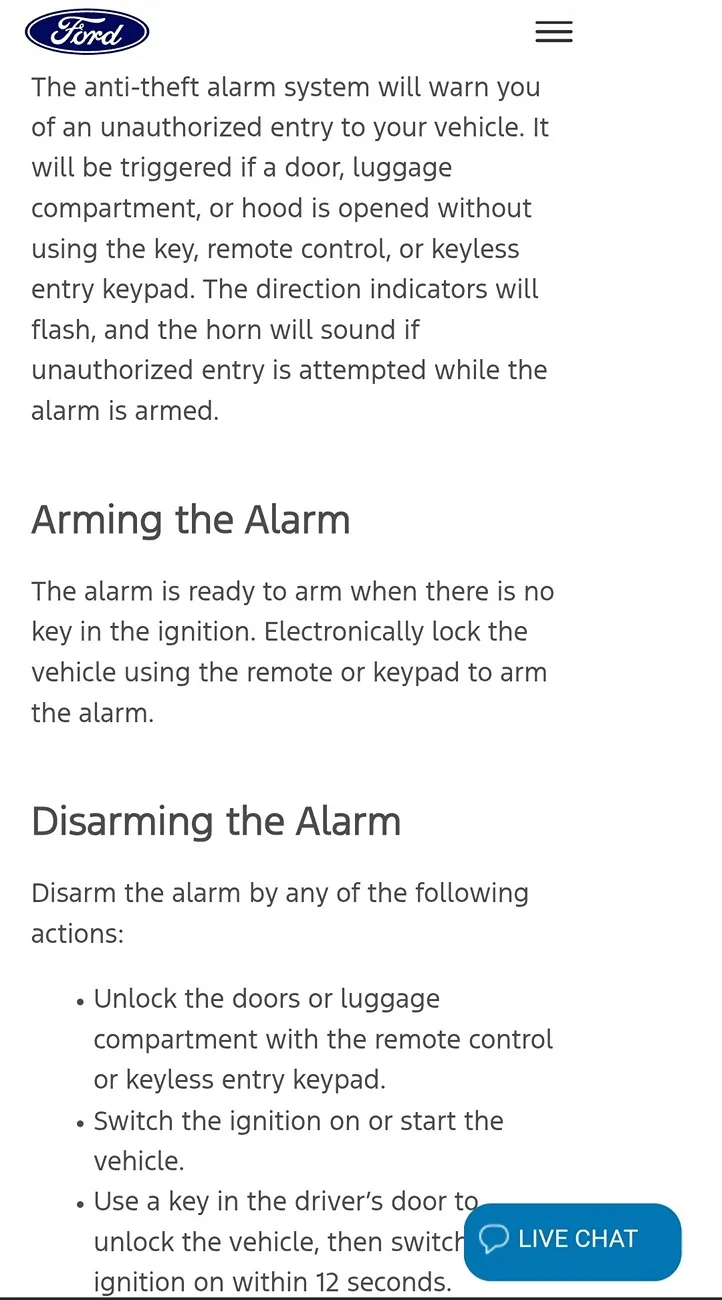

I did a search and couldn't find the answer to this question. It also doesn't seem to be answered in the owners manual. Does my '25 Ranger Raptor come with a security system? If it does, is the security system armed whenever I lock the vehicle?
The reason I ask is if I lock the RR by touching the appropriate place on the door handle, I hear the truck lock, but nothing else happens. If I lock the truck by pressing the lock button on the fob, same thing. However, if I press the lock button on the fob twice, the truck locks, and the horn sounds.
Hope this helps :like:
Ford Ranger Security system question Screenshot_20260122_192326_DuckDuckGo~2

Thanks. I guess it helps, but it seems kind of outdated. “The alarm is ready to be armed when there is no key in the ignition.” Well, there is never a key in the ignition, but I guess this all means that the alarm is armed whenever you lock the vehicle.
I still have a key in my 25. The FOB is your key with push button.. I just always lock mine with FOB twice, honks. I know it's set. :thumbsup:
