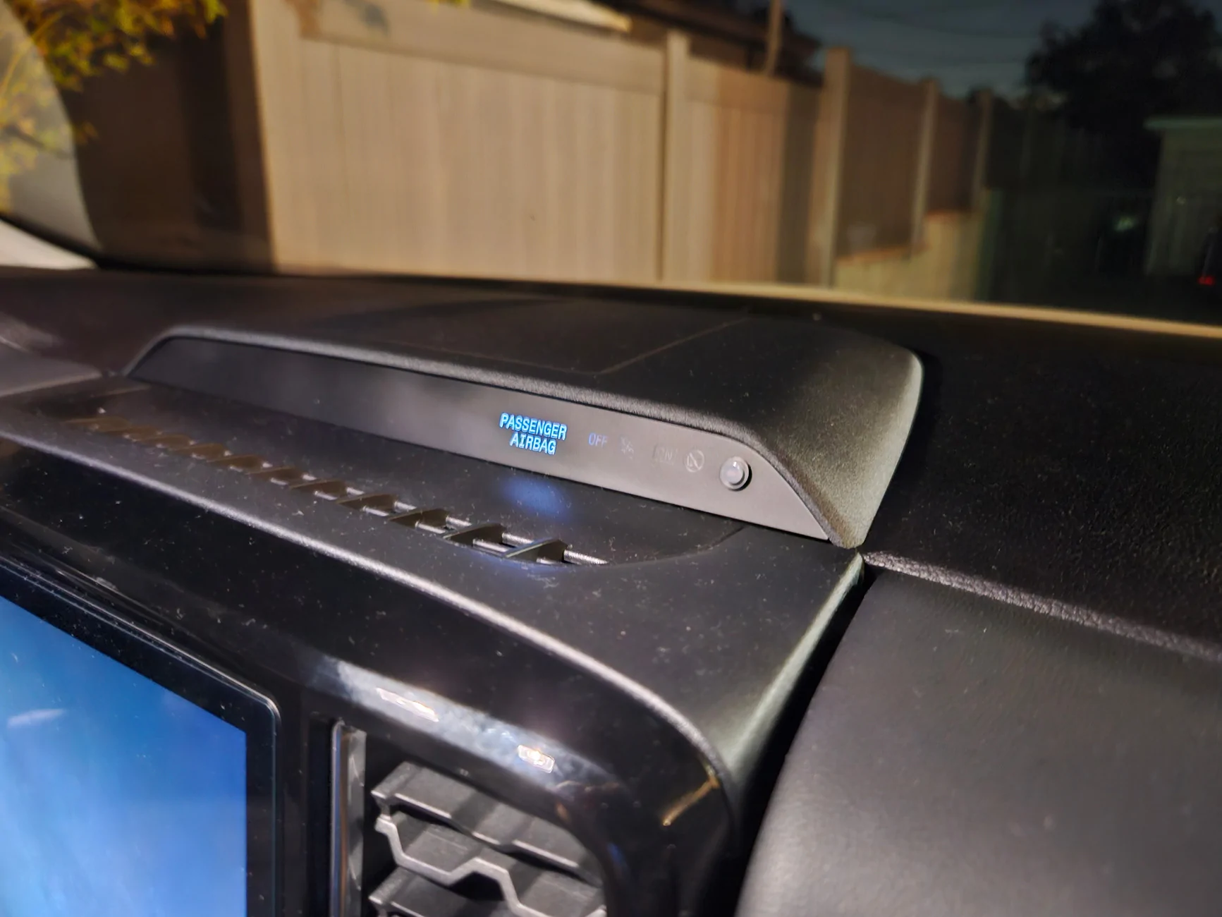

I installed the Ford Perimeter Alarm System. As mentioned earlier, find a good spot to mount it so you can get to it to make sensitivity adjustments. If having it dealer installed, make sure they do not hide it.
I just purchased (arrived on 12/2) the LED Anti-theft flasher (without installation) from Levittown (SAVE50SHIP saves 50% on shipping).
It has been out of stock for months.
I also attempted to purchase this from my dealer without the installation cost and they could not figure out how to. Not sure why FORD requires $70 installation on the LED.
Now I have to figure out where to install the LED flasher (any suggestions/photos?).
