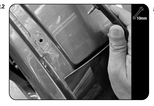

The Ditch Trim holes have to be drilled to fit the 8mm bolt. On the back hole it has a slot. Drilling it larger removed the slot.
This caused the rack to not fit. A day later I used a round file to elongate the back of the rack holes. I was off 1/2 the bolt diameter.
I followed what he did in the video. Did not cut up the Ditch Trim. Mounted rack right on top of it. Much cleaner looking.
You remove the Ditch trim, unscrew the mounting bolts, drill holes out to fit 8mm bolt.
I just used the aluminum spacers that were in the ditch trim.
Hopefully I sealed it up fully. Many layers of trim and spacers.
The rack did not fit squarely at front in Ditch Trim area. It touched the roof.
I used the 1/2" plastic spacer under rack at front. At back I put rack feet right on Ditch trim. Using a 1/2" spacer on top of rack. The 8mm bolt is long. You have to use spacers so it does not stick into air bags.
