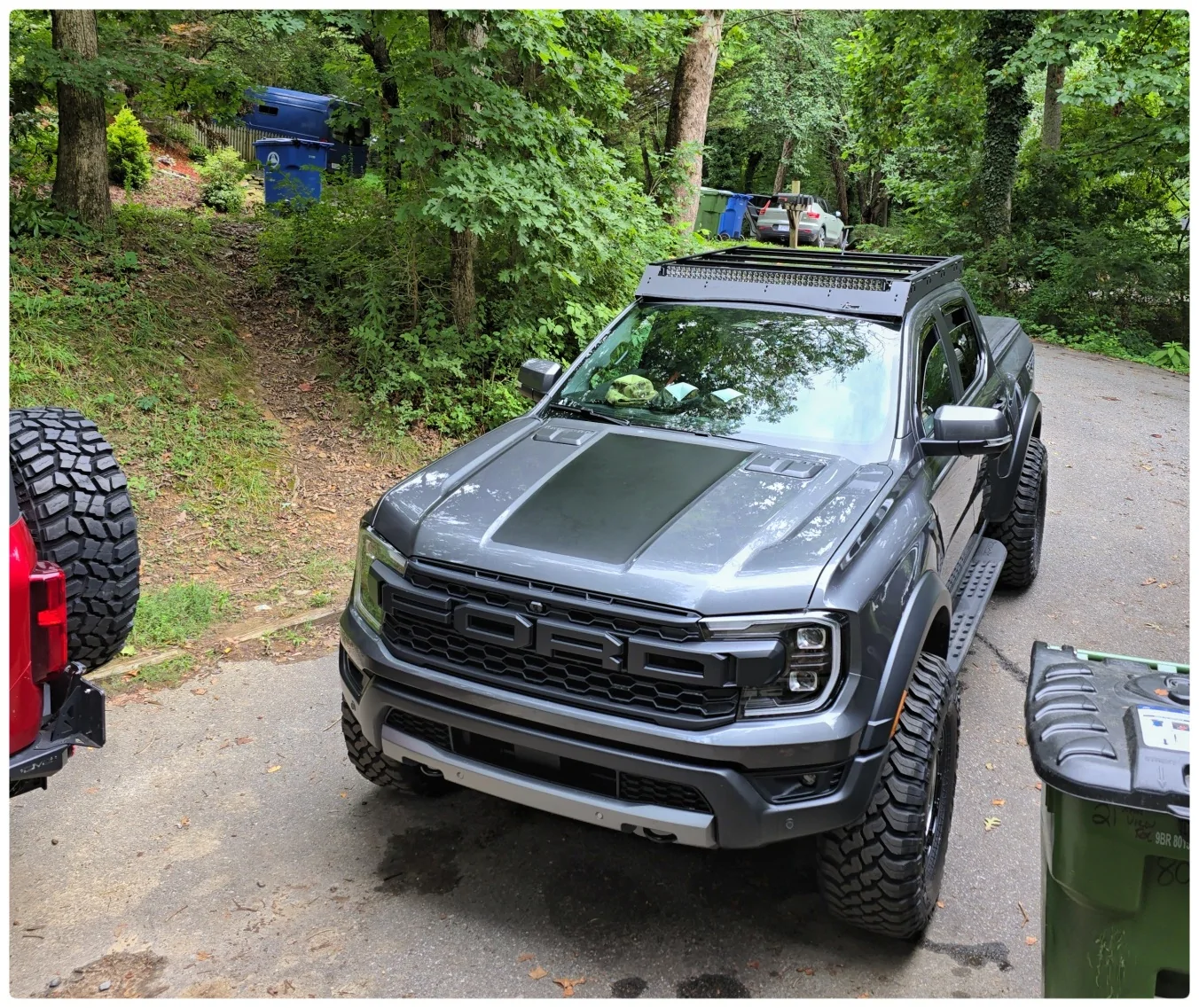

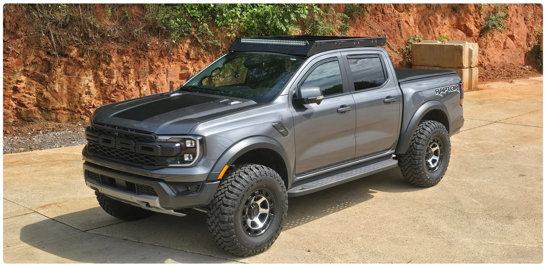

Clean bro, what lightbar is that? It’s pretty low profile
pmontague1968
Peter
Jun 24, 2025
Asheville
It's just the way it's mounted. I used carriage bolts in the track and it sits flush with the top bars. You have to order the rack with the cutout fairing to do it. Otherwise you'd need to mount above the cross bar

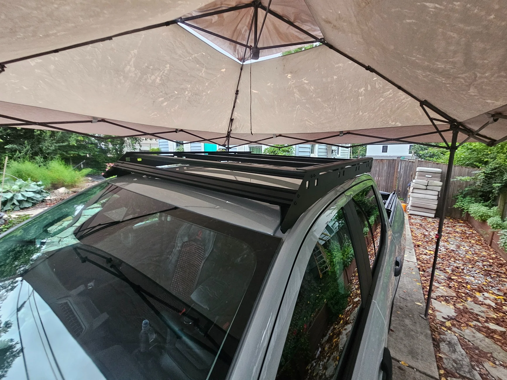

TrailRax Installation & Quality Review
I recently installed the TrailRax system on my truck. While the overall design of the rack is excellent, I was significantly disappointed by the quality control (QC) and the subsequent customer service experience.
Installation Experience
The installation process was time-consuming, totaling about 2.5 hours. The installation video provided was highly helpful, but I strongly recommend having a second person assist. Many steps require two people, and a partner easily makes the job twice as fast.

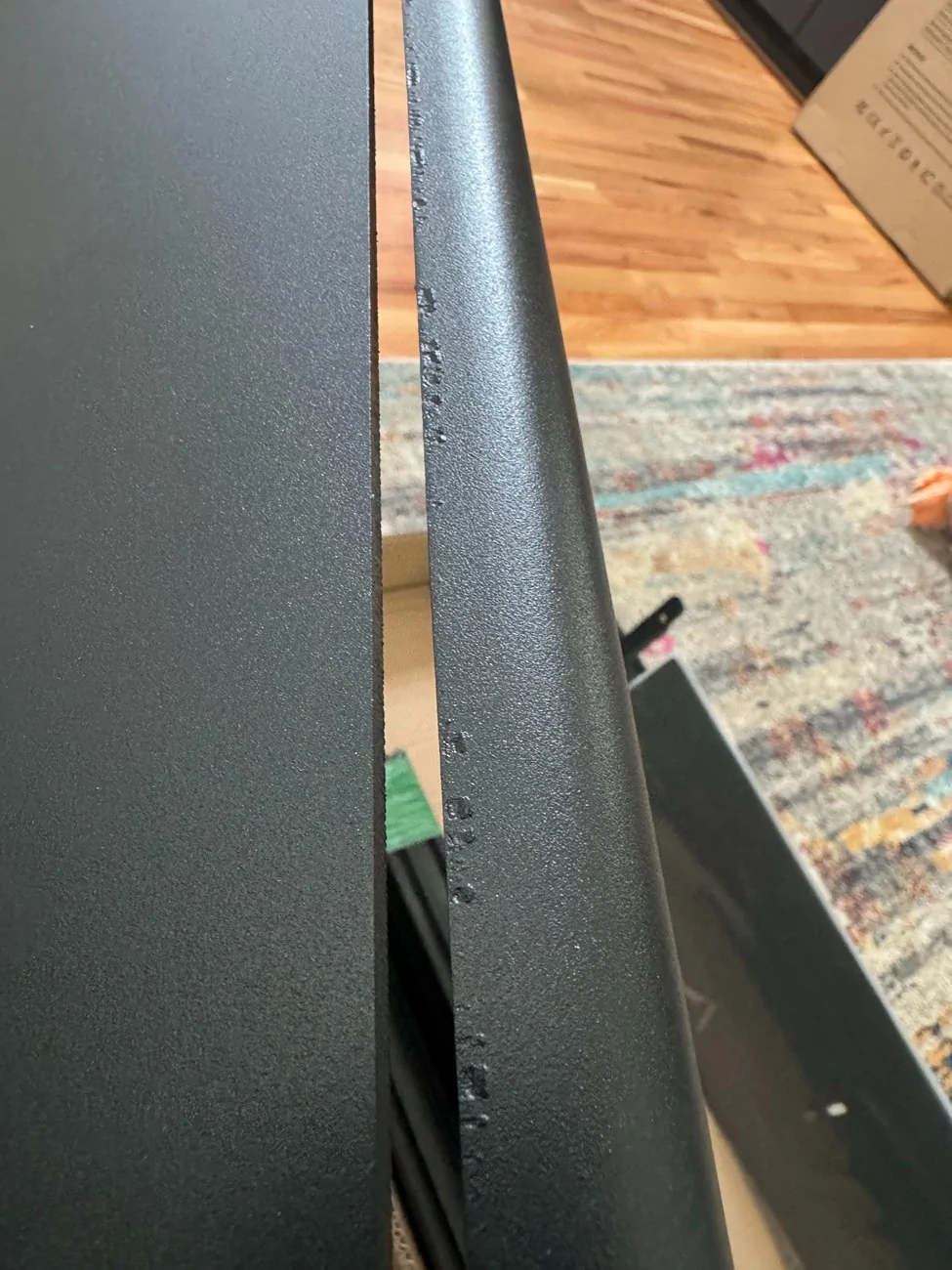

  1. Poor Powder Coating: The powder coat finish on the main parts was inadequate. The coating exhibits a thick, uneven, and bumpy texture, especially along the long cuts, indicating that proper part preparation and application standards were not met. Given my experience, I am not confident this coating will hold up long-term. TrailRax attempted to blame the issue on the component hangers, but this explanation fails to address the widespread, fundamental application defects.

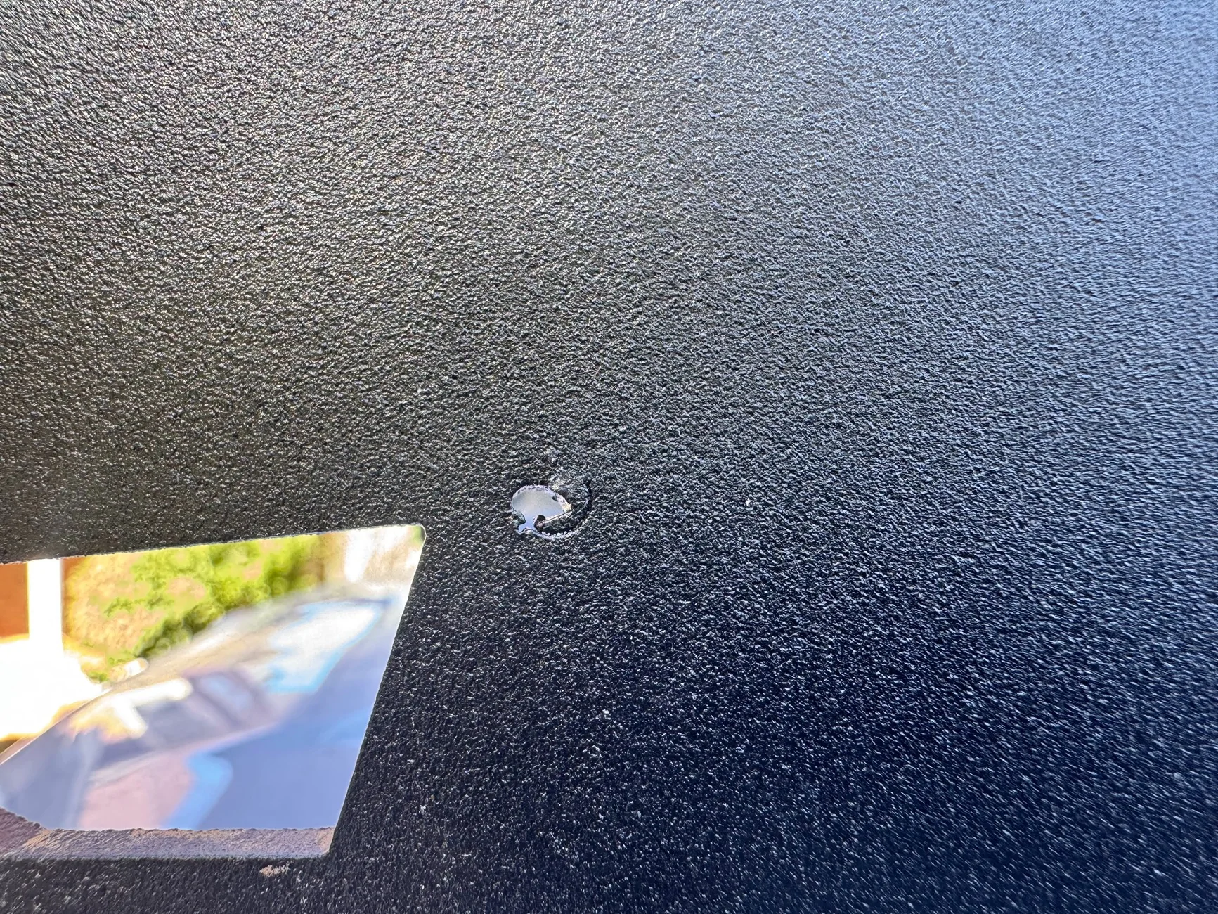

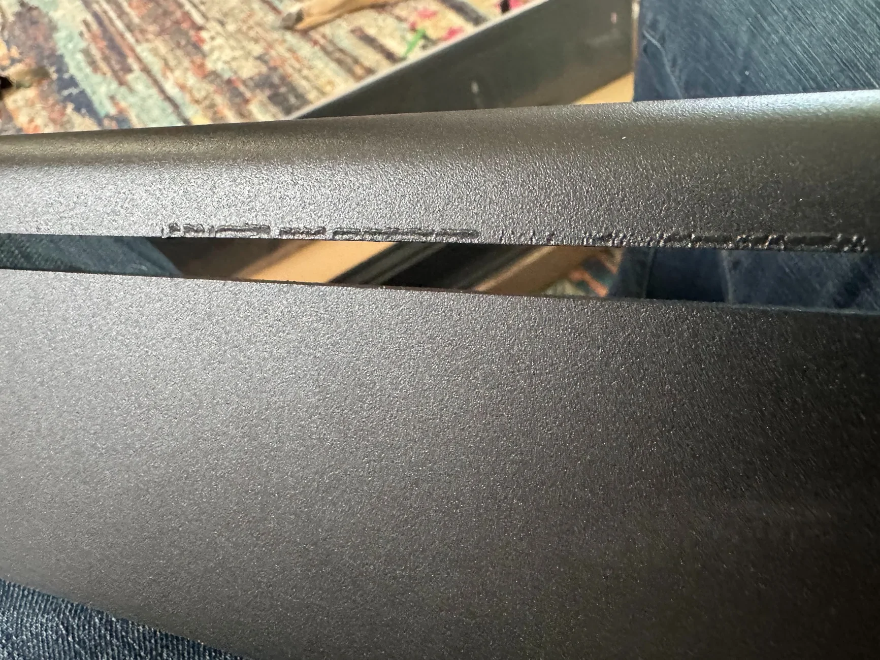

  2. Manufacturing Flaws: Several holes were not properly cut and required me to drill them out myself to complete the assembly (see attached photo). This is a critical manufacturing oversight that should never reach the customer.

Rack installed!

Holes punched with laser but not fully cut :(

Each slit in the rails has a large build up of powder which is raised/bumpy. Concerned this will flake off at some point. Trailtax says this is from hanging the parts (this is true for some other defects) but this isn't the problem here. It looks like either poor application of the powder, or poor part prep before coating. Maybe both.

GordonR, that powder coating looks terrible. OTH many aftermarket manufacturers here and overseas send out their parts to a sub-contractor for powder coating, and so in reality they have zero control over the outcome. But I agree they should have sent you replacements free that look right.

I appreciate the solidarity. It's frustrating when quality control fails at the subcontractor level, but it's worse when the main manufacturer refuses to budget for remediation.
They offered to fix the parts, but only if I paid the return shipping upfront. Since these are large, heavy pieces, I declined unless they provided a prepaid shipping label, which they flat-out refused, alternatively offering to pay for a can of spray paint?
This is the core of the issue: I shouldn't carry any of the remediation costs for a mistake that was 100% within their supply chain control. By refusing a return label, they are simply shifting the cost of their quality control failure onto the customer.
As someone who does my own fabrication, I know issues can happen. However, a reliable manufacturer mitigates this risk (surface prep and find a quality coater) and bakes remediation costs into their pricing. Their policy essentially tells customers to absorb their production errors. Buyer beware I guess — I suspect other racks are similar. I'll likely just blast and recoat this set at my own expense down the line, oh and pick a more customer focussed manufacturer next time.

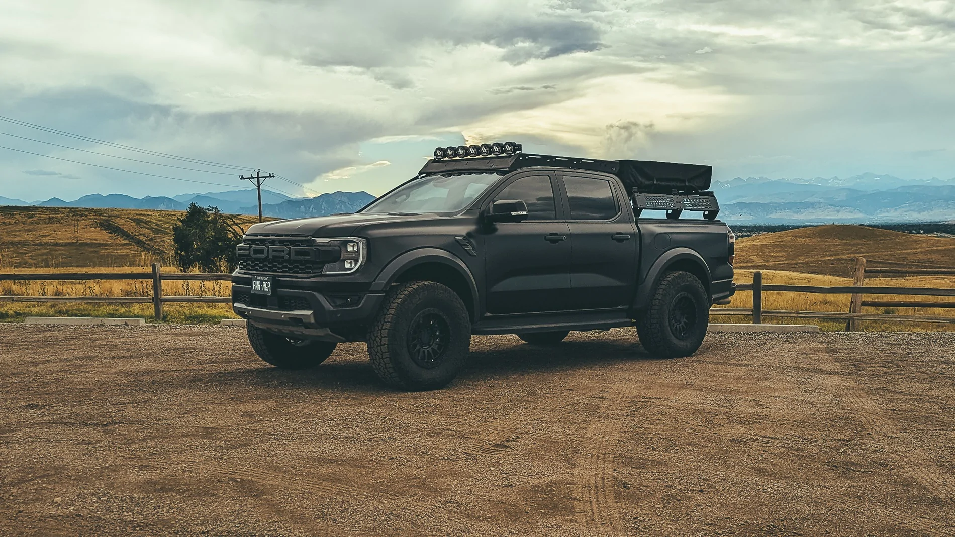

Here is our short list of roof top tent brands we have tried on the Ranger roof rack that we would vouch for. If you would like to build out your ideal with an expert, you can submit a request for a build consultation and we will call you!
1. Intrepid
2. Ikamper
3. Free Spirit
4. 23Zero
