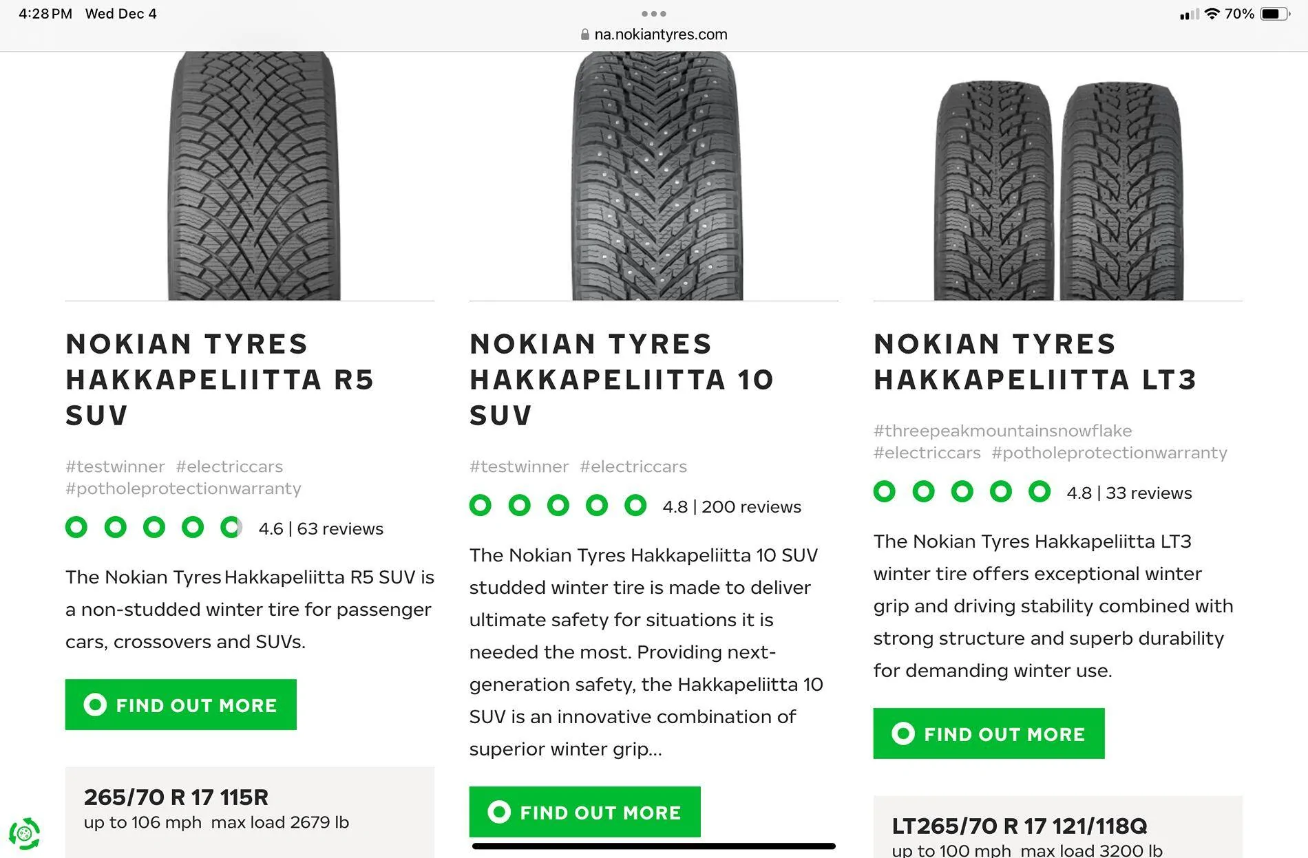

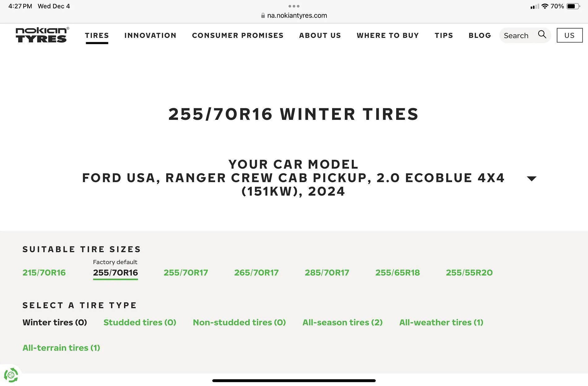

Your 18 inch size is not common for snow tires, I would downsize to 17” factory Ranger or Bronco wheels and TPMS sensors (look for a set of take-offs on Craigslist) and choose your favorite tire. I am a huge Nokian fan, if you get studded Hakkas you will not be disappointed. I would avoid the LT3, it comes in a Load D (8 ply) and is pretty stiff on dry surfaces. Unless you travel heavily loaded all the time, or tow a large trailer, then they would be helpful. I just put a set on my RR and they seem fine, except for that extra stiffness, which is a little objectionable compared to the soft stock KO3 tires (6 ply).
New or takeoff OEM sensors work great on the snow wheels, once the dealer programs them, they will automatically connect each season when you swap them for your other set... I am not sure about aftermarket ones.
My recommendation:
https://na.nokiantyres.com/snow-winter-tires/nokian-tyres-hakkapeliitta-10-suv/

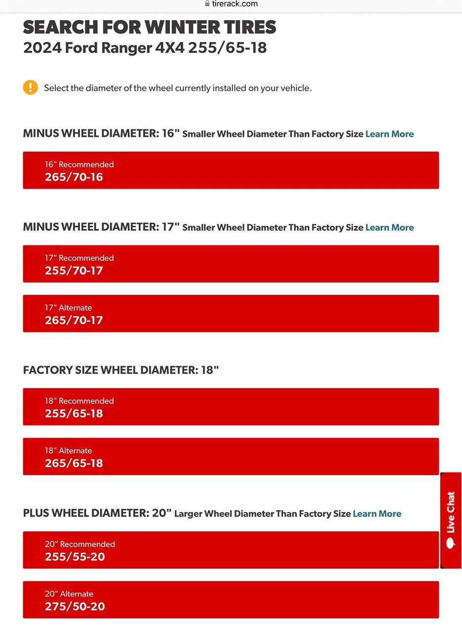

2024 Ranger Lariat - Just went with 265 60 R18 Michelin X-ice. Working beautifully. Anoher advantege with this size is that you don't have the re-adjust the computer. For comparison see - https://tire-calc.com/comparison/265-60-r18-and-255-65-r18-inch/.
I accidentally reversed the chart - my error but the result is still the same in that the tires are interchangable with only 1-MPH difference. Also the lower aspect ratio (60R) is "slightly" better in the snow as it has better traction.

I guess thats where I am lost..you state above you went with 265 60 R18'S...but as my original post stated, " the dealership is stating that "there are only 16's and 17's listed for winter tires, for the Lariat" yet to have 18's on your Lariat...thus my deer in the headlights look.

I understand about the Deer in the headlight issue. The dealer most likely is correct if they only look at their book - but look at the the recommendations from Canada's largest tire Dealer - Canada Tire. They give the option for BOTH the 65R and 60R for the ford Ranger Lariat 4x4. See: https://www.canadiantire.ca/en/cat/automotive/tires-wheels/tires/winter-tires-DC0000417.html. Now enter your specs.
What flavor do you like? Both are acceptable - your choice.
