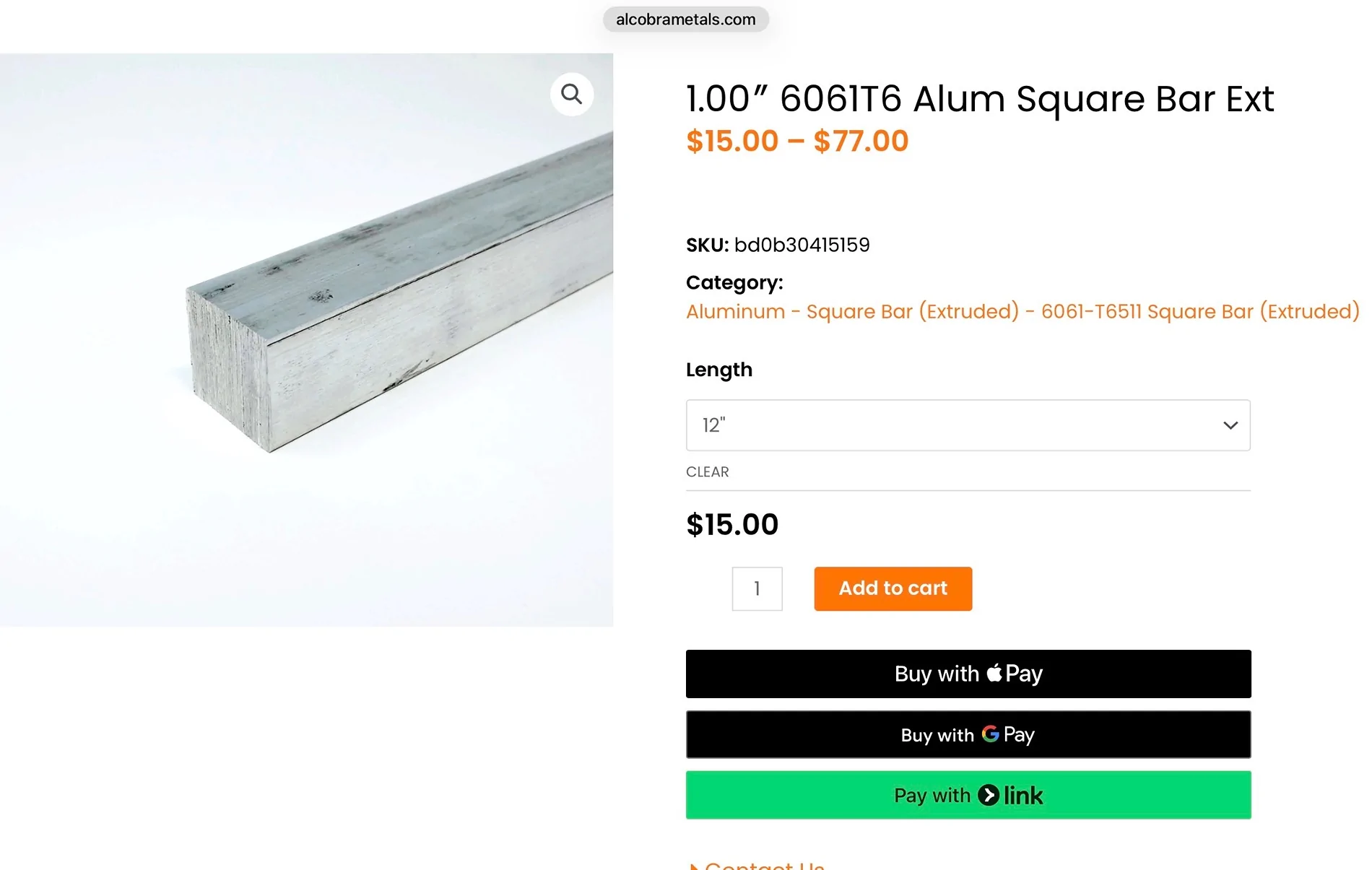

I cut and drilled 2 pairs to use on both front seats to lift the front brackets up from a small aluminum billet, it was quite the hack job to be sure but even ignoring any sloped contouring they are solid and flush front and back. I can check thickness but is was 6-7mm I believe

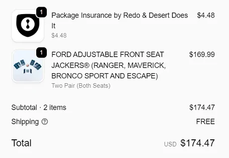

Would like to raise the driver's seat 3/4"-1". Desert Does It says I will need two sets of their seat jackers to do this - $169.99. Seems pretty pricey for a handful of spacers. Any alternatives ?

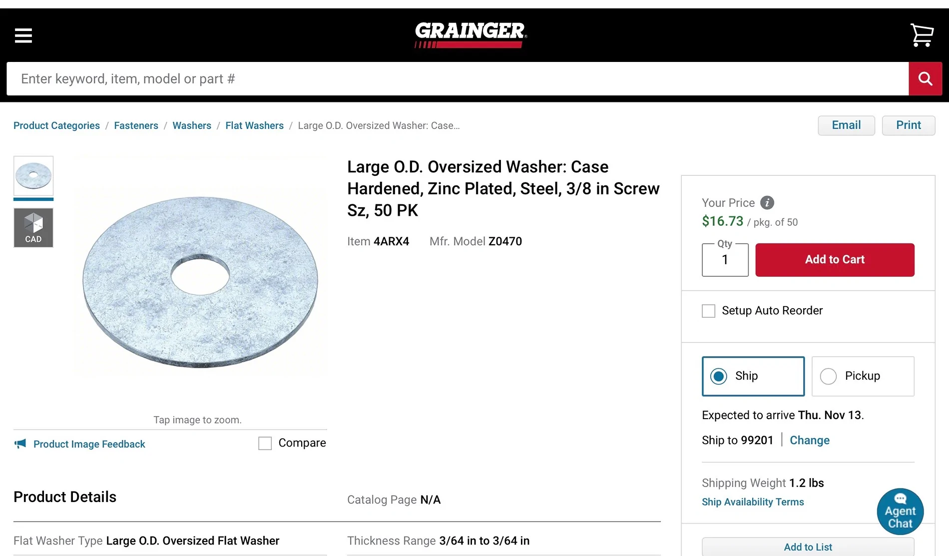

You might be able to unbolt the seat and stack a bunch of relatively wide washers underneath, then bolt it back down. Might need longer bolts. I've never looked at them though.
