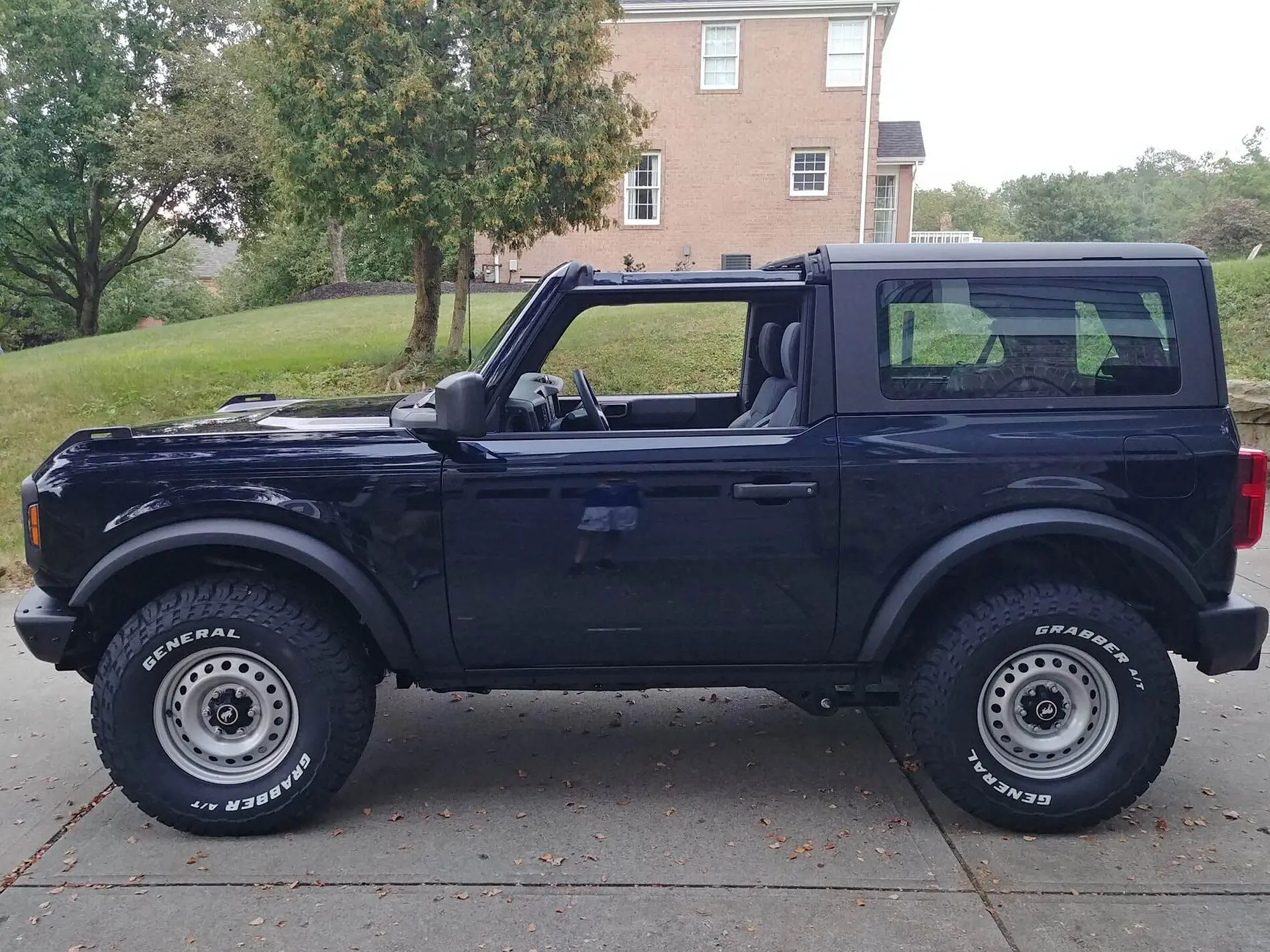

Sorry, the new black steelies make the XL look cheap
