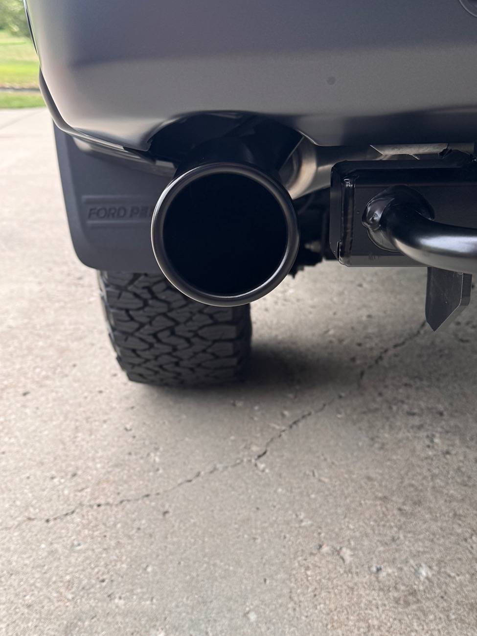

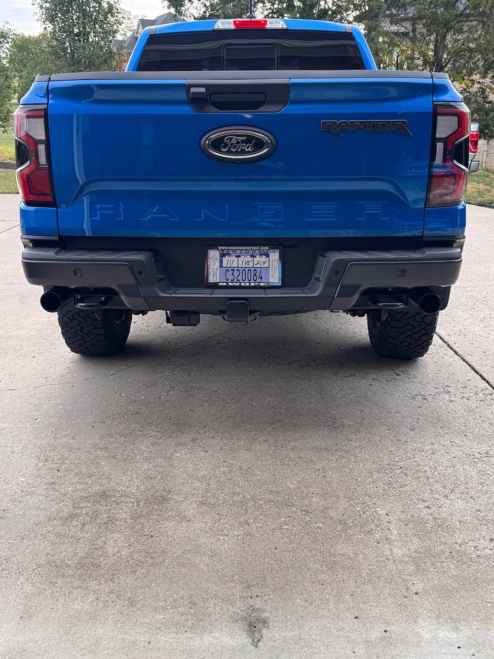

If they hold up, I'll be very happy. Imo they turned out great. That was one of the few things I hated about the truck were the tips, it didn't match anything on the truck. I did some light sanding and 3 coats of vht flame then 3 coats of vht flame clear. Used it on my f150 and 3 years later there isn't a chip so fingers crossed.

How much of the exhaust did you have to remove in order to paint?

I didn't remove it. I removed the two bolts in hangers in the back and that dropped them down enough, I then wedged a piece of wood to hold them in place and hold them down to where I wanted them. I spent about an hour just masking everything off so I got no overspray. Then sprayed away.
