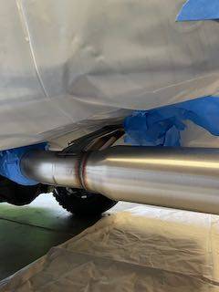

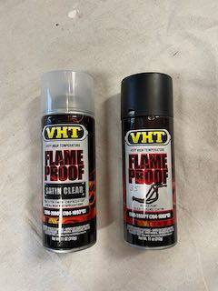

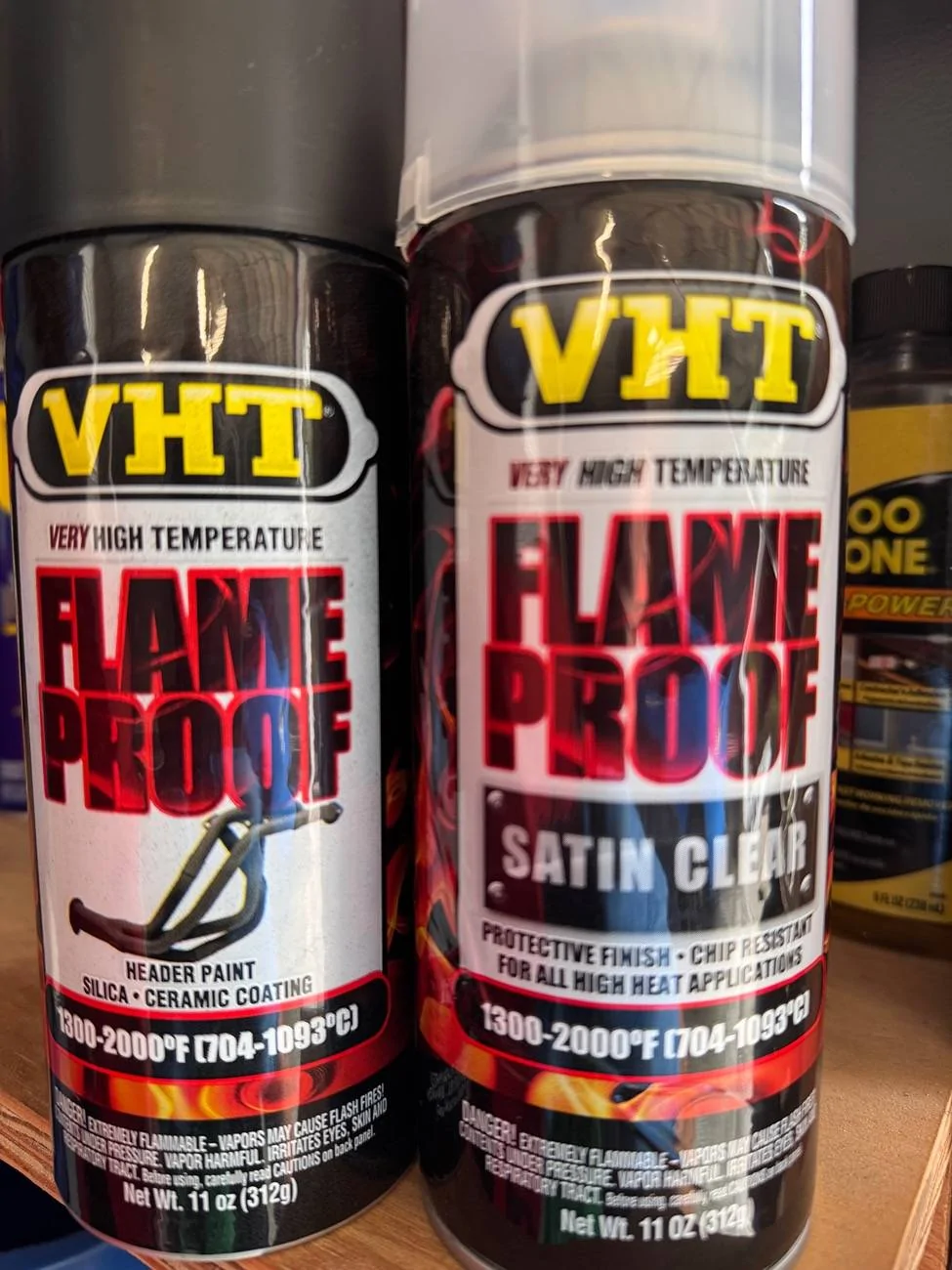

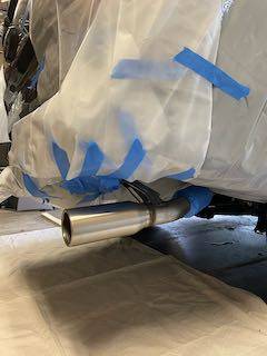

I believe I used 320 grit, but it doesn’t have to be exact. You just need to scratch them up so the paint will adhere. I then blew them off and rubbed them down with alcohol. VHT says to wait 10 minutes in between each coat so that’s what I did and 30 minutes before applying the clearcoat after the final coat of color. The next day, I rubbed them down with zero steel wool and some polishing compound, then followed up with some ceramic coat wax. The whole process only took a couple of hours. The longest part was making sure everything was masked off, and that took probably an hour and a half because I didn’t want any overspray anywhere.

I would definitely mask everything, it looked like more work to unbolt and remove, then when you reinstall it may be hard to get back in without scratching it up. It’s not that bad to mask it off, but I can understand if you wanted to remove as well. Good luck!

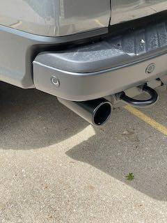

Repeated the process as described and everything turned out perfectly .... but ... watch out for taking that tape off too early. I got impatient and took off the tape and a piece of it touched the right exhaust tip and pulled a small amount of paint off. It's almost impossible to notice, but of course I can't stop kicking myself for taking everything off too soon. I only waited 45 minutes after the last coat. Should have waited a few hours and been more careful.
Really looks great though. Very happy with the final look.

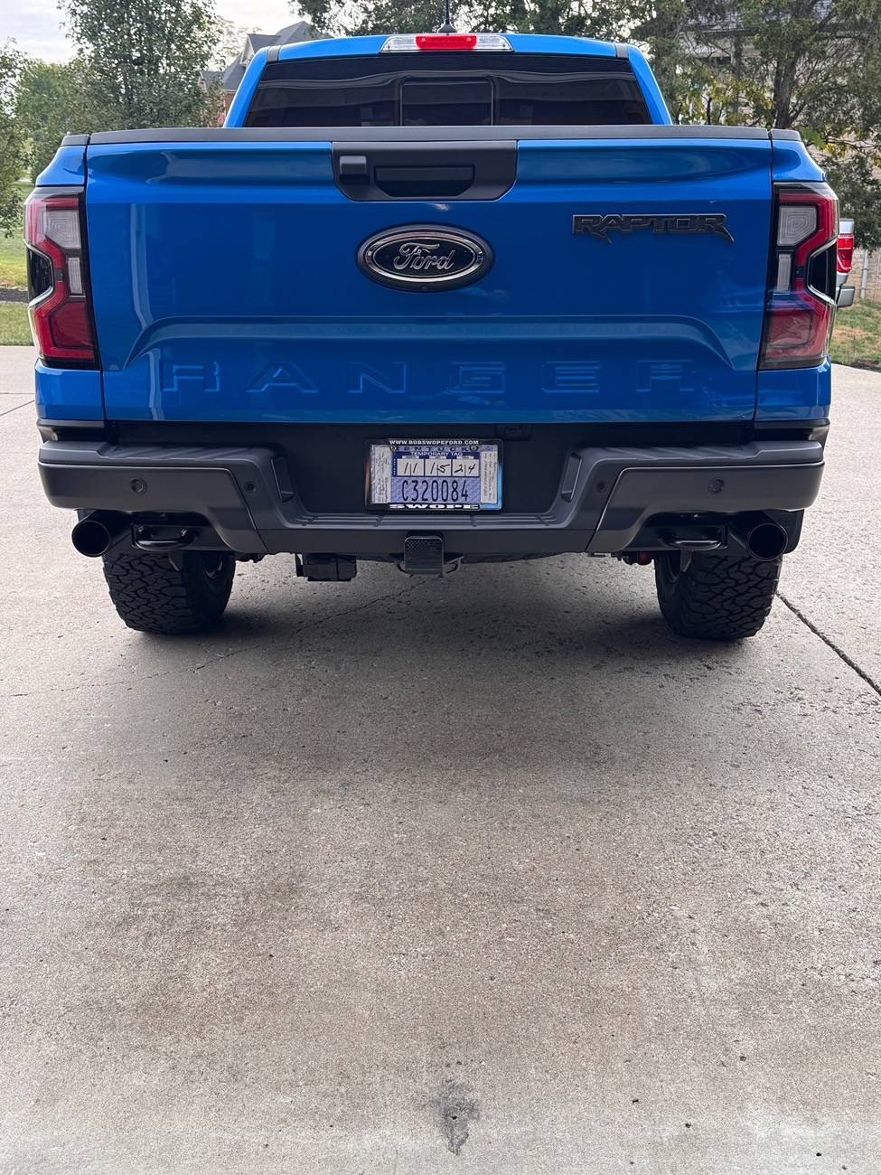

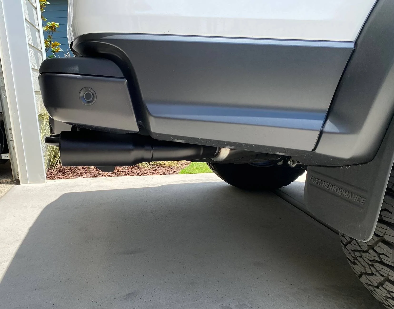

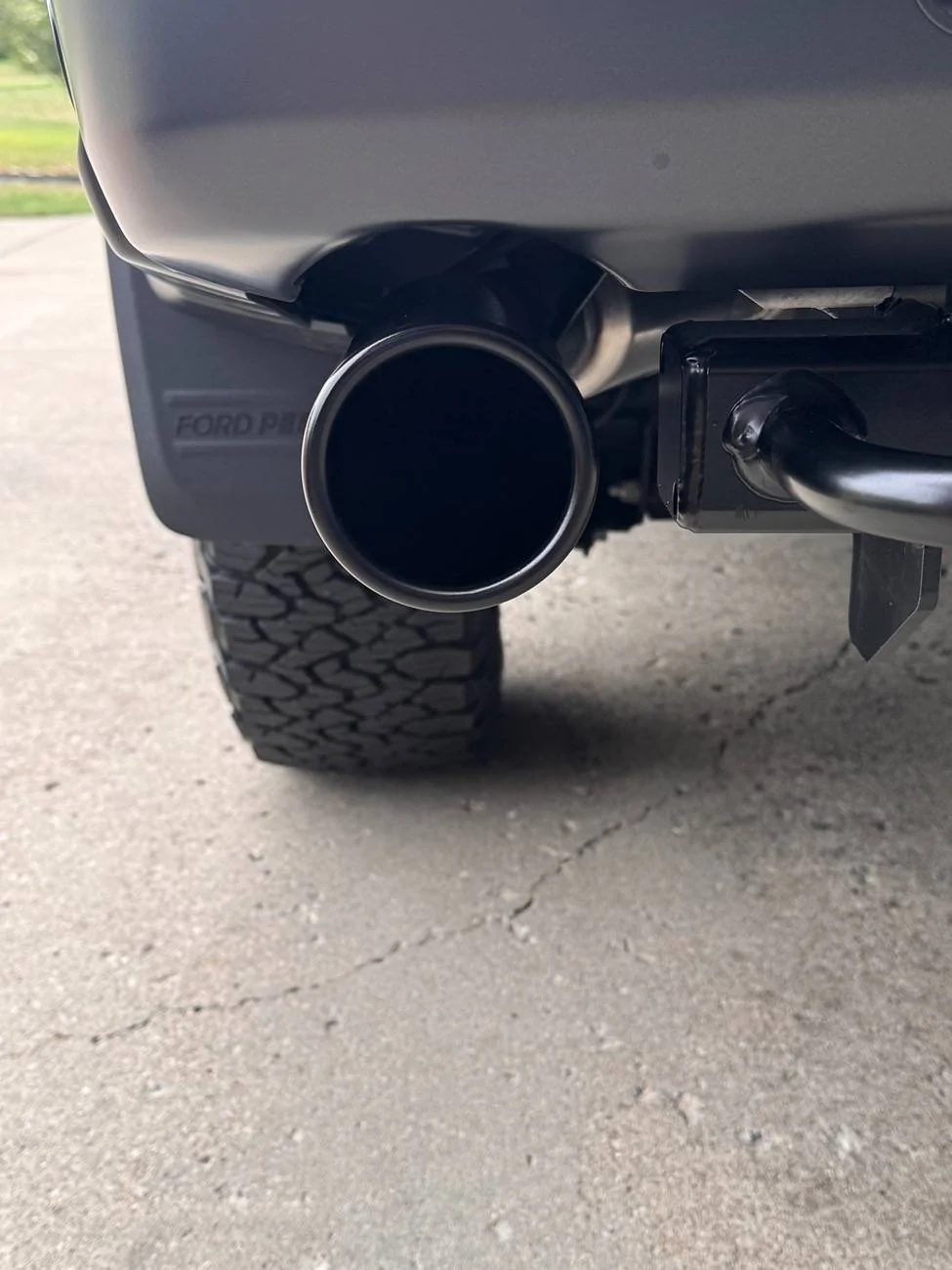

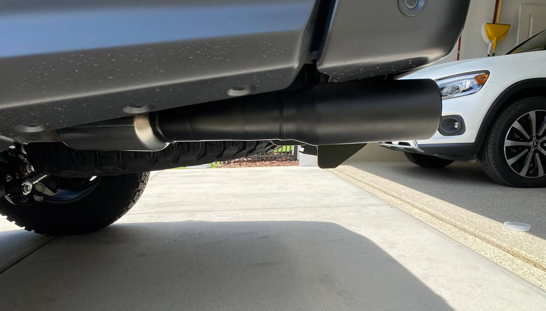

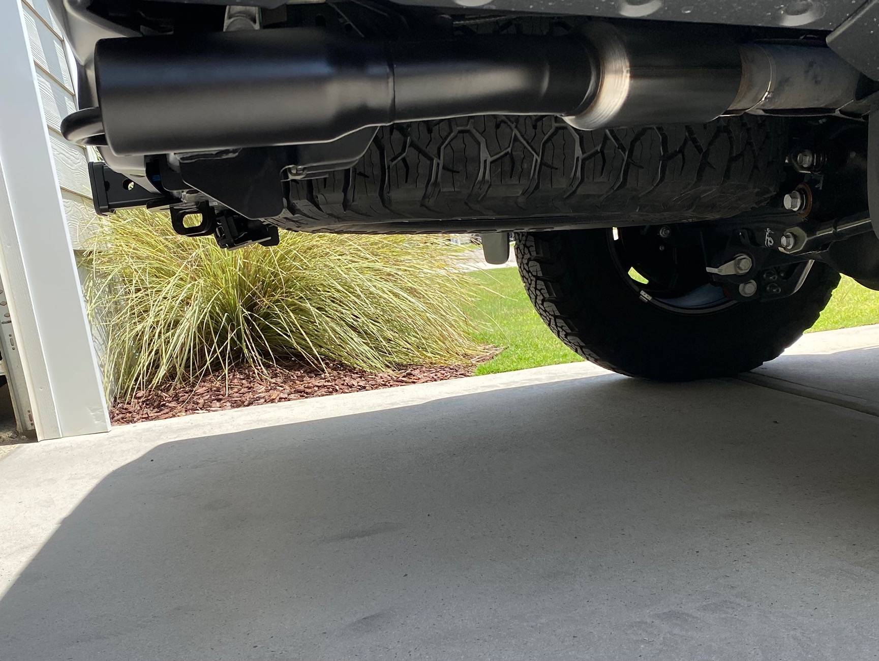

I painted mine today, and I’m extremely pleased with the new look. They look outstanding in black, whole different aesthetic now that they blend with the trim, graphics, bumper, tires, wheels, etc.
I don‘t understand why they are not rolling off the assembly line this way, my previous F-150 Raptor had black tips, looked great.
If you’re on the fence, get off and paint them, you’ll truly be happy with the outcome.
Did you pull the the tips down? I want to paint mine I've just been lazy not wanting to pull the exhaust down.
I did, just unbolted the rear exhaust hangar on each side, easy to do. Then block them in place, small block of wood works.

Exactly as he did it. I’d wait 24 hrs after the last coat of clear before polishing, mine were still a little tacky in the morning.
