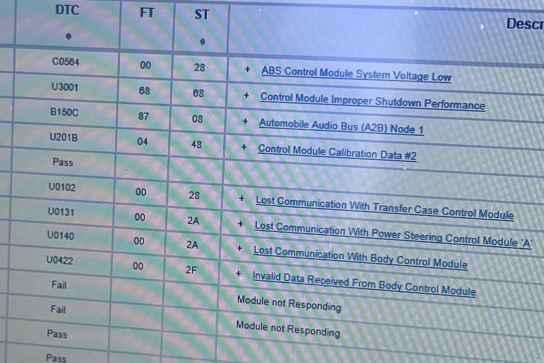

Diagnostic listed below with codes. Looks like the BCM is not communicating.
Try clearing all codes, see if that changes anything.
