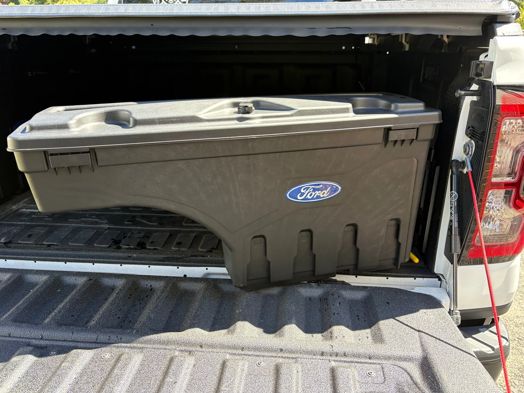

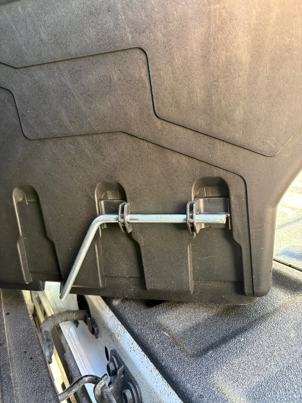

Installed these boxes both sides. One marked left went in right side, one marked right went in left side. 🤷🏼‍♂️ As with other installers, I had to trim about 1/16th of an inch off of release rod so they would release. For the cost we shouldn’t have to do so. (Ford tech)

Installed Left one in my 2024 Ranger Raptor. Not trimming needed.
