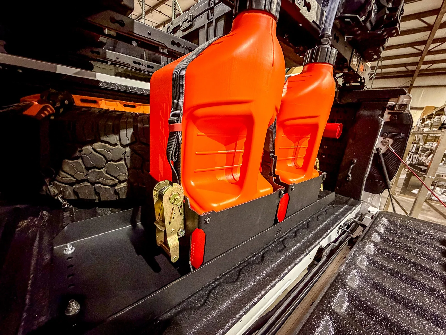

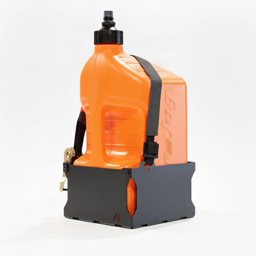

I will be developing a bracket to attach our new 10" Fuel Jug Mount directly to our MOLLE panels for the Ranger. The bracket will be sort of an "adapter" to exactly locate the jug for the Ranger. It will mount the jug touching the floor of the bed. No drilling required.
10" Fuel Jug Mount - https://americanadventurelab.com/product/10-inch-fuel-jug-mount/

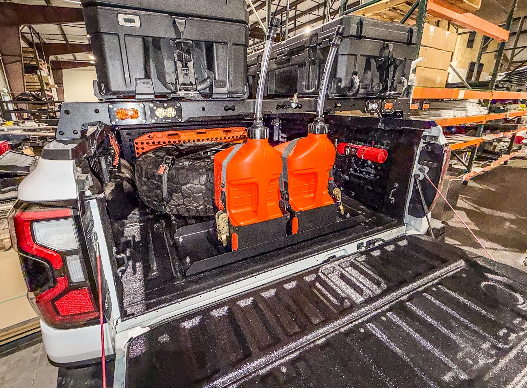

Here's a shot of the Ranger (@Baja_RR) bed setup we put together last week for this same situation (EXO trips in Baja). These are mounted right at the rear of the truck for easy access. I would prefer to have them against the cab, but the other cargo prevented that in this setup.

Keep in mind that there is a two-stage flap system in the Ranger fill tube. So, whatever spout it has on it will need to be about 5-6" long, and fairly small (smaller diameter than the spout on the Tuff Jug), to get past the second flap. The Safety Siphon would work well out of the box.
We will probably develop (or locate) a longer spot to use with the Tuff Jugs. Those are really nice jugs and empty very quickly, so we're probably going to start bundling them with our mounts.

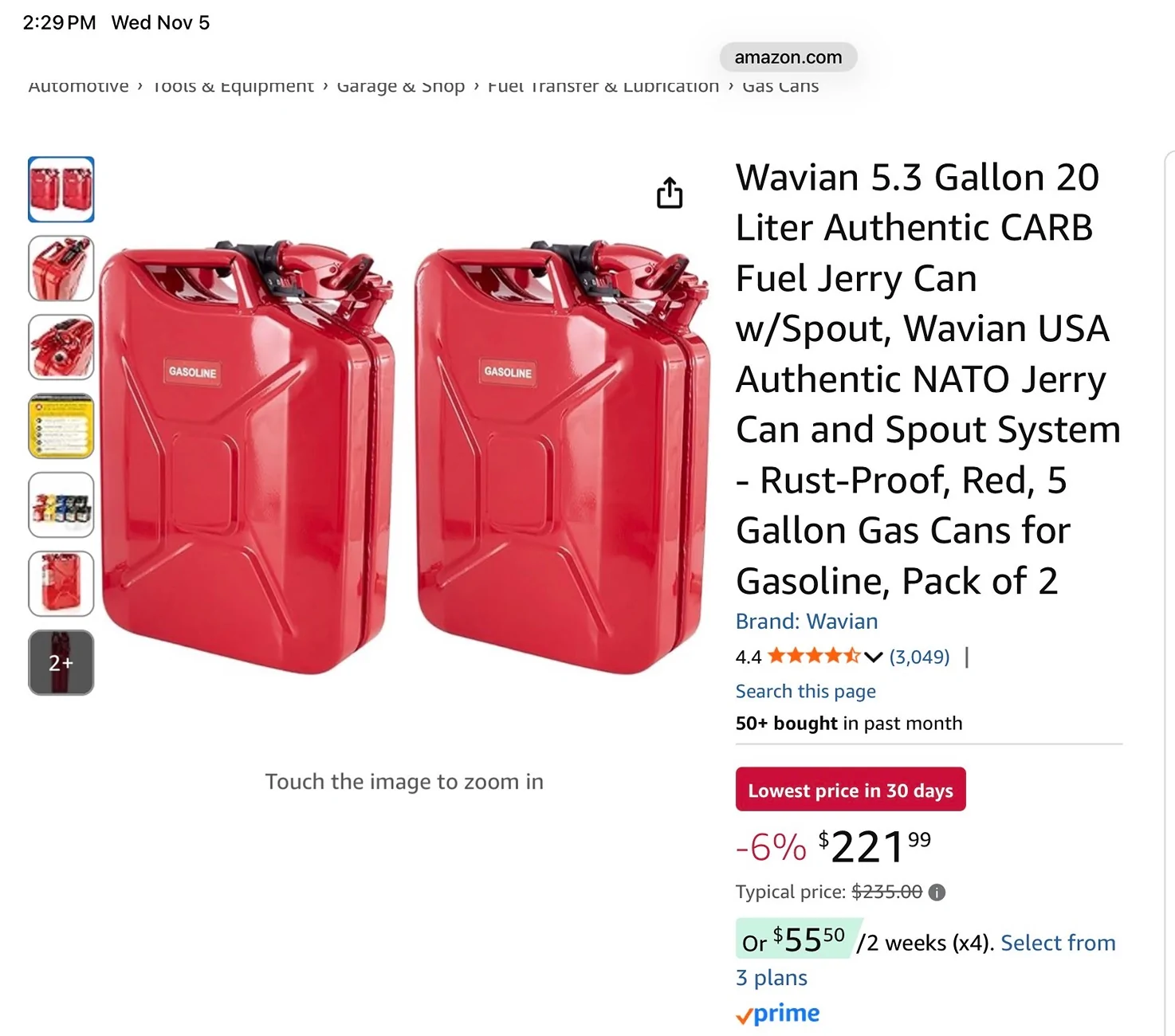

What’s wrong with tried and true steel NATO cans? They are way better than anything made of plastic, I used to carry two big cans when I was driving a very thirsty Series 80 and later an LC 200, I got rid of those and now I sometimes carry a single 2.6 gallon one for emergency use, and I have never actually needed that.
Wavian 5.3 Gallon 20 Liter Authentic CARB Fuel Jerry Can w/Spout, Wavian USA Authentic NATO Jerry Can and Spout System - Rust-Proof, Red, 5 Gallon Gas Cans for Gasoline, Pack of 2
These never leak or stink, and can be carried in any position, even flat.
