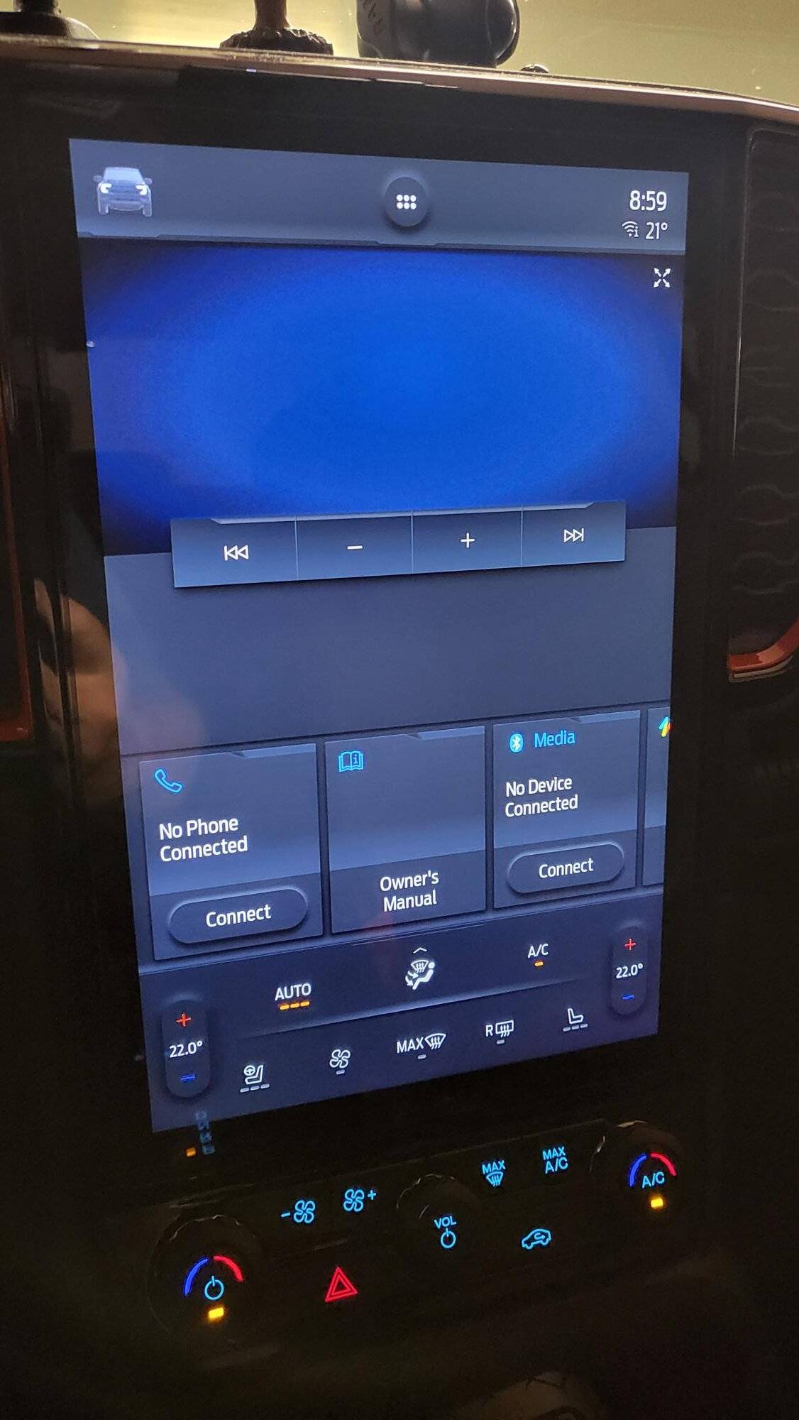

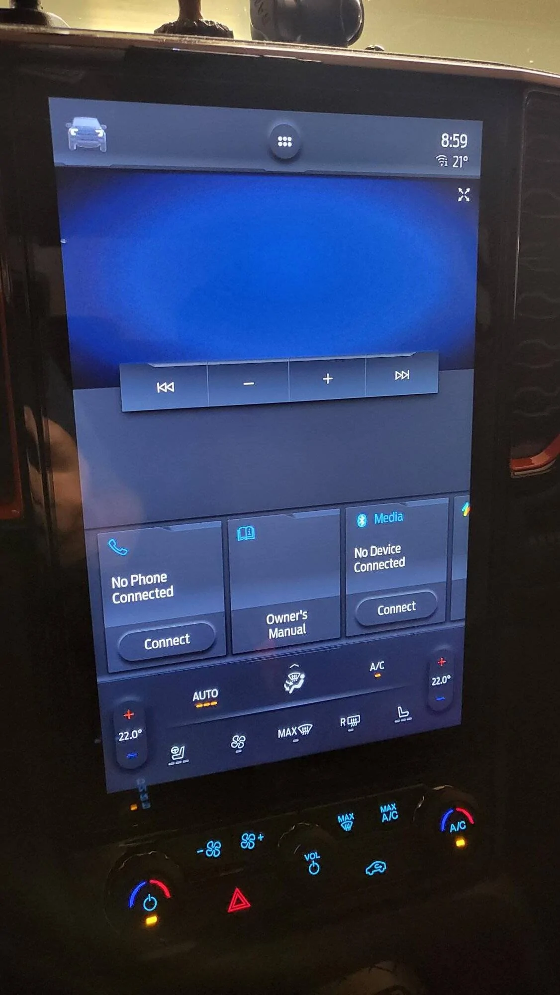

Not sure if some others have experienced also the Freezing up of the 12" sync Screen?
My Ford dealer is trying to pin the issue down - no luck so far - but we are on it.
Randomly the Screen Freezes up and the Off road features like Trail assist , Locking / unlocking of the Differentials can not be accessed / operated anymore.
One has to turn the engine off, lock the door and wait at least 5 minutes - normally it works after this routine.
Sometimes not and you have to get a coffee or something else to get the time passed.
Amusement with the Rubicon drivers is guaranteed.
Hope we find a solution soon :)
Anyone similar issue?

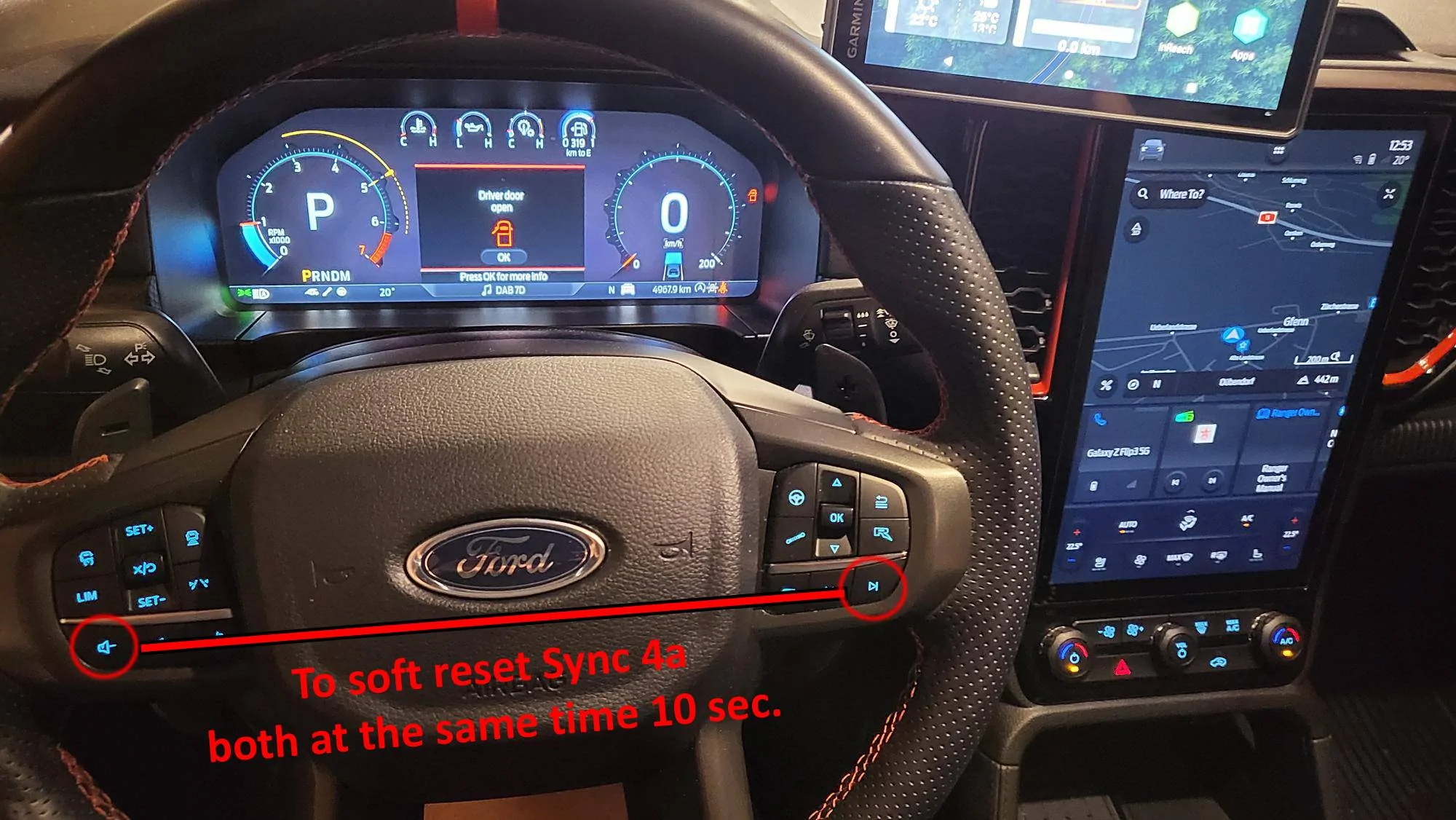

BTW. did anyone figure out how "soft reset" this Sync 4a 12" unit ?

Quick Update - to soft reset your Sync4a 12"
And apparently we will get OTA Update of Sync 4 here in Europe in the next 2 Months. At least i was told how to soft reset in the meantime. Lets wait and see if the Update will fix it.
