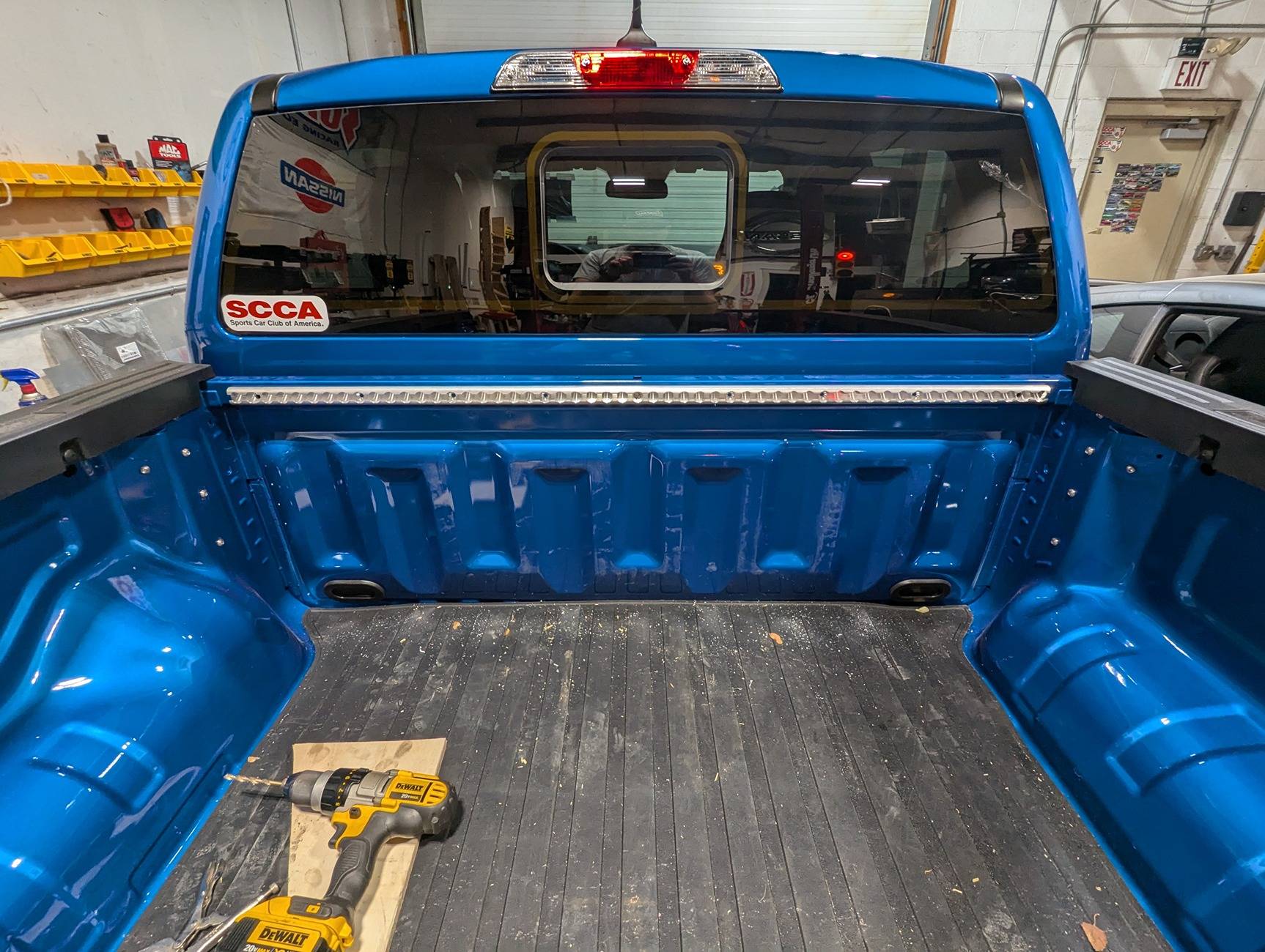

Thanks for the video. I've been looking at the same kit and this has sold me on it.
For the bulkhead I made a custom piece of L-Track that cover the holes. I didn't think to put any gasket material behind mine, but I may pull it off and place some behind it now that you mention it.
(Picture is from the test fit and drill process before I had it Line-X'd)

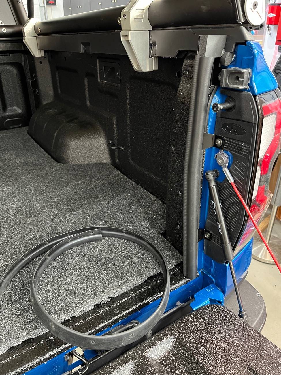

I got hung up on my installation, my first order was lost in Germany for a month, Chris sent me a replacement way quick.

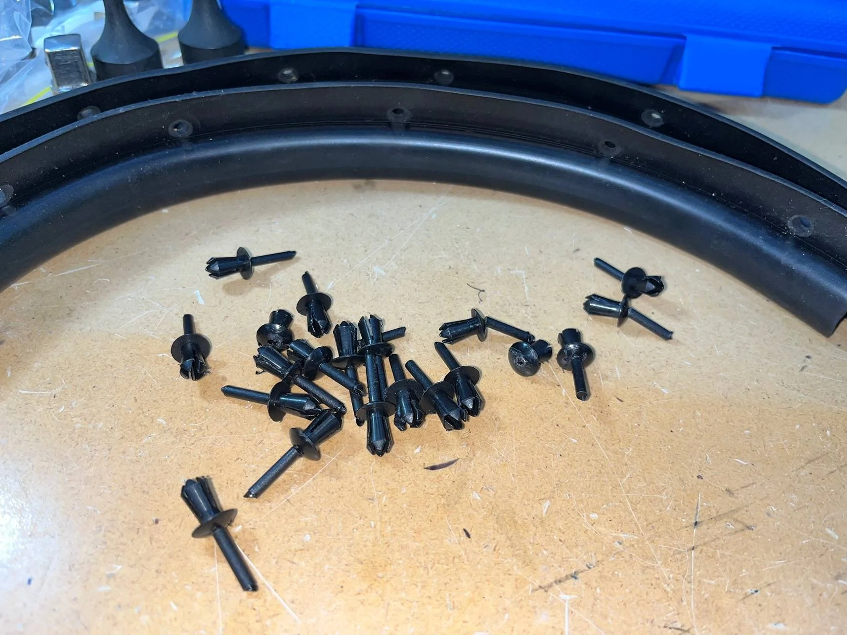

I can't figure out the stupid plastic rivets, NONE of my pins will push in, they just bend and snap off. This is very frustrating. I would prefer a more standardized type of push pun, but it has to have a really small diameter head, because the holes in the rubber strip are right next to the bulb. Any suggestions? Preferably from an online source in bulk.
Alternatively I would install 5mm steel threaded inserts and use machine screws, if I could figure out how to get the tailgate off. That remains a mystery.
Ford Ranger Tailgate Seal by Digital Twin Development - install video IMG_8768
Ford Ranger Tailgate Seal by Digital Twin Development - install video IMG_8770
FYI, the rubber seals in this kit are not "USA standard". they are just about impossible to find here in this exact size. OTH, the D seals can be replaced with a smaller size, and they won't wear out, because they are trapped between the brackets and the side of the bed. The other push-on seal, which is very vulnerable to damage, MIGHT work with a smaller replacement, I haven't tried it. If you are carrying rough cargo with the tailgate open, I suggest you just pull those two bulb seals off, so they don't get damaged.
Any help with the rivets would be appreciated. I am still waiting for Part 2 of the install video...

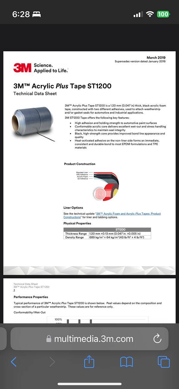

I decided to screw the 19 dinky rivets, I am going to use a rubber strip across the gap, the bed side will be covered by my Bedrug Classic.
ESI Rok Block XL for Ranger
If I have to glue down a loose edge every now and then, it will be far easier than a bulb seal that has finicky fasteners. Plus a bulb seal collects sand and gravel which can damage the painted surfaces and hinge. I will start a brand new thread after installing it.
FYI they use a super tape which should perform well if applied correctly with 25 pounds force and moderate room temperature.
ALSO FYI, 3M VHB tapes are excellent, but you have to be sure that you get the genuine product, there are many counterfeits out there, some even say 3M, some just say M… LOL, at least the latter is easy to spot.

That's how they are supposed to work. The pins get snapped off and then you push them through, after de-burring both the pin and the hole. Read my tip above and keep the pins with the rivet that you took if off of so it will fit correctly.
