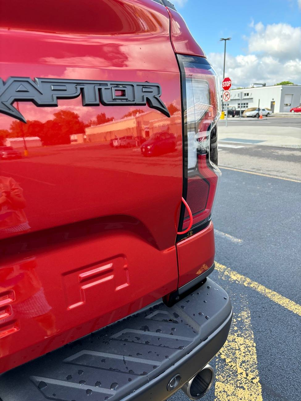

Every 5-6 closes of the tailgate results in this cable being exposed like this. Any ideas on how I can eliminate this from happening?

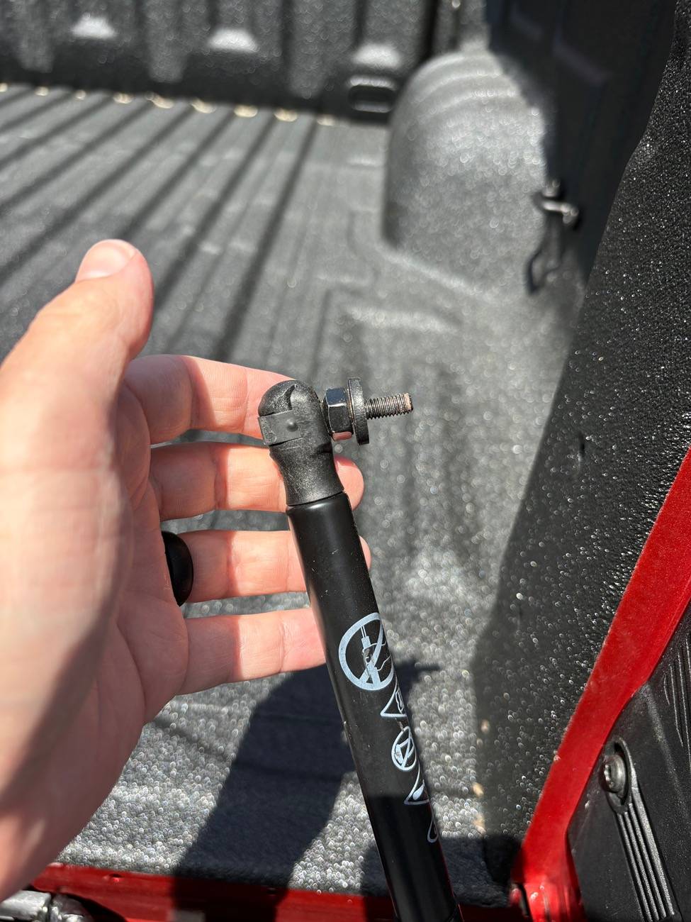

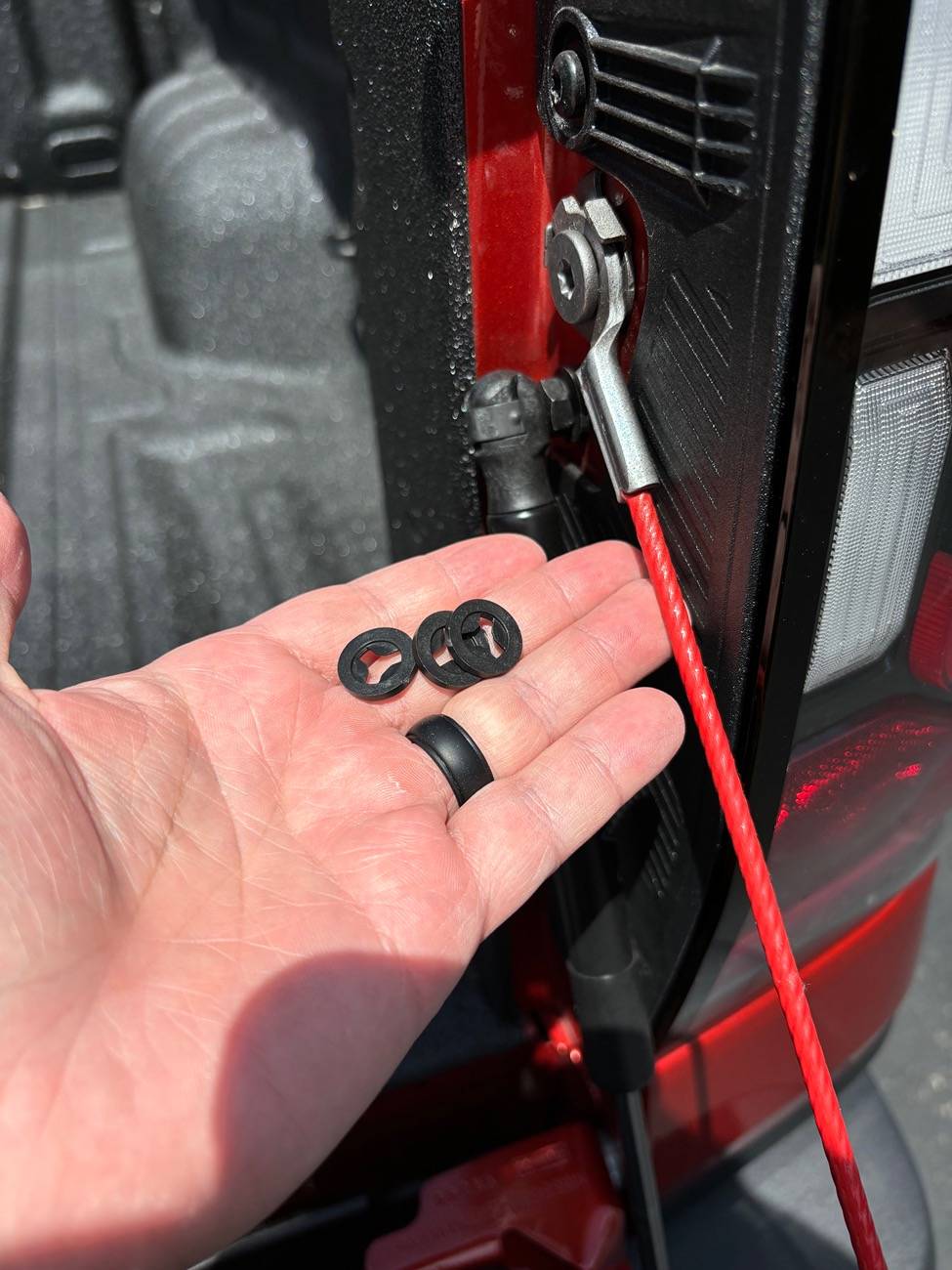

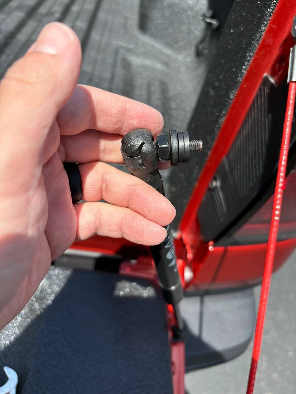

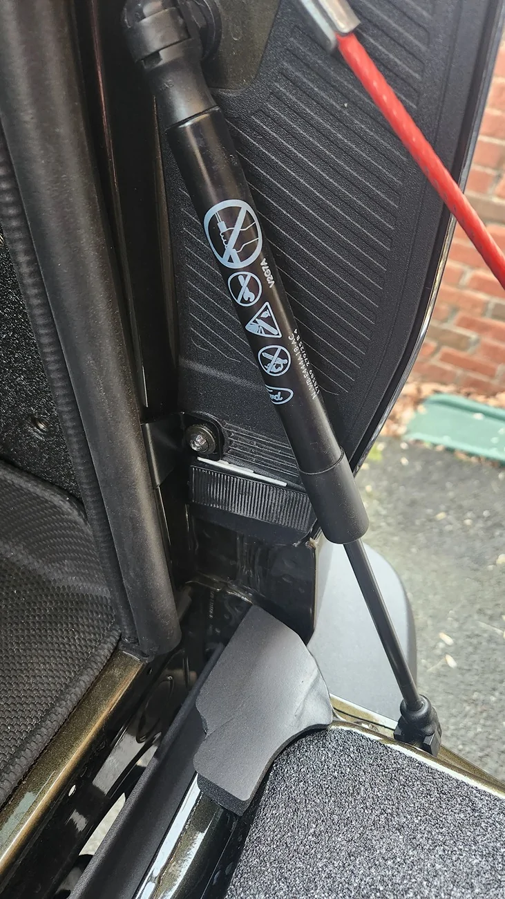

Solved! Thanks for the suggestion in the thread here. I had several bags of excess materials from mounting tvs and found spacers that were the perfect size. Two of these pushed the dampener over just enough so the cable isn’t getting caught anymore.

Brillant fix! I started having this issue and I was so focused on resolving it by doing something to the cable hardware, I didn't even think doing something to the damper. Thanks!

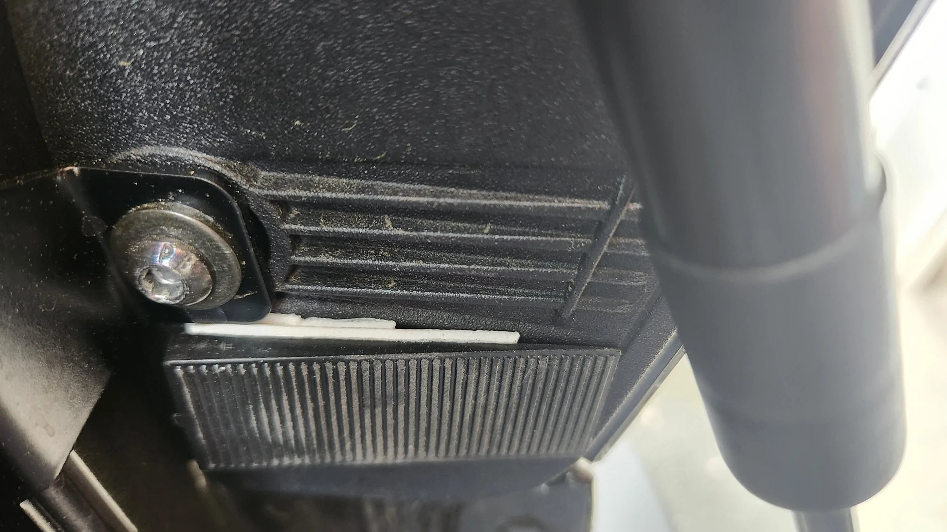

TTT. Nice! Been having the same problem and found this thread buried in the search. I just placed a shim on the bed side which worked pretty well. (Temporary to see if it worked...Don't beat me up for the install! LOL) But I'll try spacing the strut as shown. Thanks!
