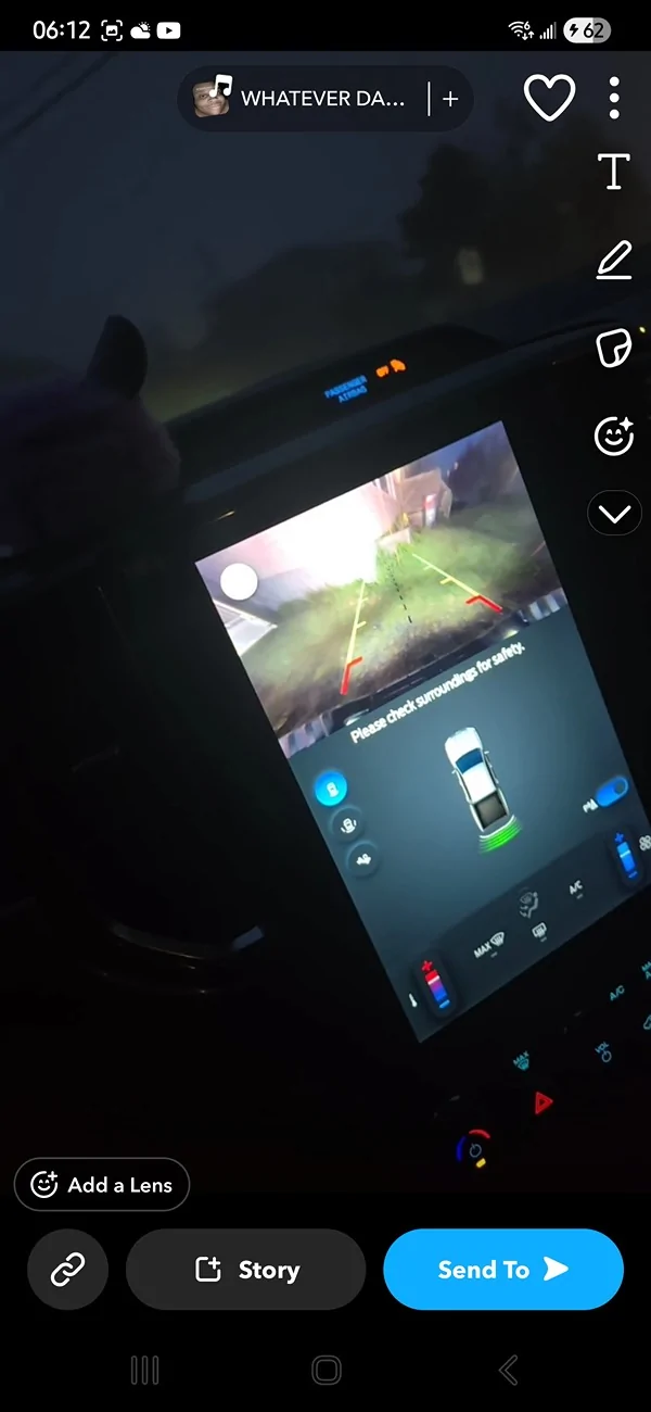

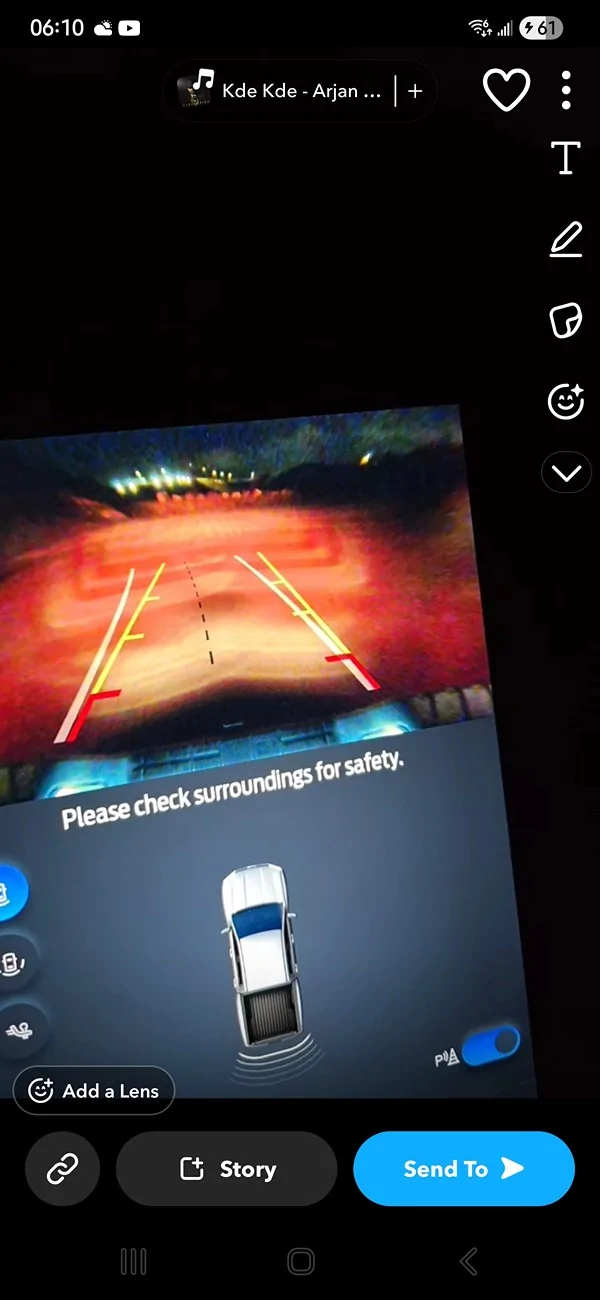

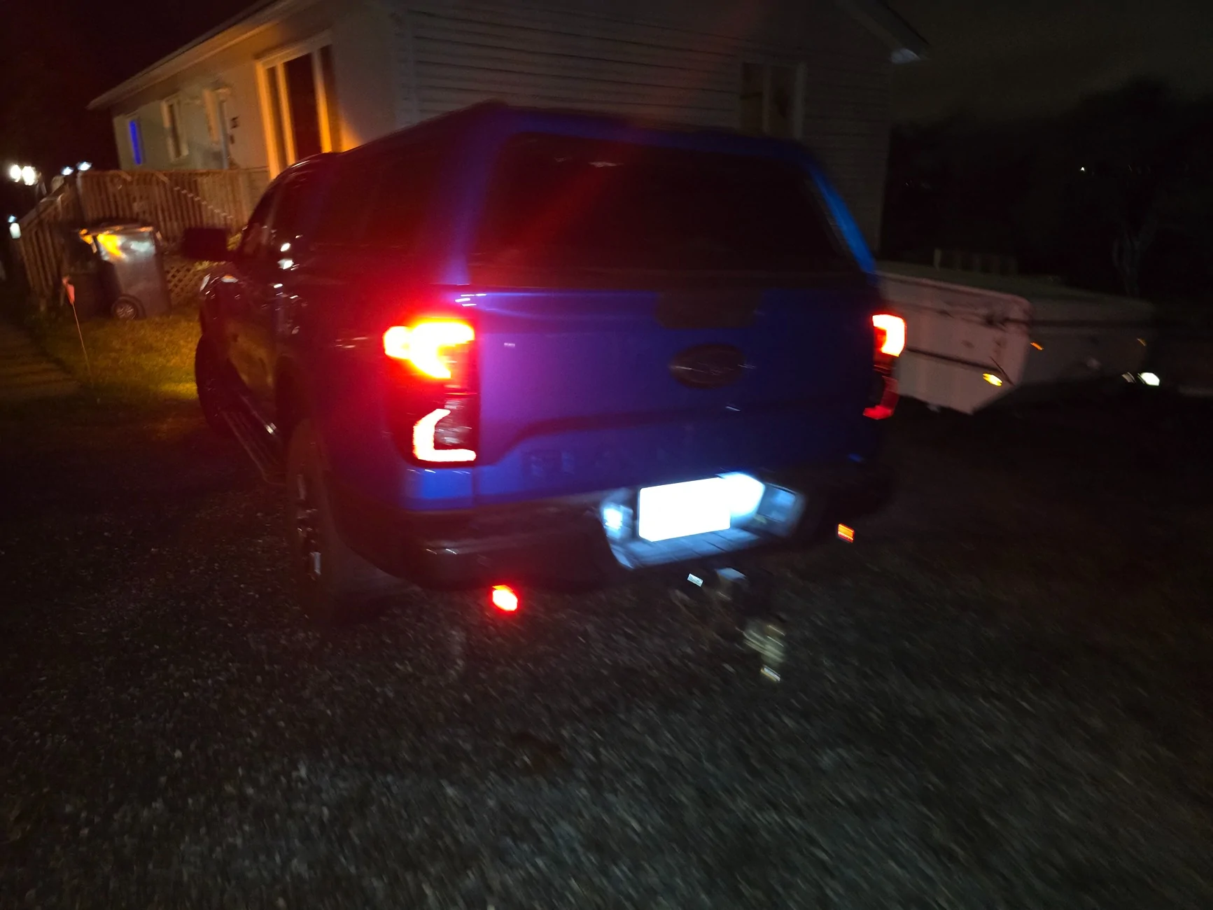

Added Diode Dynamics reverse lights. was a majors improvement over the oem halogens. the brakes use to overpower the reverse. then I had a set of DD C1R's off my old rig, I added under the bumper canted off on an angle to help backing with my trailer down my inlaws driveway, I got reverse lights on trailer, but a couple times I got the back of the truck too close to the trees while focusing on the trailer. so the c1rs give me width. and the drop in bulbs give me the distance rearwards.
Ford Ranger Taillight Lighting for Back-up Camera at Night Screenshot_20260114_061021_Snapchat
Ford Ranger Taillight Lighting for Back-up Camera at Night Screenshot_20260114_061203_Snapchat
Ford Ranger Taillight Lighting for Back-up Camera at Night 20250822_092233
Ford Ranger Taillight Lighting for Back-up Camera at Night 20250822_092217
Ford Ranger Taillight Lighting for Back-up Camera at Night 20250830_230445
