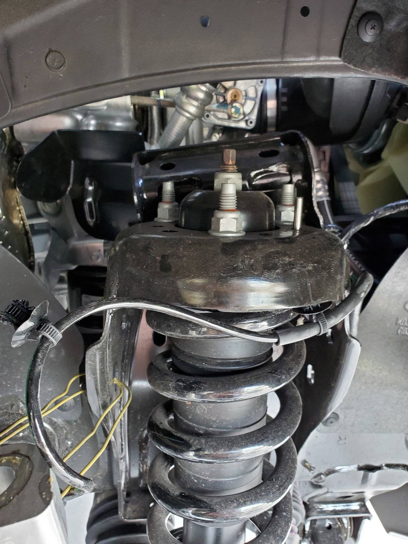

I did my right (passenger) side yesterday. Going to football game today, so I'll do the left side tomorrow. I can say I had absolutely no problem removing and installing the long UCA bolt. Hopefully it will be the same on the driver's side. On the right side there is a heat shield behind the UCA but it can be easily bent back with your finger. You can see the heat shield to the back side of the top of the shock tower in the picture below. My biggest problem with the install was getting the original shocks out, and I only have 500 miles on my truck. I'll post a write up and pics in a few days.
