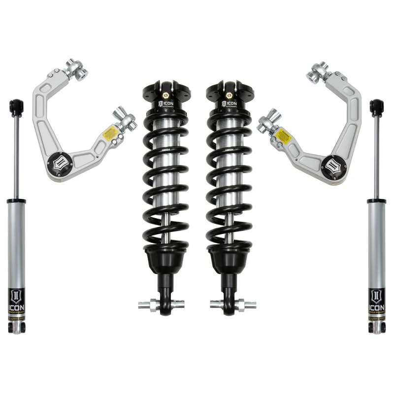

Icon and Camburg sell UCAs with covers for the Delta Joints and Ball Joints. Icon’s more expensive billet aluminum UCAs for the Ranger (and all other vehicles) have Delta Joints and include covers. Not only do they include them, but they’re bolted on and include a gasket. I guess Icon is saying the grease seal helps prevent issues, but the billet UCAs have the same grease seal and covers...
Ford Ranger The Weekend Warrior 2019-up-ford-ranger-0-35-suspension-system-stage2-billet
The new Delta Joints are redesigned ans sealed. Here is Icon's description: http://www.iconvehicledynamics.com/deltajoint/ The type of arm makes no difference, both the billet and tubular use the same new joint. I'm picking them yp in the morning, so I'll post some pics before the install.
