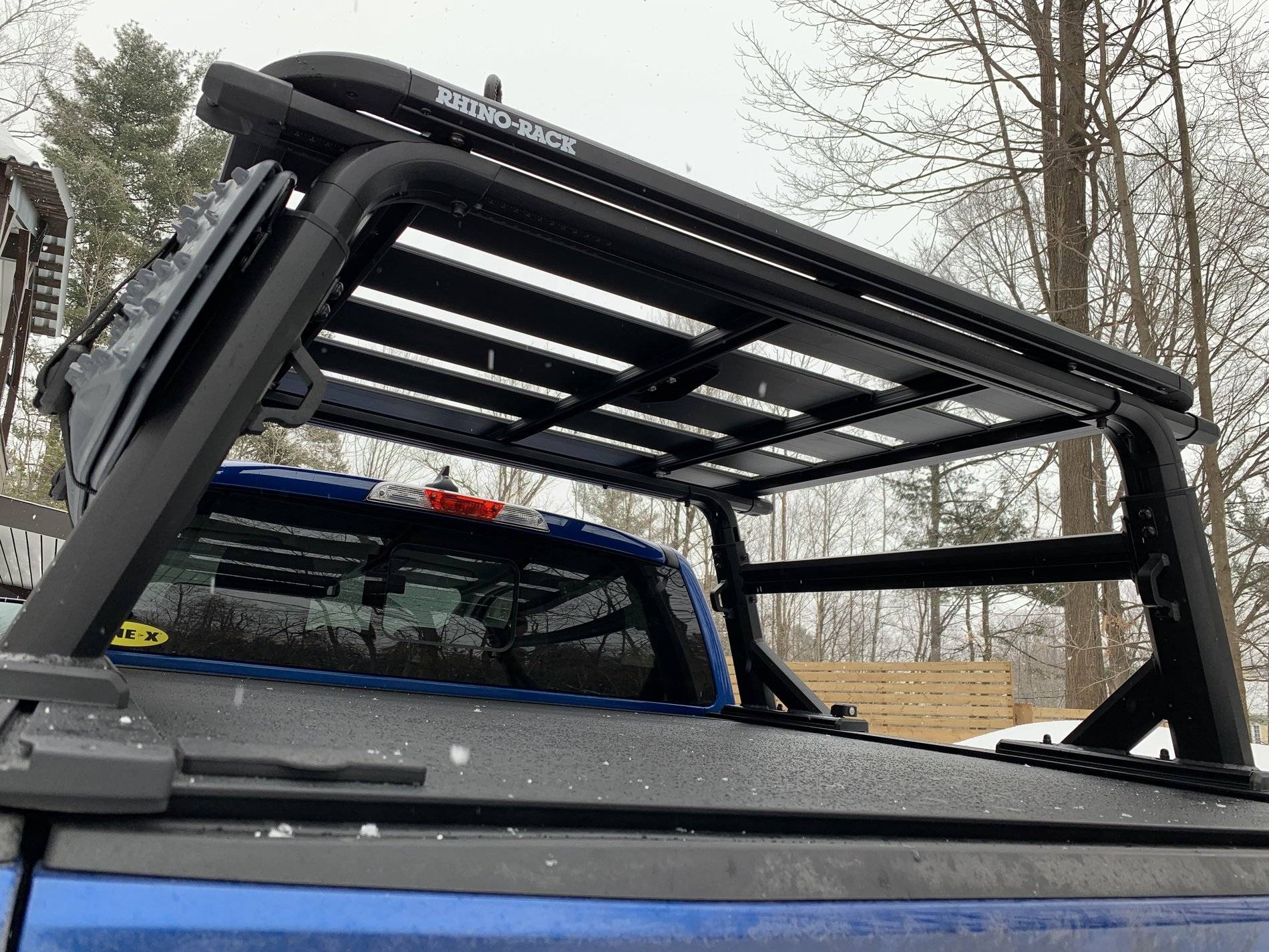

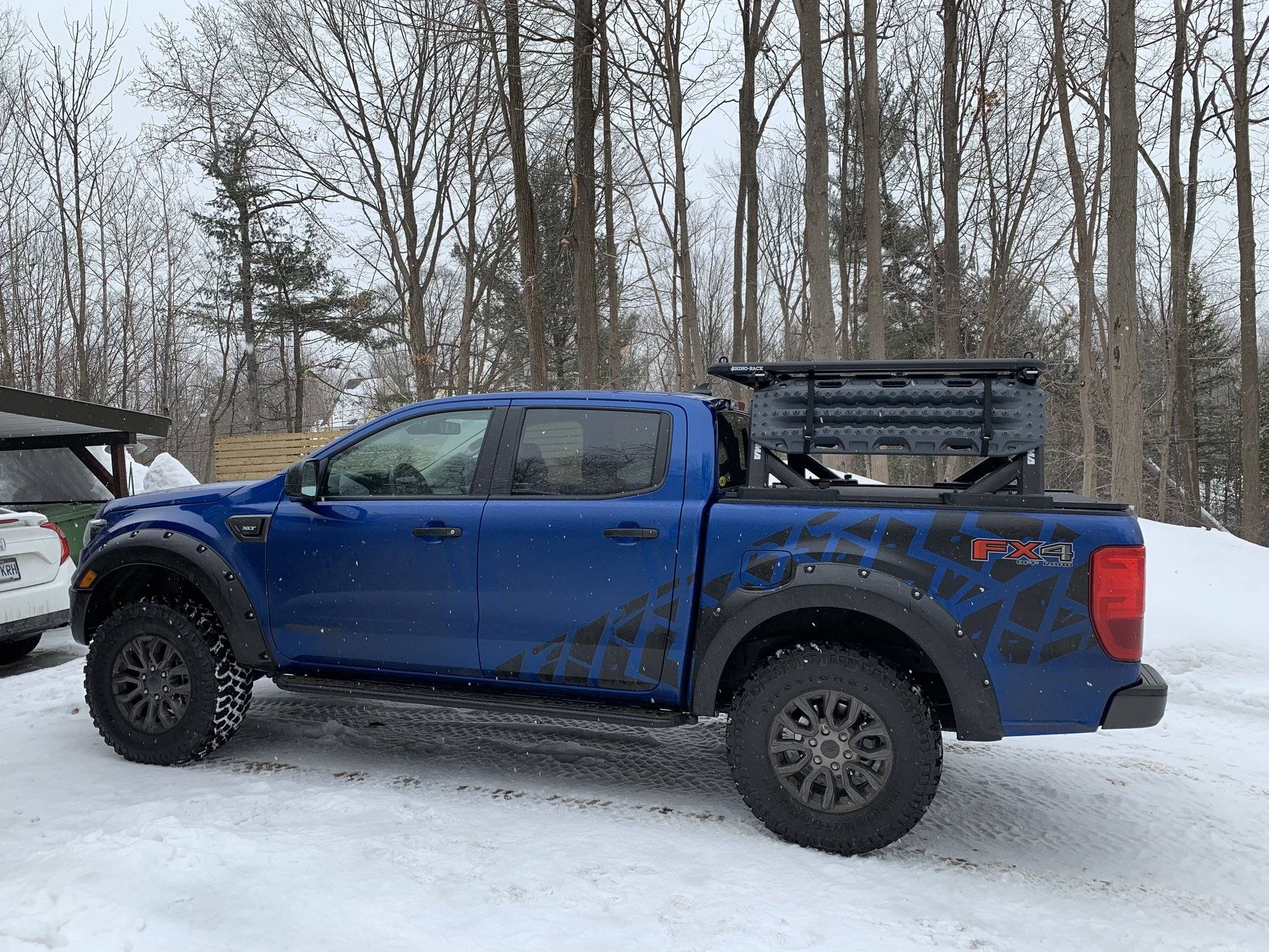

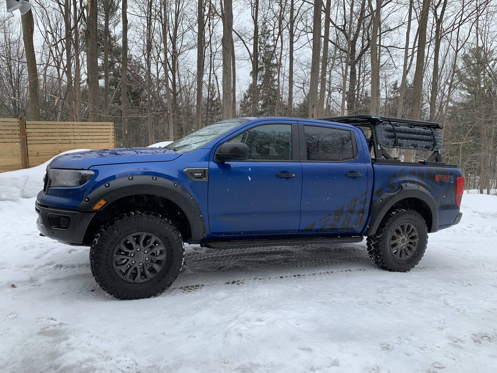

Ok so lets get this out of the way right now: it’s not pretty by any measure!
But hopefully it’ll do the jobs I ask of it. Talking about the rack of course!

A few comments and observations on this rack set-up (will comeback and update regularly as I use it):
I ordered it sight-unseen so there is some little disappointments. The main thing is the load rating drop when paired to the Ford/Retrax cover. Also I was under the impression that the “adjustable” version of this rack started a few inches lower than the cab (about mid rear-window) - a height appropriate to hide a portion of a rooftop tent or when carrying spare tire(s) - and then could be extended a little above the cab for when I needed to carry a kayak or SUP board. That is obviously not the case. The lower setting is right at cab height, not the “look” I was going for! But look is secondary, right? Haha
Build quality seems very high: really nice overall finish, solid looking welds, not so cheap looking adjustment tools. Somewhat easy to reposition on the bed if needed, especially since it’s linked together with side bars and the tray.
Happy I went with the Rhino-Rack tray instead of the Yakima “basket”. I see it as much more versatile. For one thing I won’t need to take it off to install kayak or SUP brackets the way I would’ve needed to with a “basket”. It also gives me much more positioning/attachments options since it’s the equivalent of having 7 roofrack crossbars, all with their own t-slots.
There is also the option of ordering “legs” for the tray and putting it on top of the cab. Something I’m seriously considering if I can get a decent “screw-in” option instead of clamps. If I’m not mistaken the ROW Rangers have pre-drilled rooftop hardware under the weather strip for such a set-up because you can order roof-rails on certain models.
