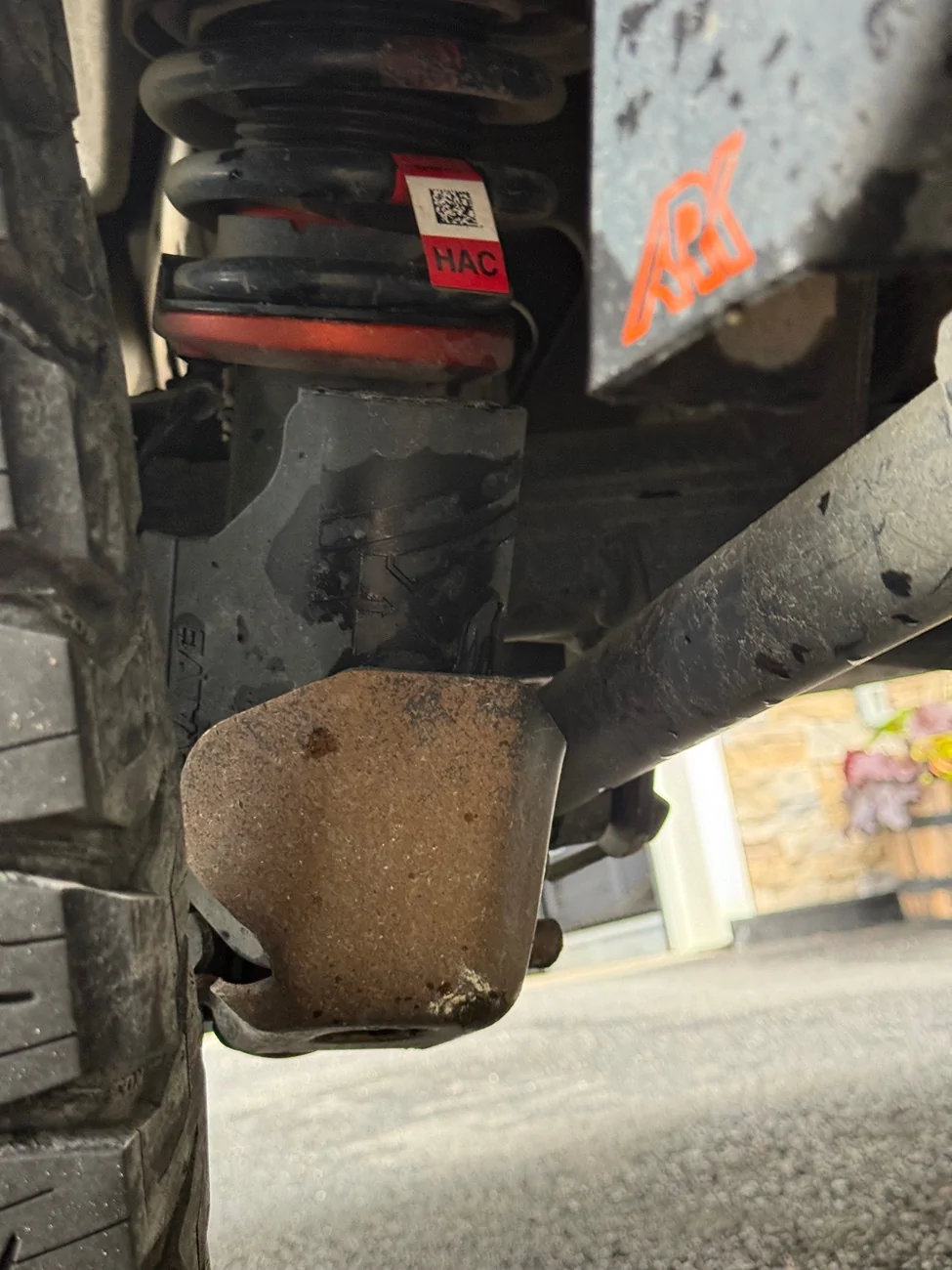

Regarding high speed stuff, I got some rear travel position sensor guards from Ark and installed them earlier this summer.
https://arksplashguards.com/product...MYbI7t2SLXehG77RYYtPCYguWL_E02Wi1mGl-NFTrvo2v
I saw some metal options for like $250, but I don’t foresee smashing them into anything (maybe I’m ignorant on that)? But I did foresee them getting pelted with road debris on high speed dirt road sections or the odd high speed trail. These are some sort of durable plastic so I was interested to see if the cheap route would pay off. Took them out to a dry river bed in the area (normally the land of side by sides and drunk people on a nice weekend), went downstream far from the crowds and let the truck go in Baja mode. I’ve had the Tacoma out here tons of times with the family (the kiddos like to play next to the river) but I don’t think I’ve ever driven above 25mph. The rocks always made the suspension feel “loose” even though it wasn’t. Well, the RR had no such issues. 70mph (without the kids haha) was cake. Took the random whoops with ease. I even accidentally hit a 3 foot deep angled rut that I didn’t see coming, hitting the up sloping back side at 50mph… the truck basically laughed it off. My buddy and I were in disbelief that it handled it so well.

Thanks for the heads up on the sensor guards. I actually like the plastic guards better since the ONLY instance I have ever seen of the sensors getting debris was a tree branch that got caught in one of the wires and unplugged the sensor, throwing the whole vehcile into fail safe mode. Never seen anyone damage them otherwise during use. People have broken them when doing lifts by not disconnecting them first when taking off the shocks, but beyond that user error issue, the tree branch was the only actual in use incident ive seen.

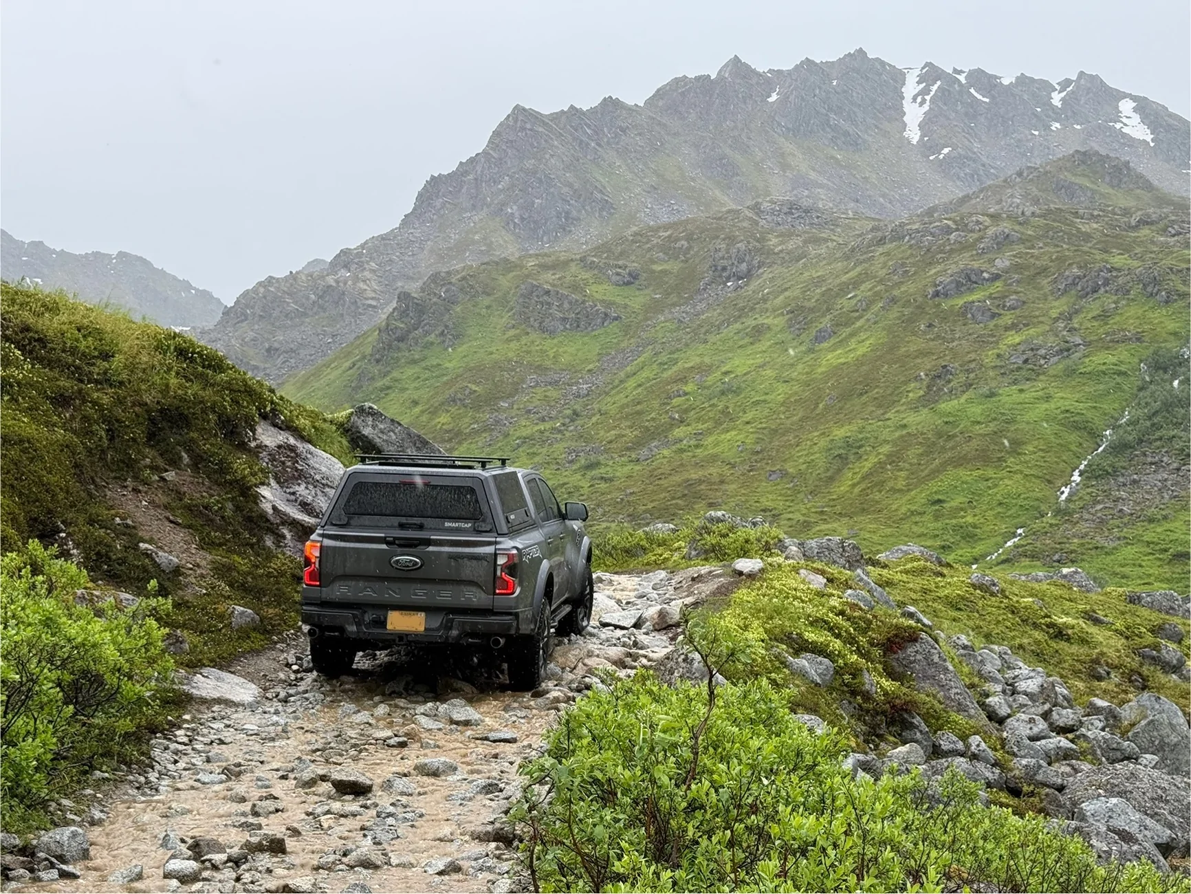

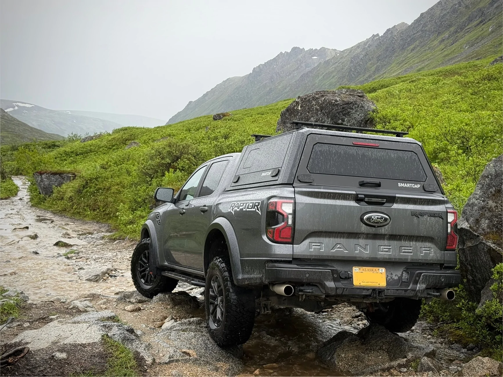

Just did a first real test in more technical rocks. Nothing crazy, but high likelihood of kissing skids.
On a super rainy day we did 10 miles total yes trail to see how the truck did. Messed around with the drive modes, it was fun seeing how little you need 4LO in a vehicle with this much power compared to my other vehicles. Baja mode was fun for a few minutes but the trail was too tight. Off-road with no diff locked was the way to go. I used rock crawl mode twice, but only when I got spotted on some harder stuff. Otherwise the nice low crawl ratio is a little jerky. Used the rear locker one time because all the rocks were slick from the pouring rain. I didn’t take any pictures during the harder parts (or really during any part) because of the weather. Sorry I don’t have anything really cool to share!

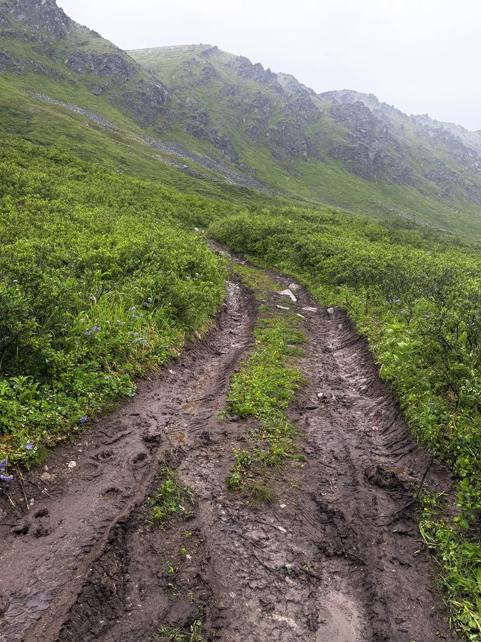

Did a steep side trail that was mud instead of wet rock just to see how the lockers did. Fun to see how fast they engage and disengage compared to my Tacoma (or Xterra back in the day). All-terrain tires were the limiting factor though and I had to back down creatively.

Overall I was impressed with the ride quality. The suspension really minimized head toss and was well damped when getting jostled around. The width is a little bit of a factor, and the very built rear suspension is the biggest factor.

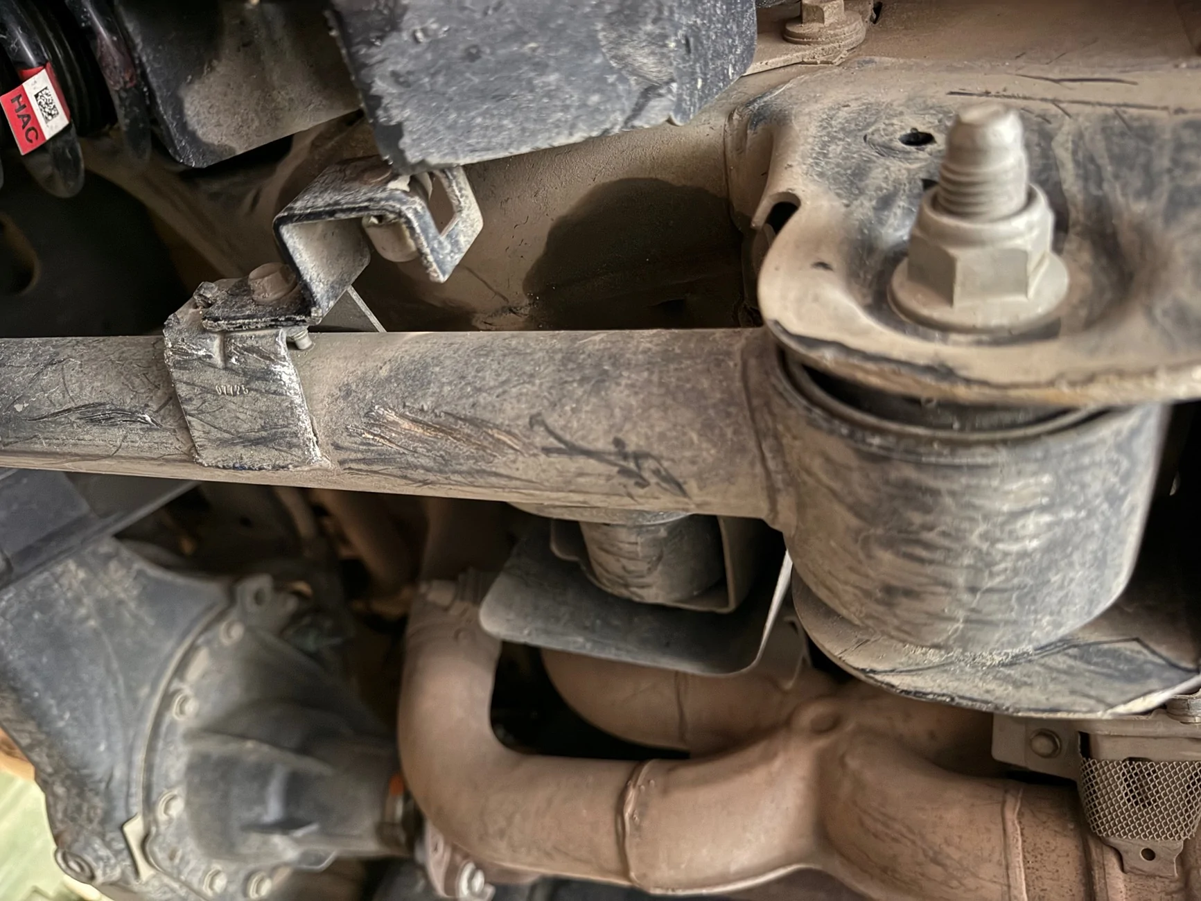

The trailing arms and trailing arm mounts were my biggest learning curve. Definitely whacked my right one pretty good which caused me to lose th plastic cover, and gave a minor dent to both the trailing arm mount location and the trailing arm itself. That same rock also gave a little hit to my rock slider when I slid a little bit.

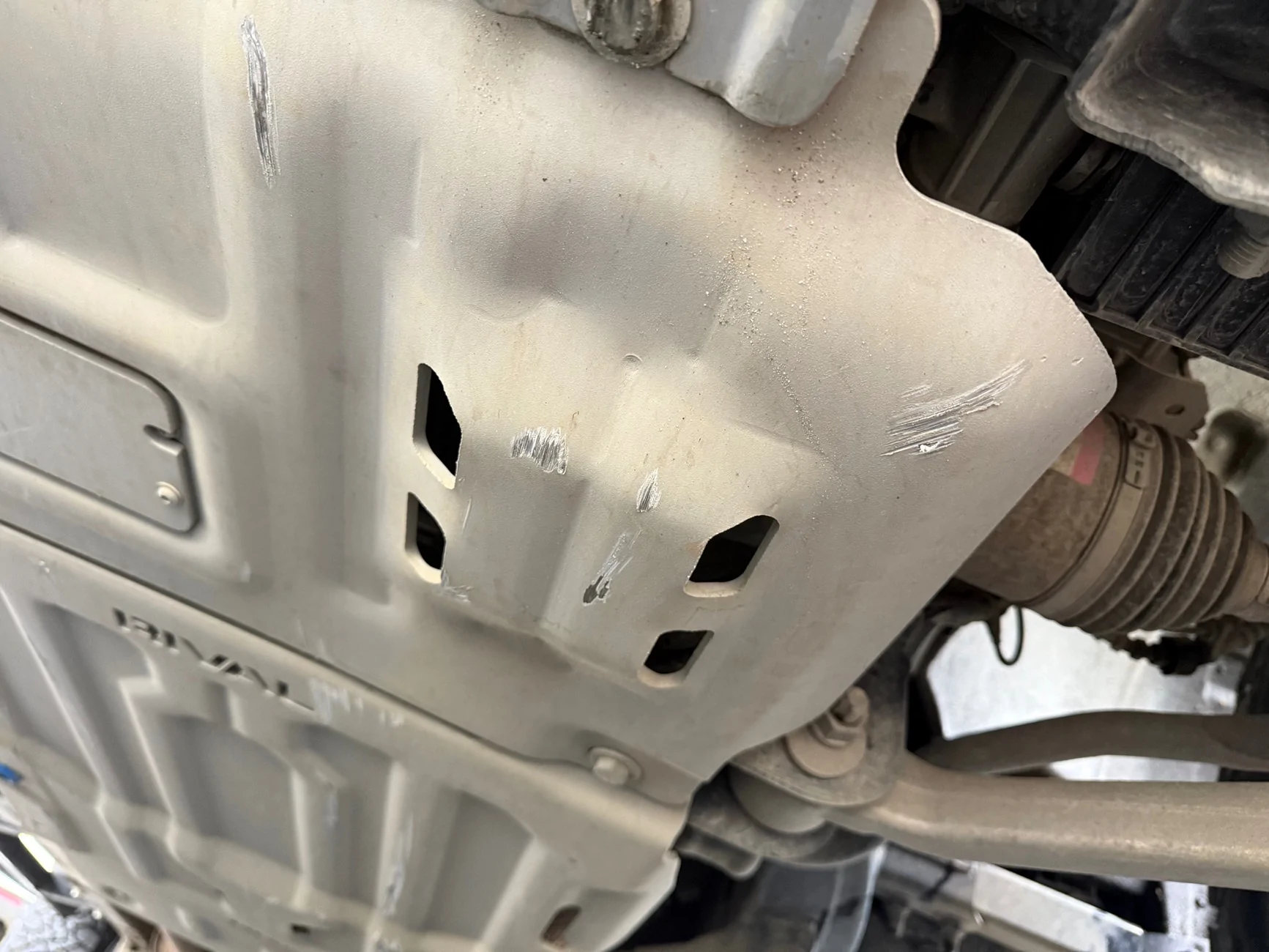

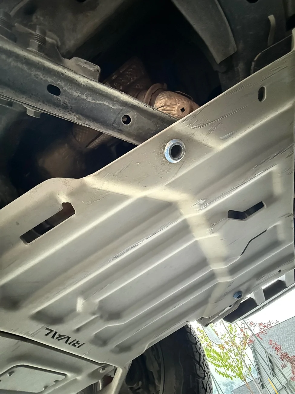

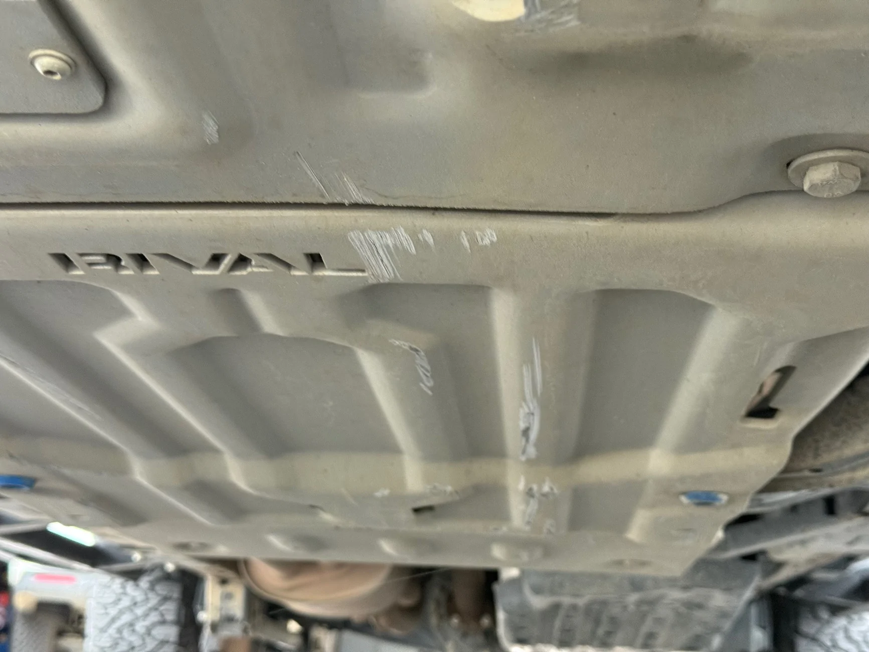

The aluminum skids slid pretty good, but the rocks were all wet today. And they actually hit stuff less than I thought they would.

Looks like a lot of offroad fun!
Are these the 6mm or 4mm Rival aluminum skid plates?
Tuna
Dec 14, 2025
38
Germany
Ranger Raptor (EU)
Aeronautical Engineer
Your gearbox skid plate seems to have an upgraded design with more beads and different outlets/vents.
This version does not seem to be available (yet) at European Rival stores...

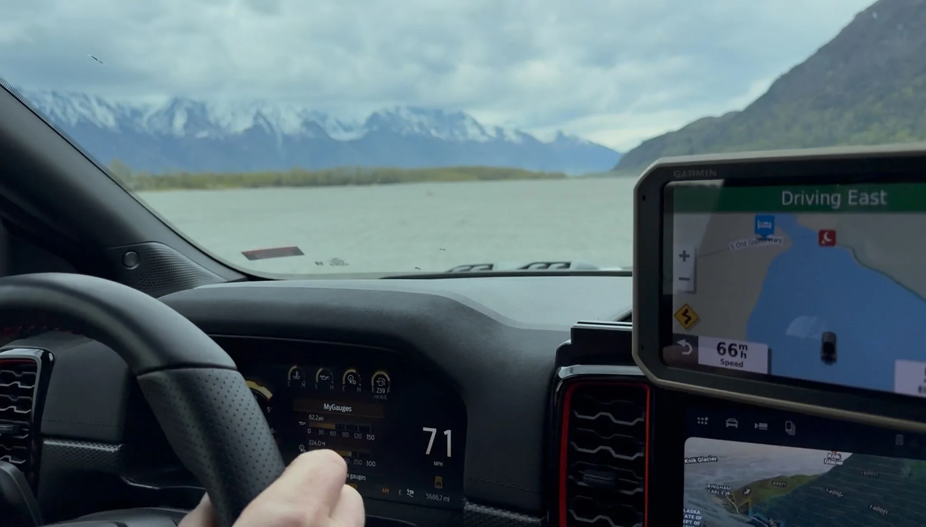

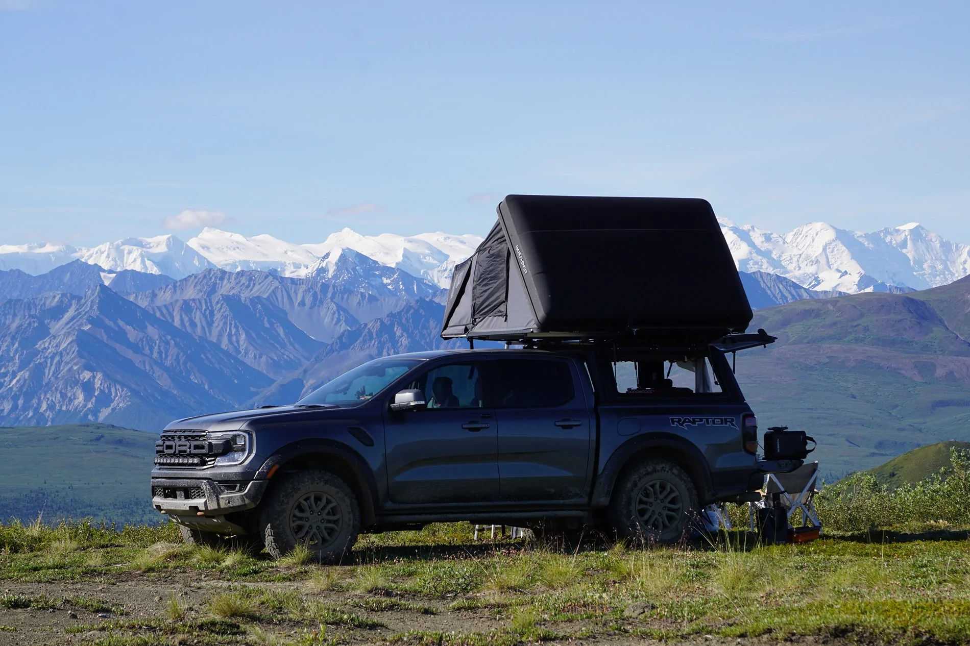

Did 600 miles last weekend, 115 miles or so of which was dirt. Some trails but nothing requiring more than 4 high. Truck does great as a long distance remote travel vehicle. Got about 17 mpg with a tent on the roof (the same as I got doing 3000 miles to Hyder AK and back). Can even open it up on less technical dirt even when fully loaded. Still surprised by how well the sumosprings coil helpers help in the rear.
