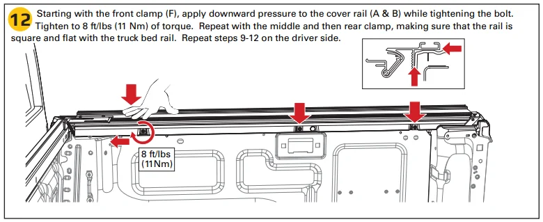

We haven't tested this combo specifically, but if you look at this image below, you can see where the clamps line up. They're fairly flush with the bottom of the bed rail, so it really shouldn't be an issue for the RealTruck BAK Revolver X4 TS Hard Roll-Up Tonneau Cover w/ T-Slot Rails to install with the factory cargo management system.

The problem I ran into was the bracket at the front of the cargo bed that holds in the front of the rail occupies the same bolt holes as the bracket for the cargo management rail, but that once I'd figured that out, it was no problem to loosen the bolts, mount the tonneau on top, and retighten the bolts.
In retrospect it wasn't that big of a deal but there was a lot of swearing at the time.
