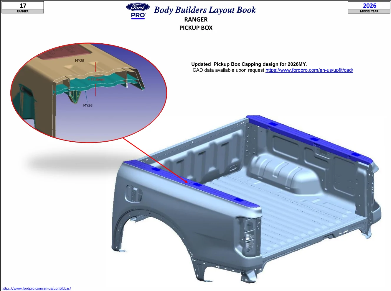

PSA: Bed rail caps on '26 are thinner than '25... Tonneau covers will NOT fit

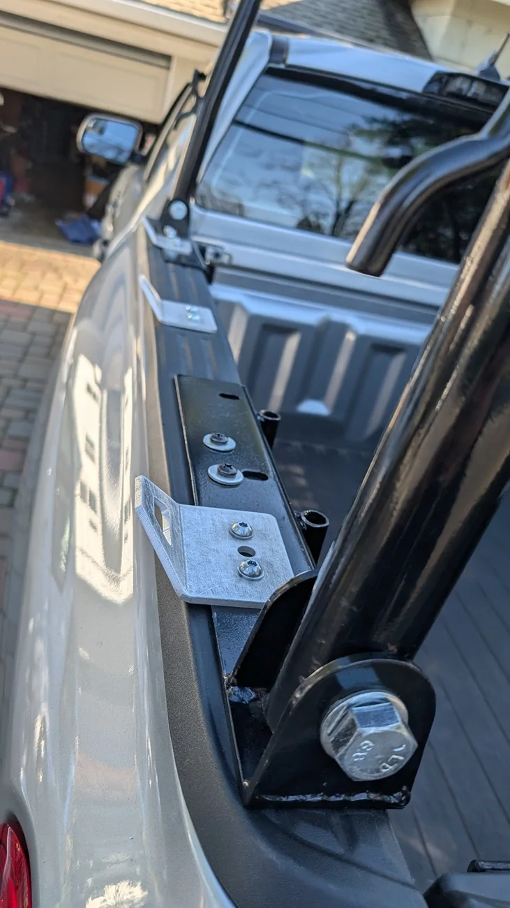

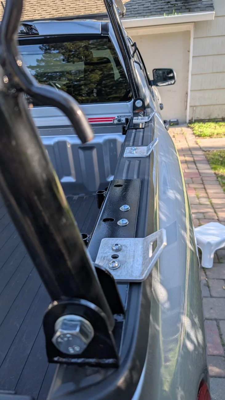

Removing the second right side cap caused a single clip to shear off but was able to massage the rest back into a semblance of shape to refit. Had to scribe the nut boss locations, 9 per side. Thanks to AAL for the hardware to get this done

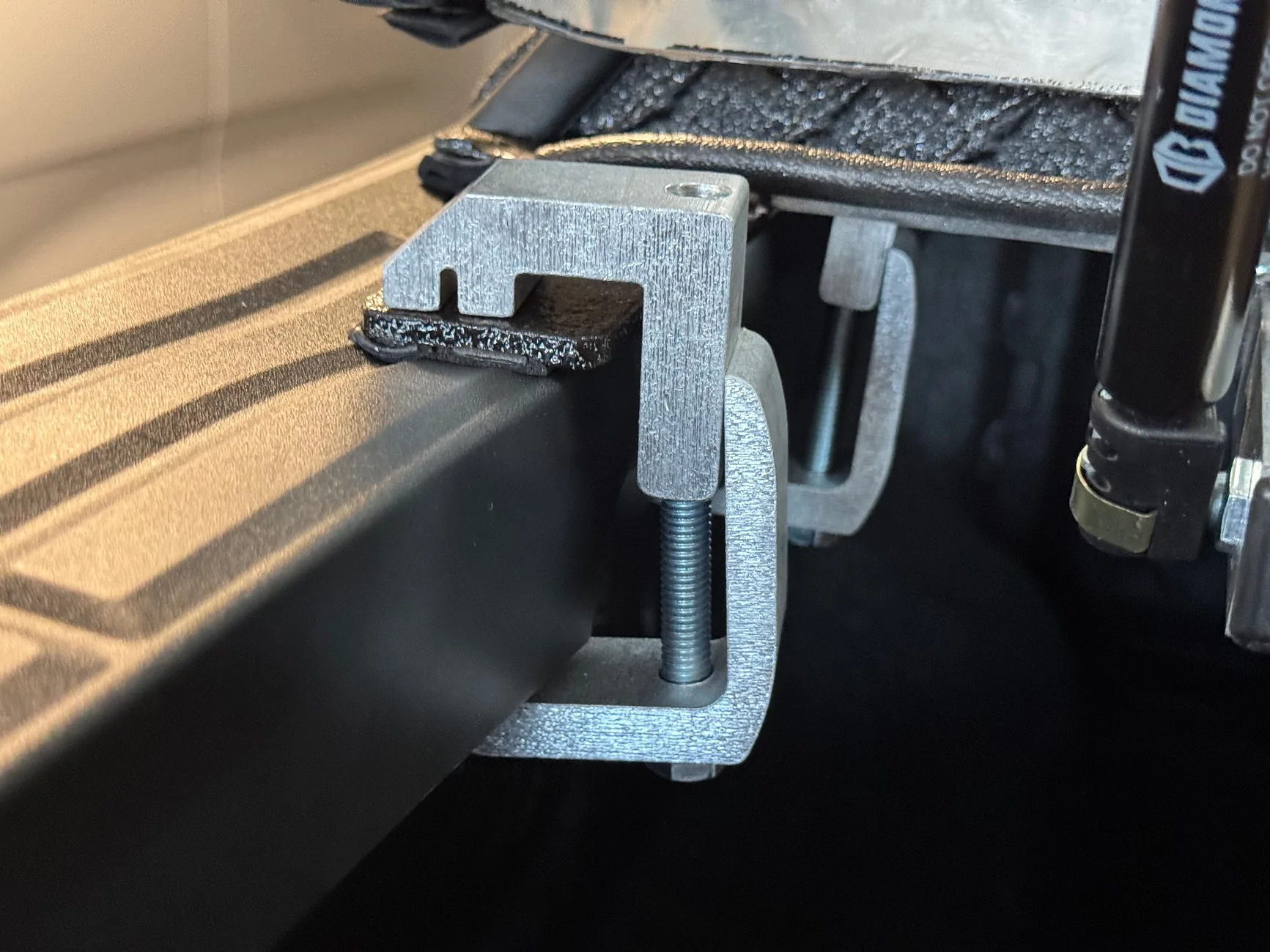

I know one thing.
‘The new thinner design won‘t be near as prone to deforming when using clamps on them.
Like the bed cover clamps are doing to my 25 model.

I know one thing.
Said deformation is substantial from my experience and permanent in regards to the "ribbed" inner structure of cap as shared previously in photos

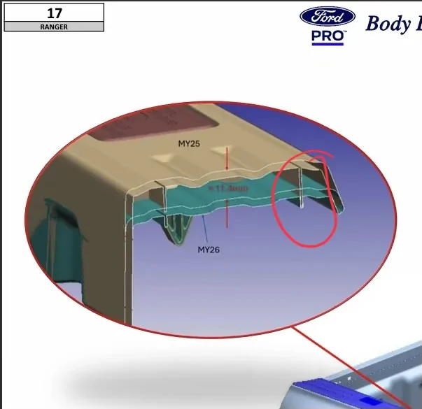

I think it will be better but it looks to me like even on the 2026 if you clamp it like was shown above this plastic will deform.
it is still supported by those very thin plastic fins in the middle.

i figured those were still not load bearing

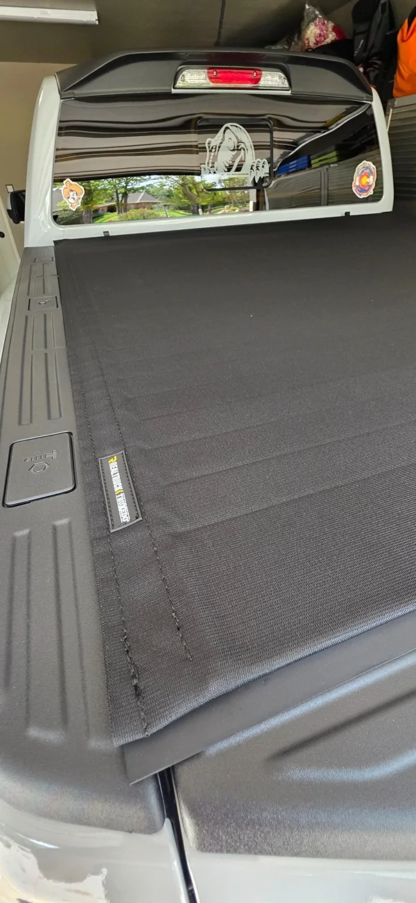

I contacted Agri-cover about this issue and sent them a link to this thread. I plan to order a Lomax when my 2026 Ranger XLT arrives in April.
The Lomax (from Agri-Cover) has now been modified to work with the 2026 Ranger. I received mine today and the installation looks like it should go smoothly.

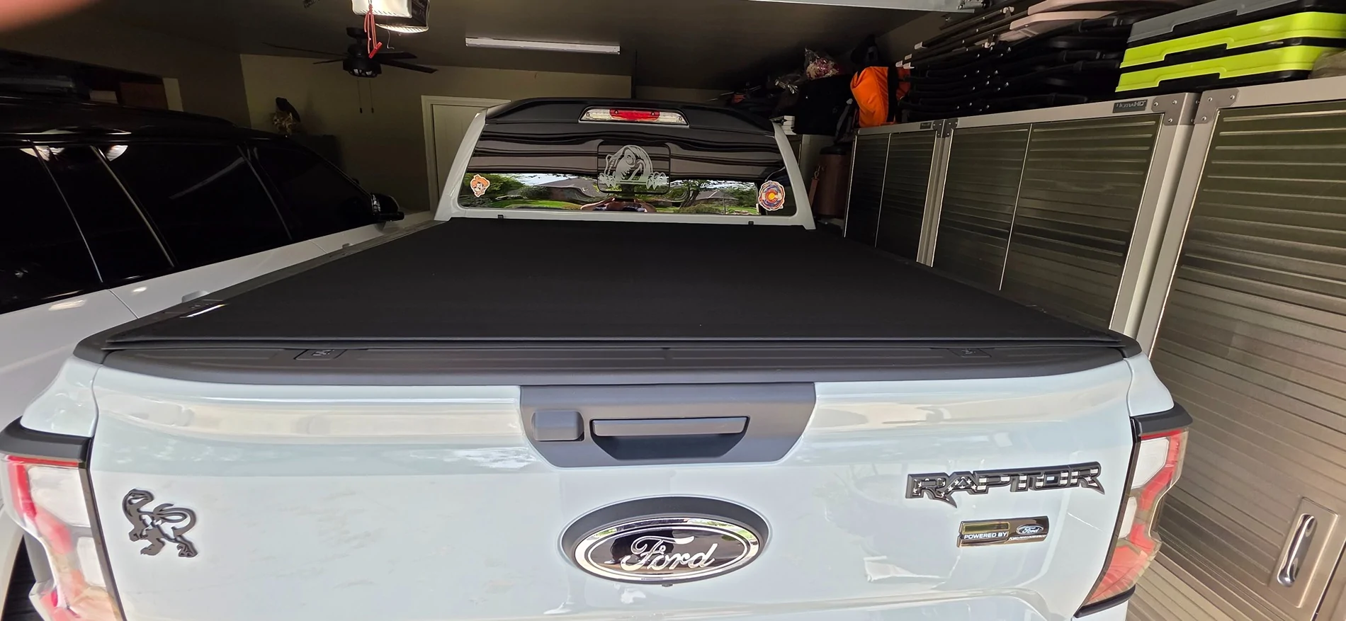

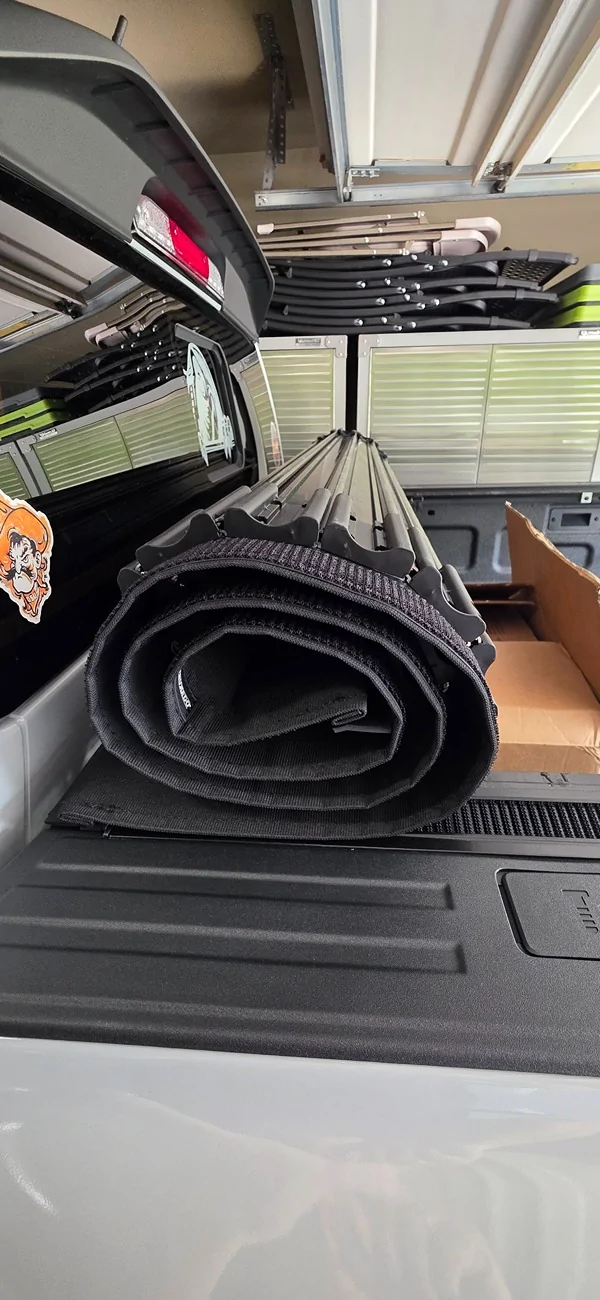

Sentry ct ordered through rep on our forum
Received in 3 days. Installed easily, fits like a champ works even better. 2026 ranger raptor.
