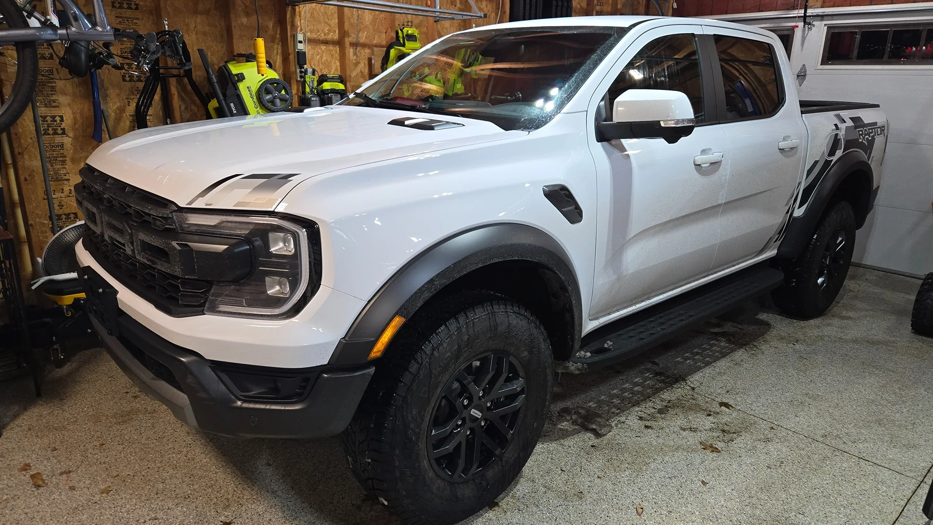

Here's the procal kit.
I ordered it right after a bought the truck in November.

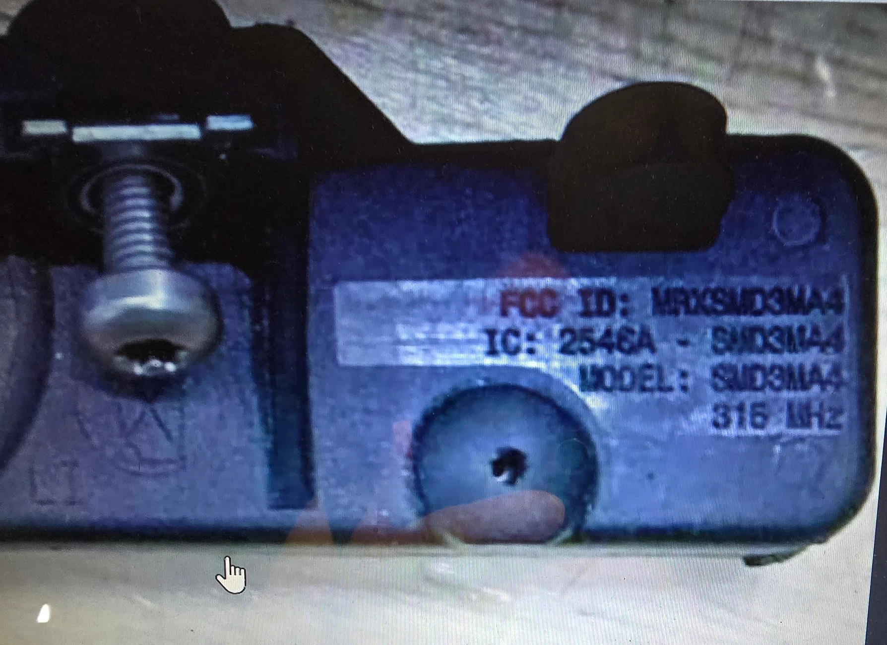

Here's what they look like
Ford Ranger TPMS fault after new wheels & FP tune installed 20251206_175454

Update on this if anyone cares, the TPMS sensor frequency with FORD sensors from pre-2025 are incompatible with my truck. Supposedly the ones I need are on back order with the dealership. I am kind of in doubt but I'll see if they actually do show up and try to replace them.

That's the Word! :LOL: Changed from the old 315 to the 433Mhz sometime during the 2024 to 2025 period. Usually printed some where on the tire sensor so makes no sense why tire shops or everyone doesn't check them it seems. . You cannot change the frequency of the tpms module that I'm aware of but can buy dual Mhz sensors for tire swaps. Some OBD readers/tools can identify the sensors frequency thats on the vehicle! :thumbsup:
